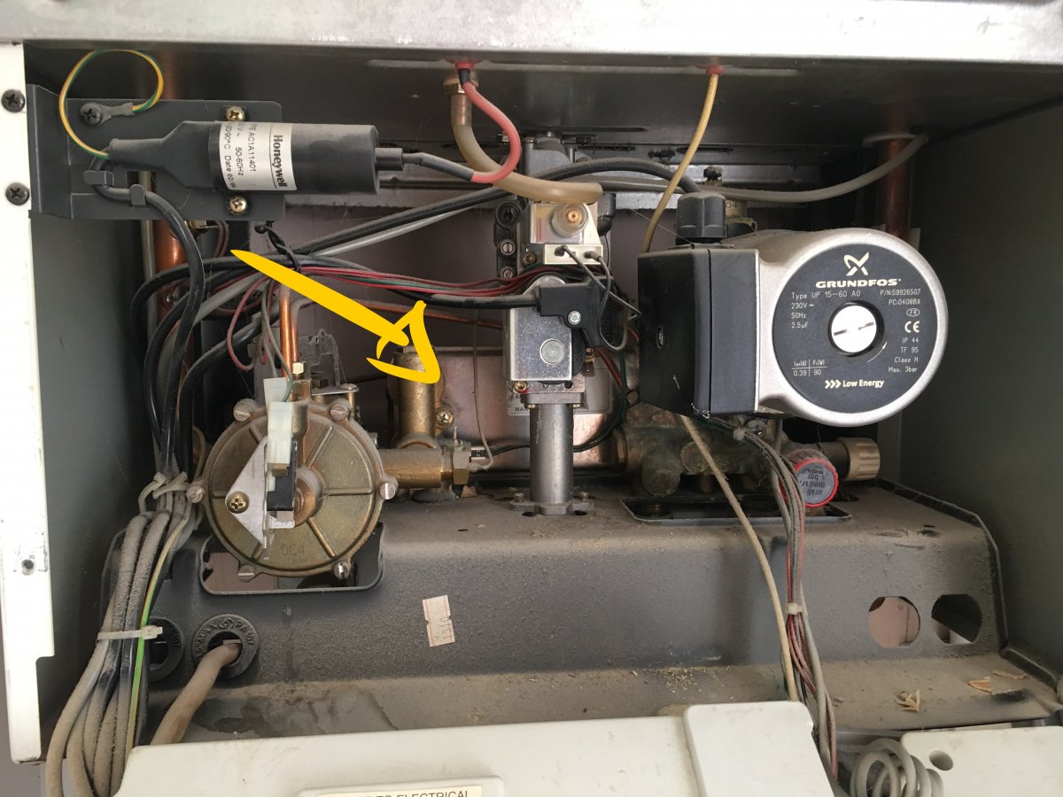

Hi all
I have the same issue as the OP, hot water for a short while and then cold and so on.
I purchased a new DHW and seals but how the hell do get to it? It's at the back behind everything?
Also sorry to resurrect this old post but it is exactly what my issue is and I'm hoping all the helpful people that got involved can help me too!!
you need to start your own post , dont hijack an existing one you wont get the correct replies
