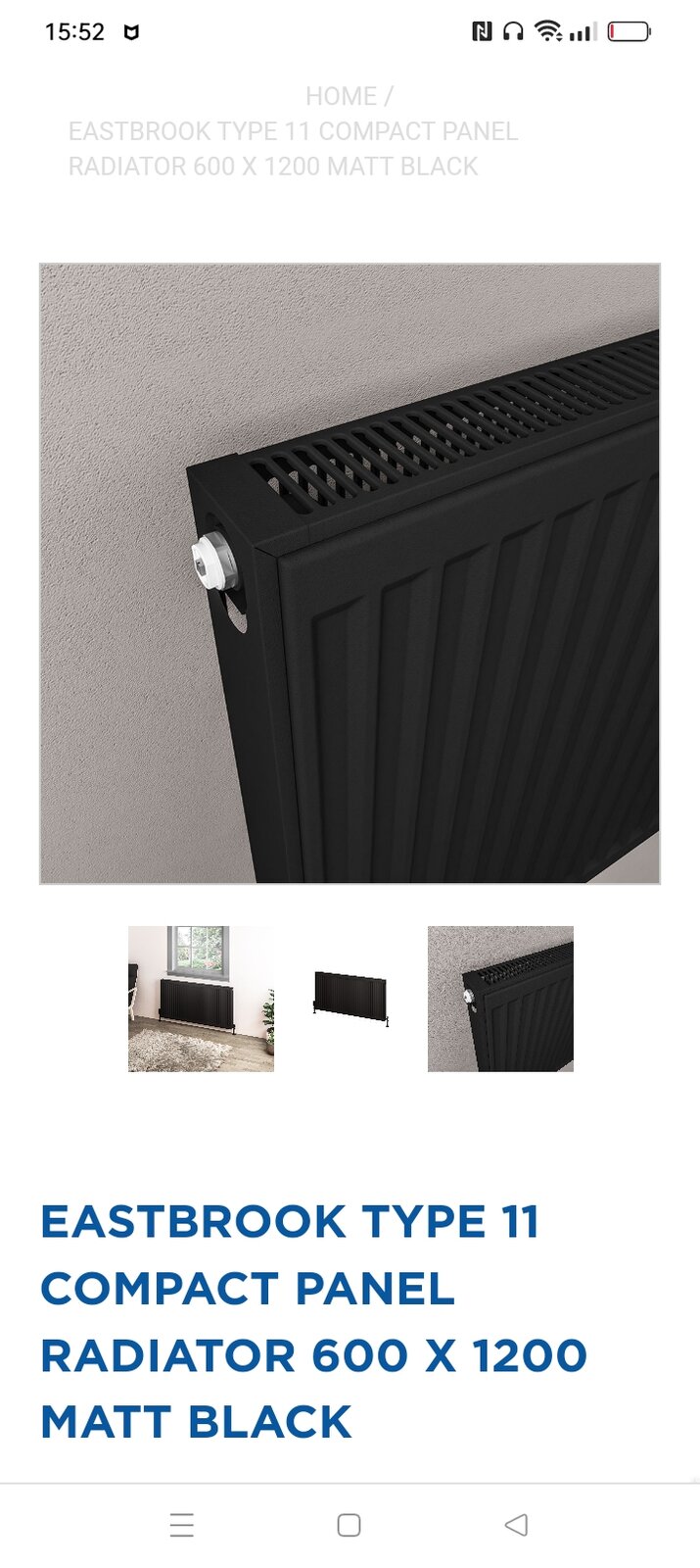

They look like this. They do them in 1000 and 1200. I need an 1100 as this is what is in and I can't alter pipes can't get under the floor is tiled no access

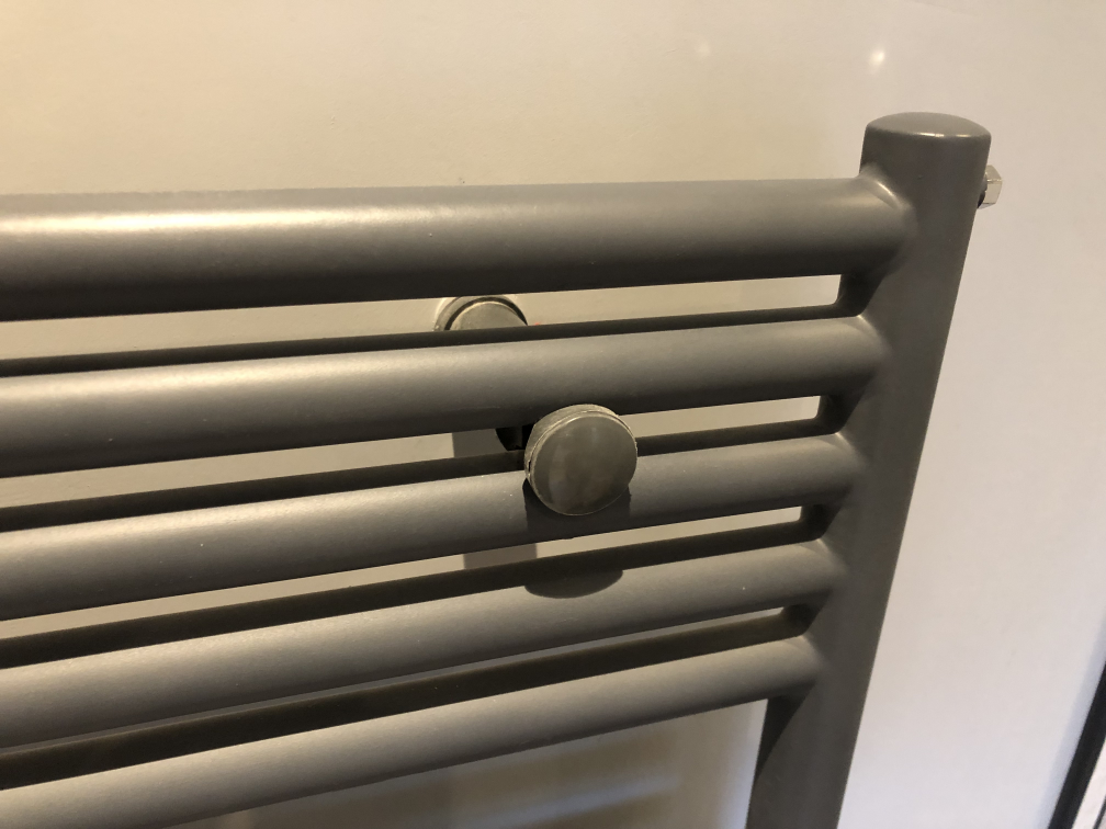

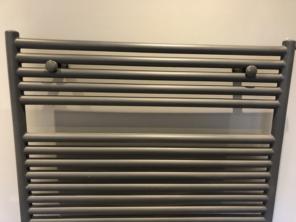

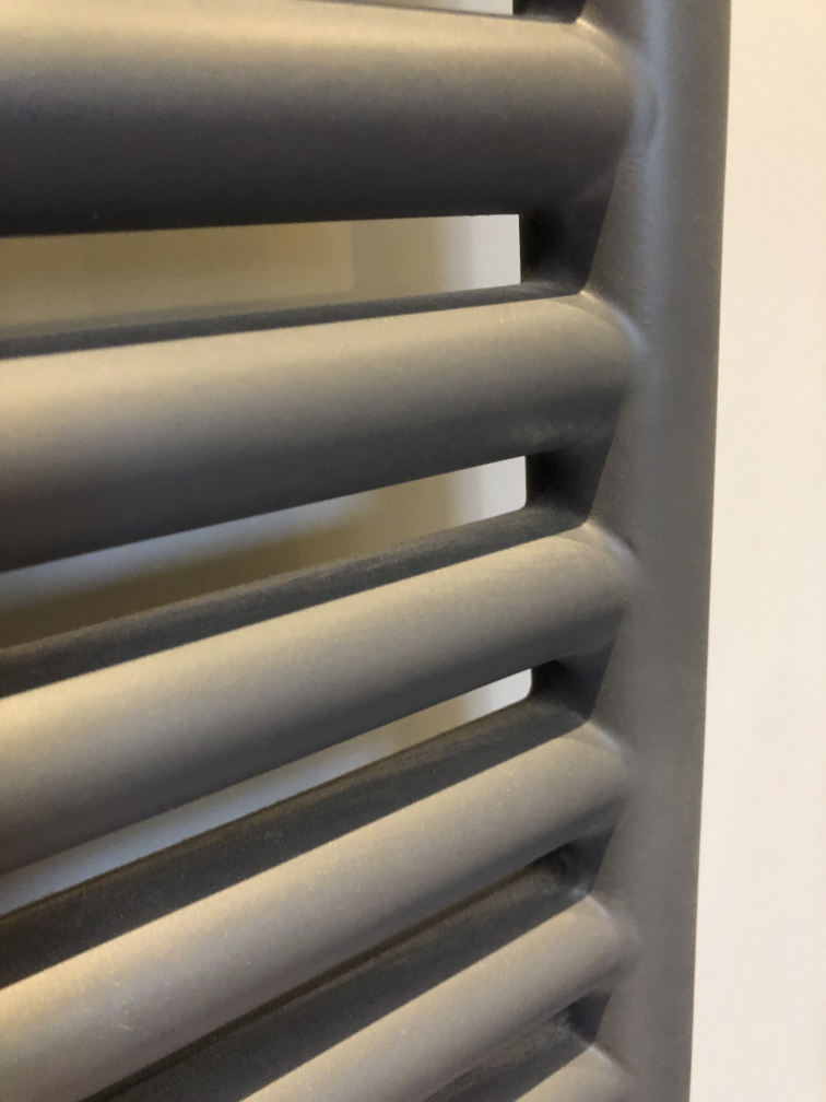

No but I have sprayed a few. Changed both my bathroom tall myson towel rads from white - one to black and one to anthracite.
Recoated 2 white rads too.
Hung them on wires from the garage rafters. I found the trick was get them well prepped with scotch brite and then really clean then - 3 full coats of etching primer, 3 full coats of paint and then 3 coats of matt lacquer (satin on the white rads) and let each coat dry well. Couldn't be happier with the result.
This is the anthracite one - again used to be gloss white

Yes a Matt black one. They should be able to get a similar finish you'd think?
I would certainly think so ... I'm sure someone with more experience of powder coating will advise but I believe they can create any finish needed but it does come at a price for bespoke one off's usually.

Why have you got your heart set on powder coat? If the radiator you want is already painted, you’re better off wet spraying it.
Edit: looking at the panel radiator shown in your photo, you won't get a decent finish from powder coat.
