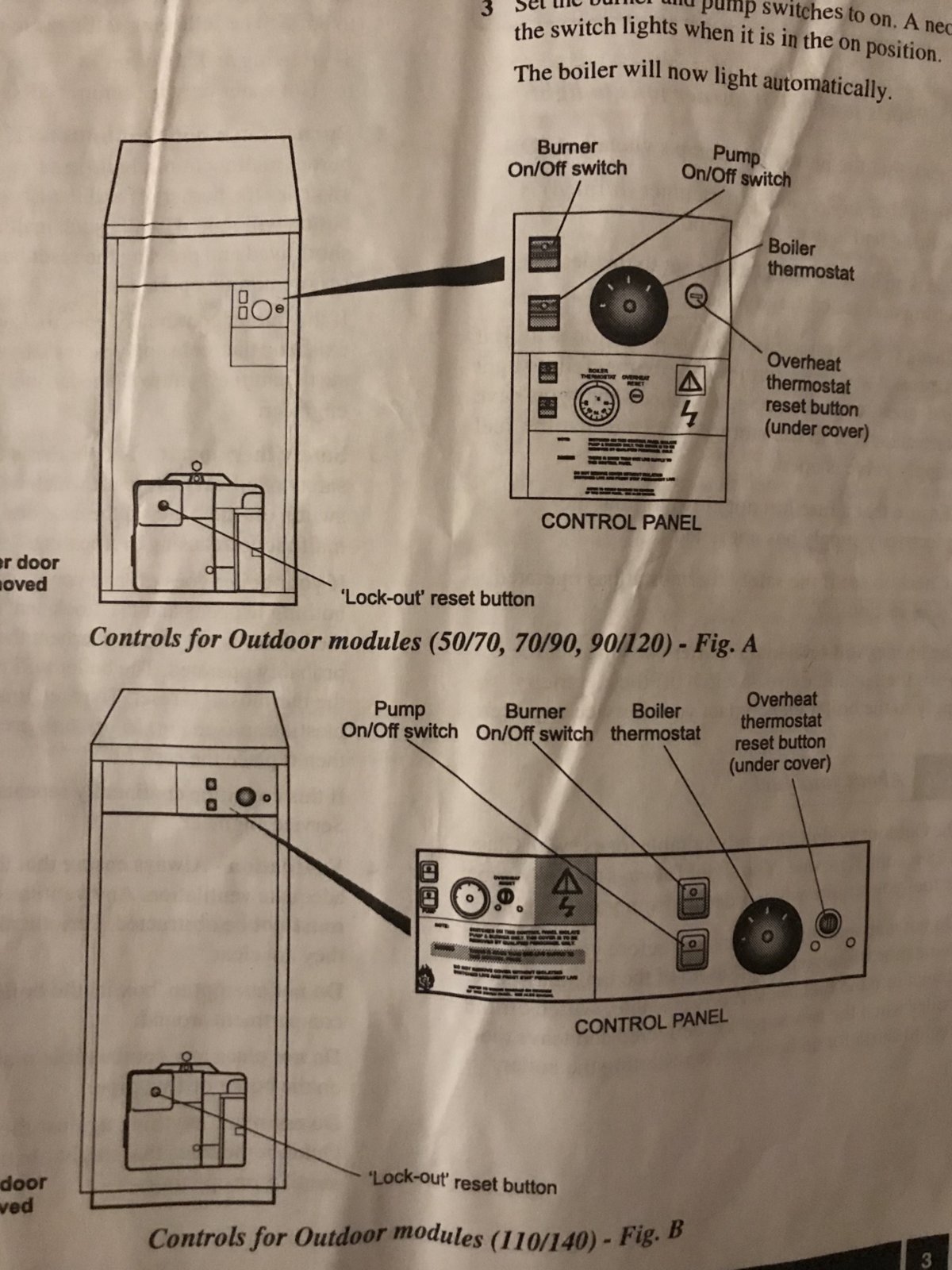

Not convinced that any part of the UK has had freezing weather yet this winter, but understand that you may be a bit chilly without heating.
It appears you have an oil fired boiler.
Was it burning when the power went out? If so it could have overheated. Look in the boiler manual and try to locate the 'overheat thermostat' or similar title. It may need this resetting by pressing a button.

It's depicted on the instructions that OP uploaded. Try pressing that.

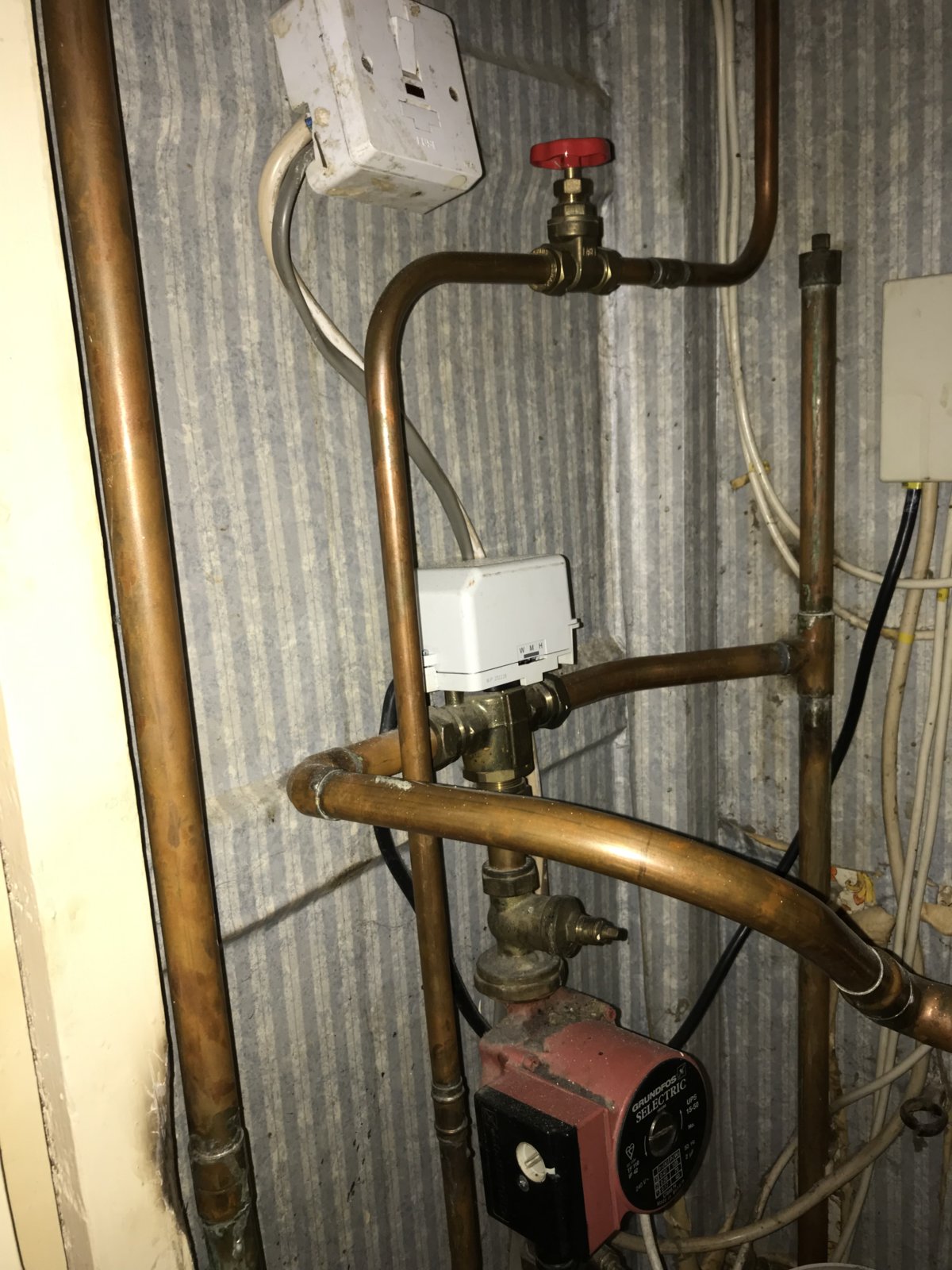

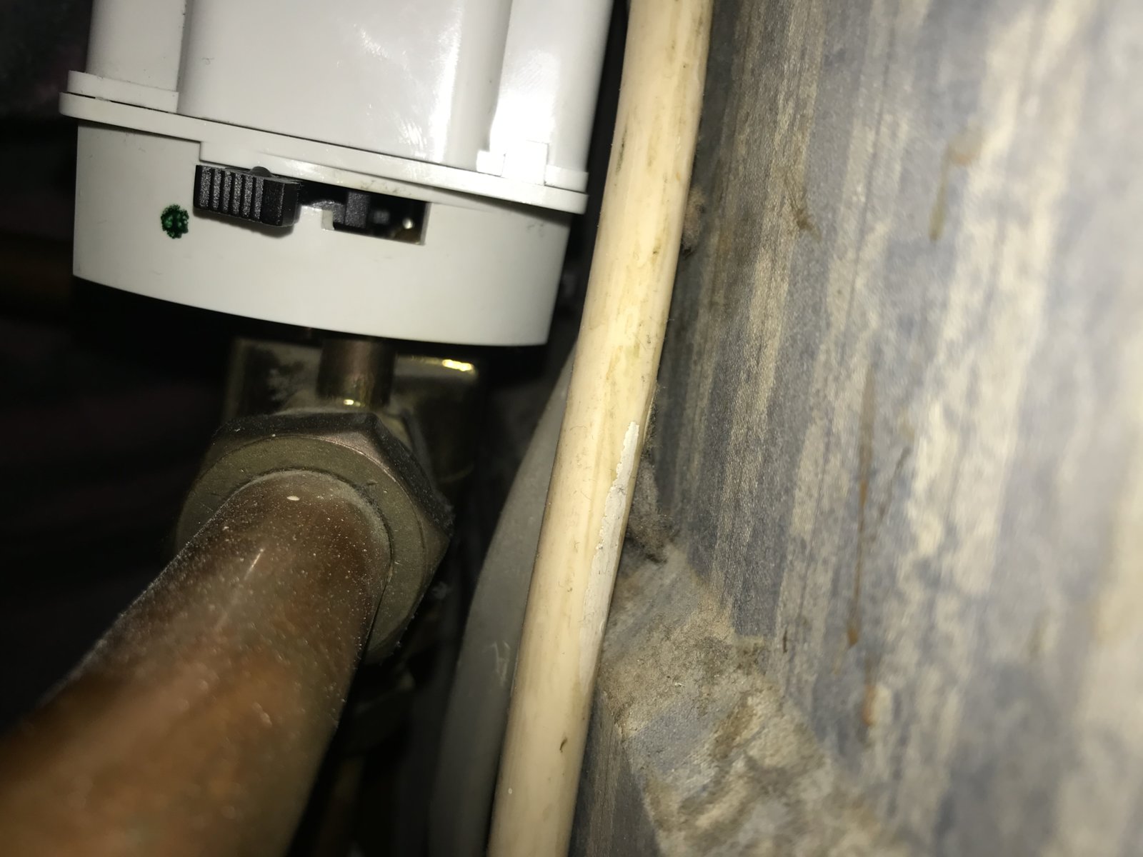

Hot water function is working fine. I could hear water going into the cylinder. But nothing happens after I turned on the heating. The time setting is correct after the power cut. So this should have something to do with the valve..?

if you have manually opened the valve as shown in that vid, you have not found or fixed the fault.
Yeah the valve is probably broken. We’re aware that it needs to be replaced by an engineer eventually.
