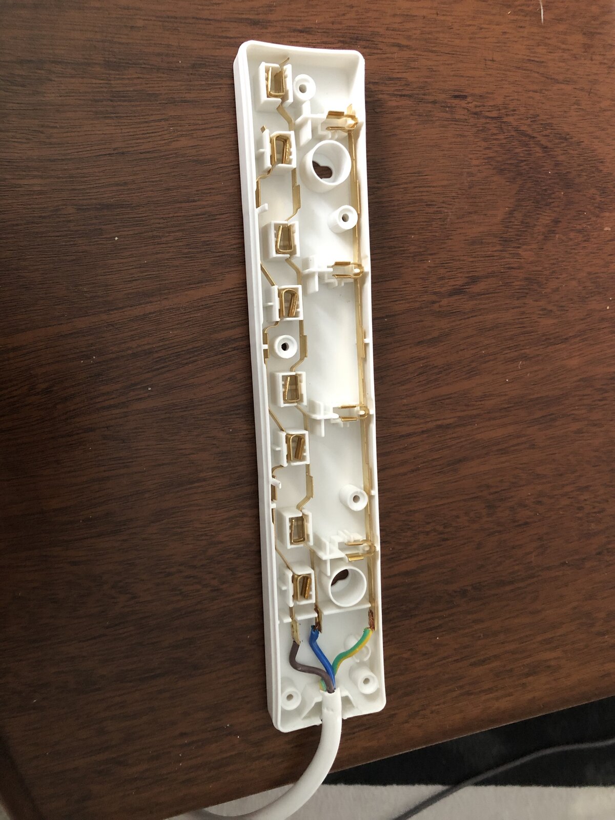

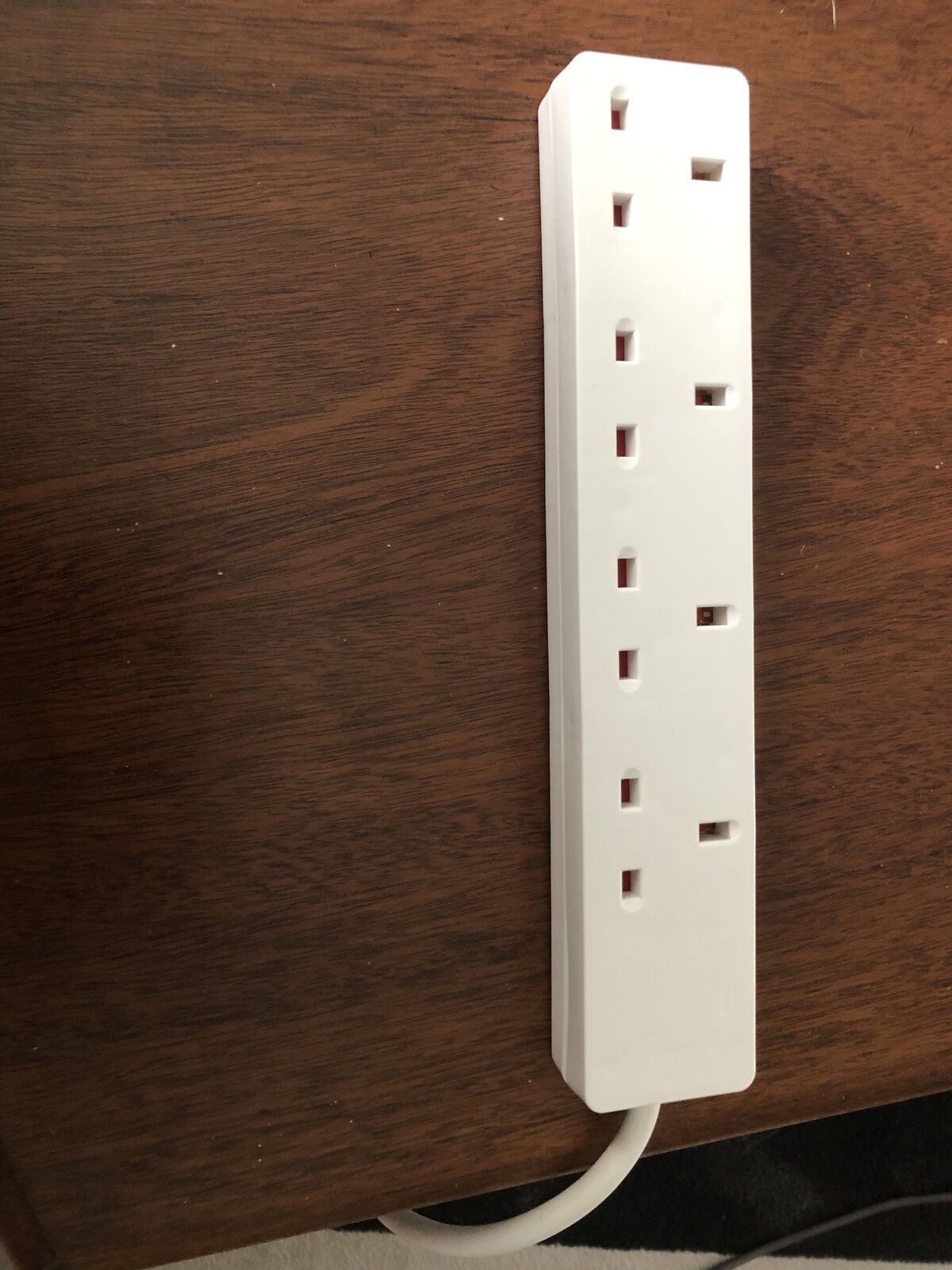

Okay, so let me try and word it as best as I can with pictures.
I have a 4 way extension cable of 1m coming out of the extension block of sockets via the right side.
I need the cable to come out of the left side, why? Limited space where this will be mounted, it can’t go upside down as the plugs that will go into it won’t.
It’s just normal screws that came out of the extension cable, so it was easy to take apart.
Why not buy a new one? Well, money and e-waste.
So, I plan to unsolder the right hand side as looking at it, to the left. I have everything I need to do this and test. Just need someone to confirm the circuit is still being complete here. I am 99.9% sure

The casing has a space at the right hand side for the cable, connectors and cord grip.
It has no space at the left hand side
But you are obviously determined to carry on.
Goodbye.
He says the cable is too long.
He could easily run it under the strip from one side to the other.
Those internal connections are spot welded, not soldered.
Yeah, just noticed that myself…
Goodbye.
Hey, I listen… lol nah all honesty as it’s spot welded on I am going to try and reroute the cable.
Why not spin the 4 way through 180°?
or
buy another style.

She has also told me to thread the wire through either trunking or carefully via the extension box if there is room.
She is already ahead of me, look what she got from the shed for me.
