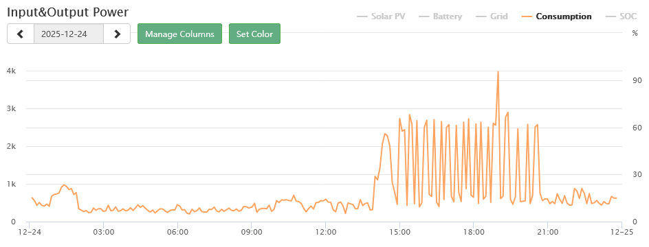

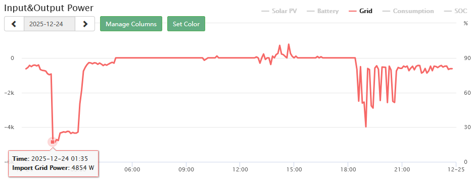

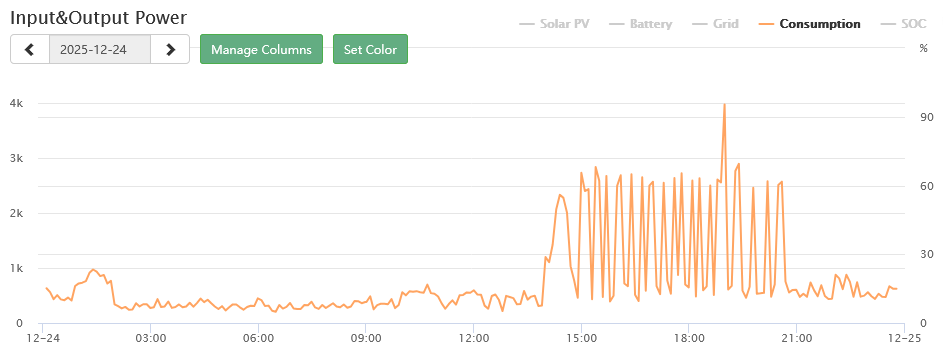

Other than the showers, 60 amps would be ample, if I wanted a 100 amp supply I would need a 100 amp MCB or fuse feeding the consumer unit, as also have a 5 kW inverter, giving me an extra 22 amp.
I rewired the central heating, and the local heating guy admitted he could not have done it, at least he was honest, and the electrics were the least of my worries. I have wondered how long it would take to get a fuse replaced, with the same size, today unusual as cooking turkey crown, 1766620388123.png but even then 4 kW peak. Grid, a bit different as it shows charging battery 1766620596695.pngbut again well within 13.8kW (60A) I can see EV charging over night could be a problem, but until we get an EV can't see a problem.
