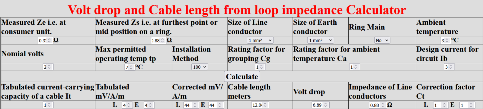

There are charts which show cable type, insulation method and the maximum current, many years ago using java script I made a calculator and have used it a lot to see max I can go to, now there are on line tools to do the same so in this example.
I have looked at 1mm² with a 13 amp fuse to just within the volt drop allowed for lights, and I have shown 12 meters is the max length from the consumer unit.
