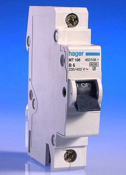

The "RCD" in the house - does it have a test button? Or is it really an MCB?
MCB:
RCD:
