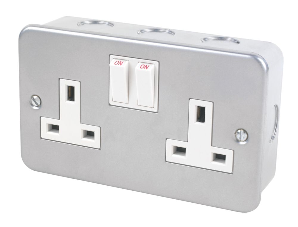

The armoured cable would need to be terminated in a proper gland. This gland would need to go into a box before it went to your multi socket extension.
Your better course would be to run the gland directly into one of these
ae235
They are less than a fiver each at Screwyfix.
Then plug your extension socket in to it, if you need more outlets.
