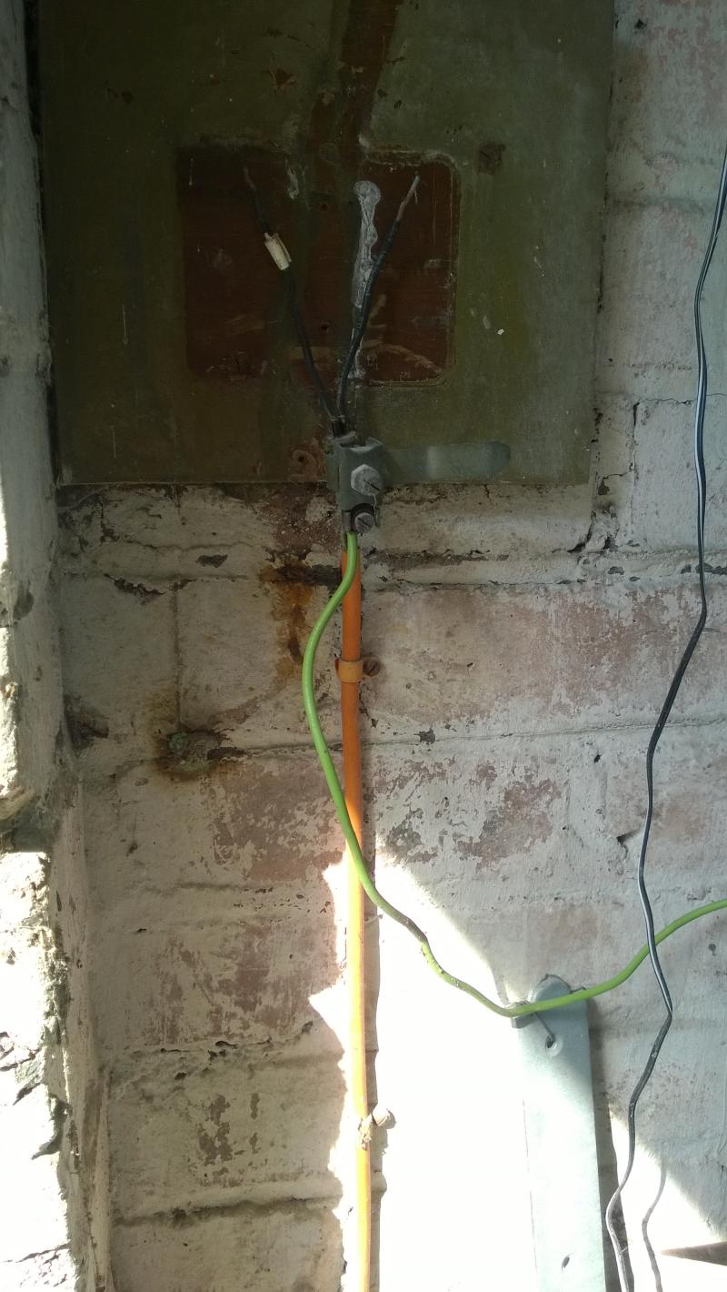

Edit: I've just been inspecting the cable in the garage and it looks like it needs stripping back to before the break in insulation.
What would be the correct way to approach this? Terminate in a junction box and then use regular T&E from that?
Sorry to bump, but I'd like to know if this is work I can legally do, or do I need to get someone in?
I was going to connect this cable to a metal clad, 2 gang, double pole socket - but then I found the splits in the outer insulation. I'm assuming simply wrapping it in insulating tape would be a no-no? ;) Then the way the cable is terminated complicated matters for me, with regard to cutting the cable and 're-terminating' it.
At the moment, the earth cable doesn't go anywhere (in case the picture made you wonder).
Edit: I've just been inspecting the cable in the garage and it looks like it needs stripping back to before the break in insulation. What would be the correct way to approach this? ...
Sorry to bump, but I'd like to know if this is work I can legally do, or do I need to get someone in? ... I was going to connect this cable to a metal clad, 2 gang, double pole socket - but then I found the splits in the outer insulation. I'm assuming simply wrapping it in insulating tape would be a no-no? ;) Then the way the cable is terminated complicated matters for me, with regard to cutting the cable and 're-terminating' it. ... At the moment, the earth cable doesn't go anywhere (in case the picture made you wonder).
My goodness - I'm not surprised that your electrician was not willing to connect that garage circuit to the new CU!!
I really think you need an electrician!
