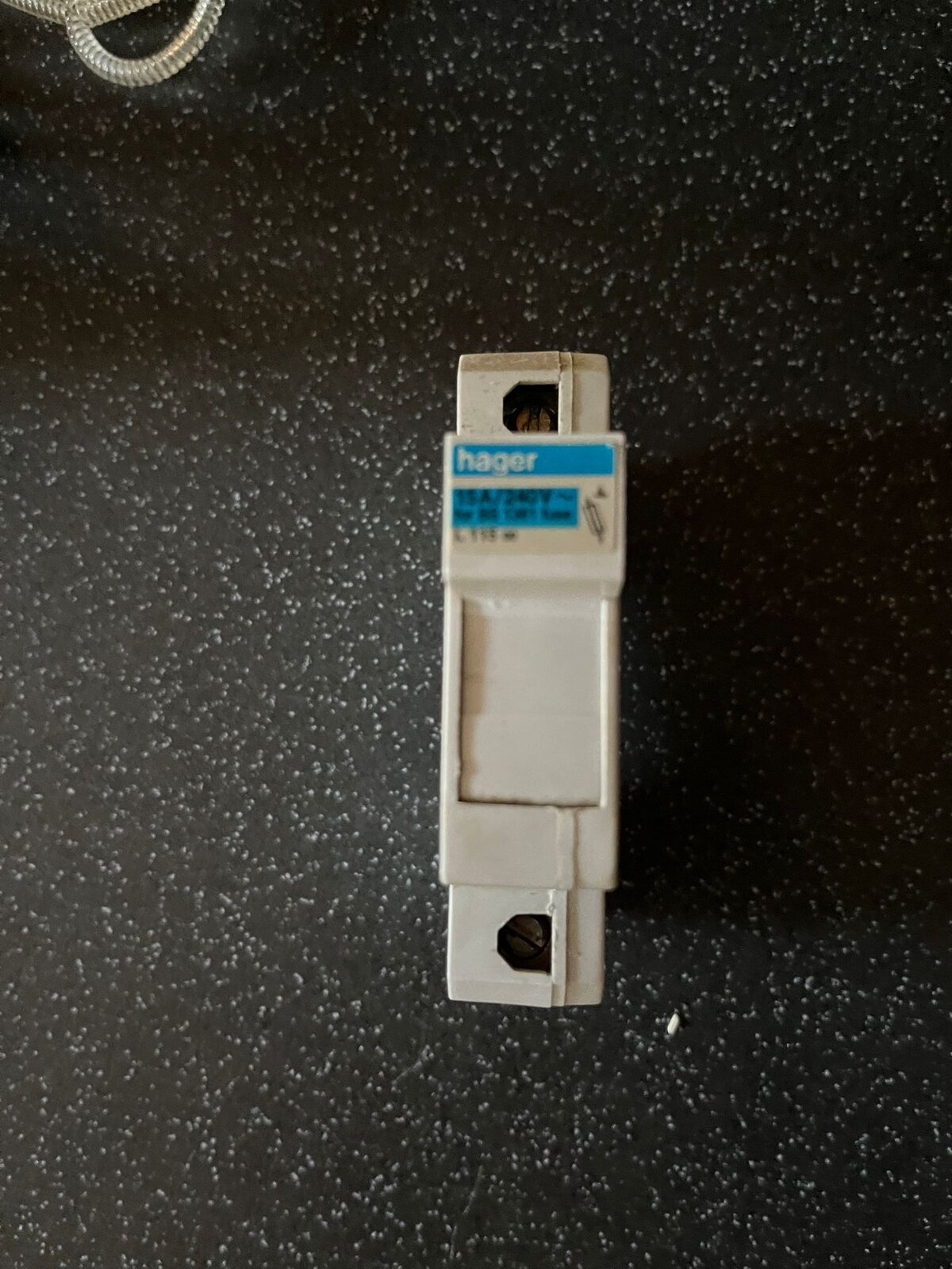

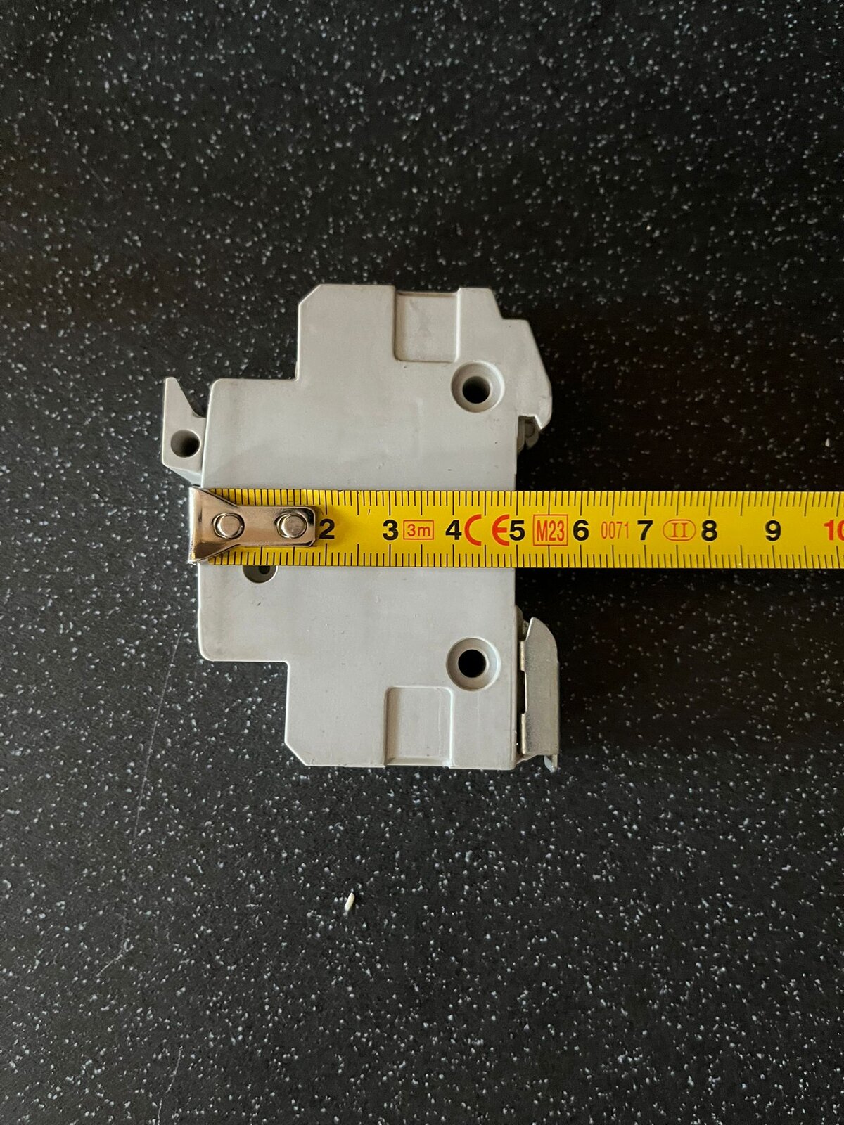

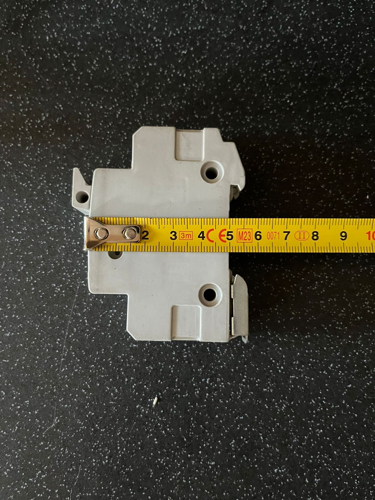

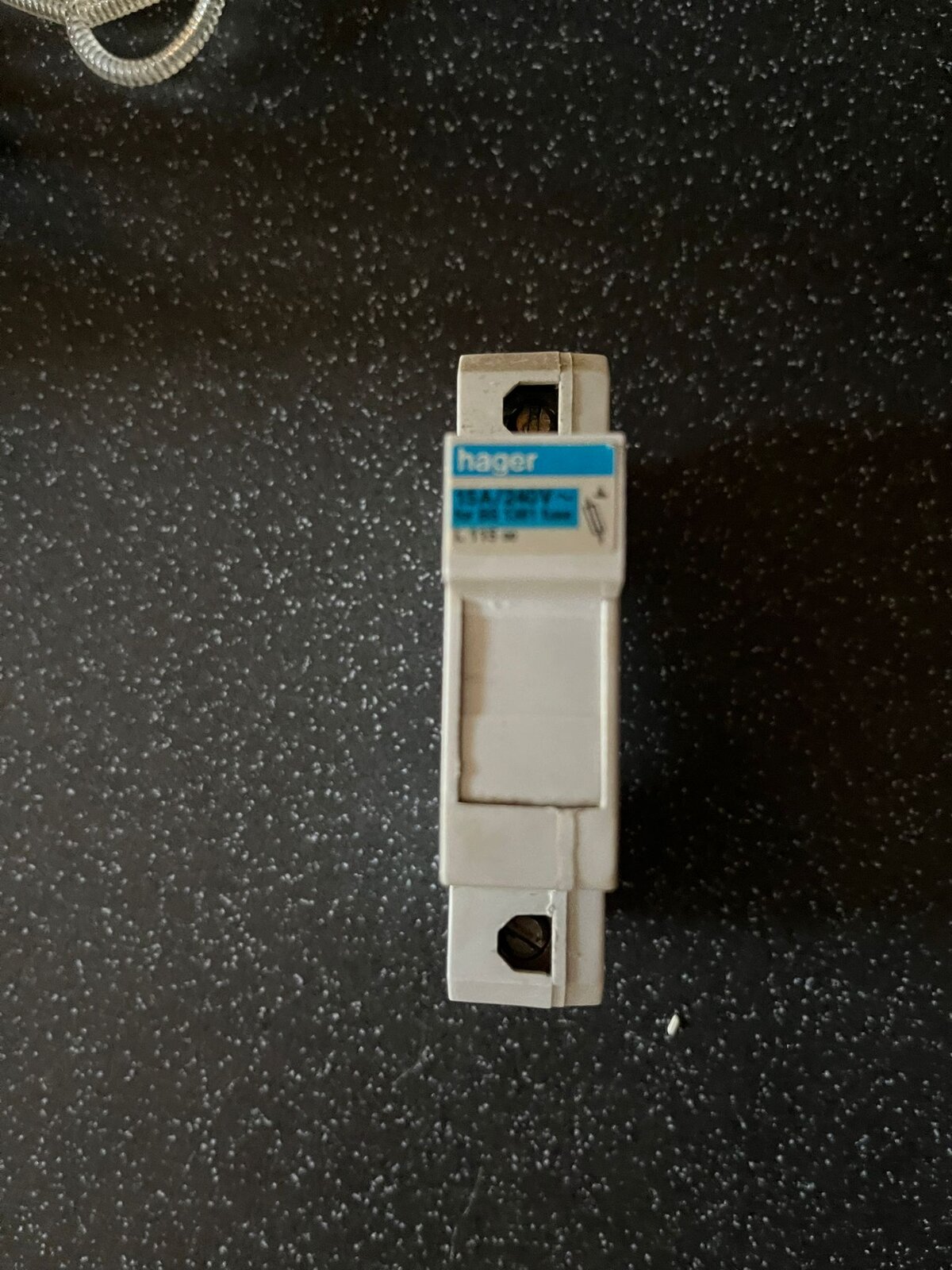

Apologies, it's not an MCB with a switch, it's a fuse which sits in a plastic housing similar to a MCB. I did attempt to buy an MCB to replace it (rather than keep blowing 15 amp fuses at 2 quid a pop) but even though I bought the same make (Hager), it didn't fit. I suspect as it's the original CU the MCB design has changed slightly over 30 odd years.

I have taken a pic of the fuse carrier from the CU. Any idea which MCB I could replace this with? The 'modern' ones from Hager don't fit so I guess I'll be looking at eBay for used.
