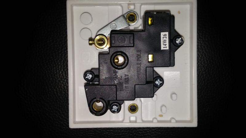

Yesterday I replaced a single socket in the living room as the switch on the old one wouldn't work meaning the power was always on.
Now it was a pretty straight forward swap with the 3 wires going into the correct places so assumed it was fine.
Now that socket has been used since but twice now the power has tripped so i can only assume it is something to do with that socket as it hasn't tripped for a while.
For example today it has been switched on since probably 11am and about 10 minutes ago the power tripped so its not like it trips as soon as its switched on.
Has anyone got any ideas what it could be or what i could check within the socket?
thanks
Check that you haven't pinched N or L cores between the socket and the back box and split/cut the insulation, so that when you push a plug in it causes a momentary L-E or N-E fault.
Yesterday I replaced a single socket in the living room ... Now that socket has been used since but twice now the power has tripped so i can only assume it is something to do with that socket as it hasn't tripped for a while. ... Has anyone got any ideas what it could be or what i could check within the socket?
What is tripping - the MCB for the circuit or an RCD (the latter with a test button)?
Assuming that everything is connected to the right places, probably the most likely explanation is that you have managed to trap and damage one of the wires when screwing the socket back on.

Thanks guys, ill check it now then. You both seem to be saying the same thing so hope its just that.
When it trips its the whole house.
Ok, so its a few days on now and its still happening. When i posted this on monday i was off work, but since then i have been i work every day and when i get in at 5pm the power has tripped.
I have taken the socket off and checked the wires and cant see any problems and today i have put insulation tape on the wires and have redone the wiring so will see how we get on tomorrow but not holding much hope.
I have attached a picture just incase im missing something but i assume it was just a straight swap with the wires fron the old one? Does the fact its a double pole make any difference? I dont even know if the old one was or not.
I cant help but think that its happening at a similar time of day too, could that be possible? I would have no way of knowing until the weekend though and only if im in at the same time. Even if it was, i wouldnt know whats causing it.
[/img]
Did the earth wires have a green/yellow sleeve over them, or were they bare copper?
Any sharp edges where the cable enters the back box? A black rubber grommet may be in place, which prevents damage to the cable.
Wires going in correct terminals?
Send a picture of the new socket wired up.
