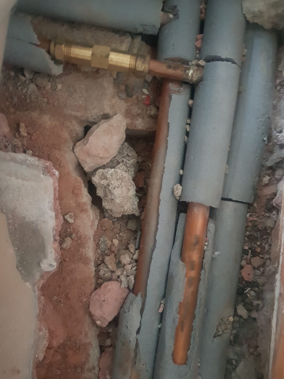

Carpet down so no pics of entire floor, pic attached was small leak had to fix, pinhole in water pipe under floor. Gives idea of construction, looks like thin screed, concrete and what could be described as hardcore (looks like rubble), there was some sort of dpc layer too. Definitely wasn't modern construction by any means.
No drains nearby. I'd like to further explore but short of digging up the floor can only guess at poor construction.
Had thought about digging out the lot and replacing with suspended timber but nearly all advice I've had is just to SLC over it.

Putting my cynical head on, if you're tarting it up to sell on then yes screed to 10mm below ffl then SLC the lot.
If you're staying then burying a mechanical coupler is never a good idea, if you bit the bullet and dug it out you could put some insulation in while you're at it.
I used SBR sand/cement screed to fill the majority of my 50mm plus dip (big old stone flags laid on soil with asphalt on top) you can't really feather it in much but try to get to 10mm and then self leveling on top.
