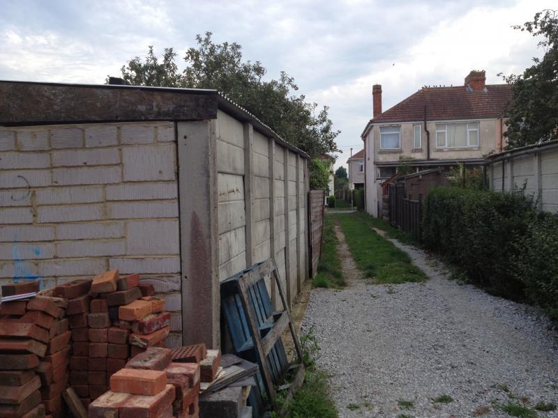

At our new house there is a concrete prefab garage and the end of the garden which has seen better days as you can see from the photos.

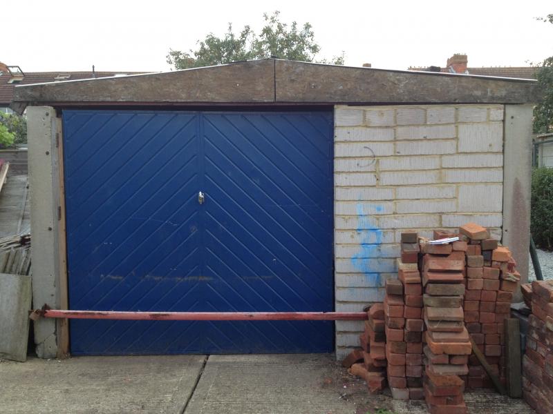

As you can see from the photos the current vendor has placed breeze blocks at one end to fit the unfitted blue door in, he is also leaving me some spare concrete slabs which I think can be used on the garage some where!!

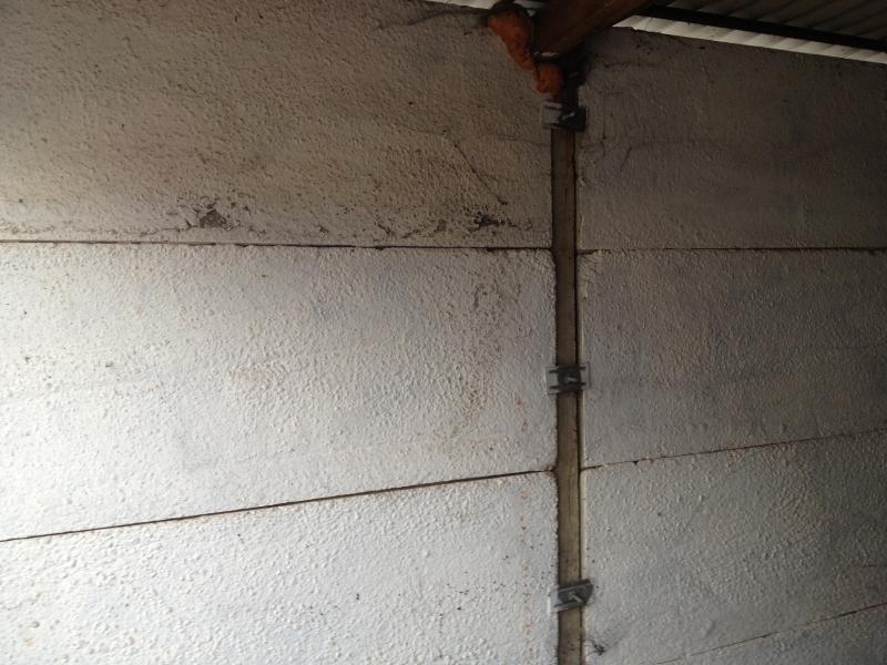

I'm struggling to understand how much of it is pre-fabricated. Looks like just the sides to me.
TBH I've seen worse.
I would like to move the position of the current up and over door to the opposite end as I'm going to fence all round the garden, is this easy to do?
Depends how easy you will find it to brick up one end and open up the other.

IHNI, but if you can it will just be a frame which fits between 2 uprights, so you'd need to remove the roof, remove a section of panels by undoing the clamps and then sliding them up and out, then installing the frame and (probably) sliding 1 or 2 panels back in and then fit the door and replace the roof.
