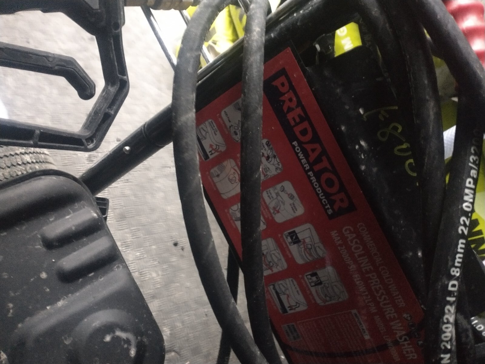

Just bought this in the summer and used once and has been sitting in the shed since. Went to use it today and not much power in it.
Just a quick Google search now once I got a min to sit down, I think it's air locked. If it's this, does anyone know how I bleed it out in this type washer.
Or could it be something else?.

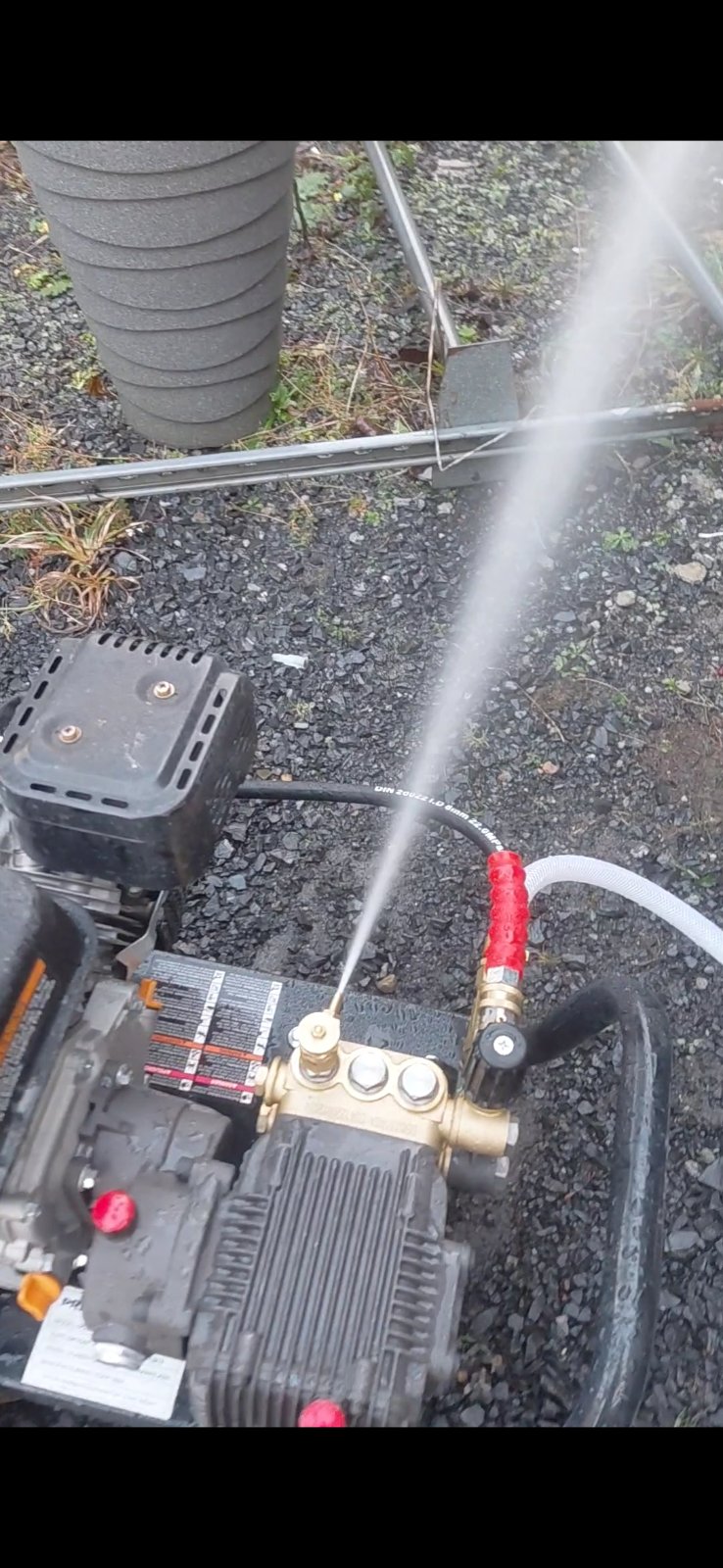

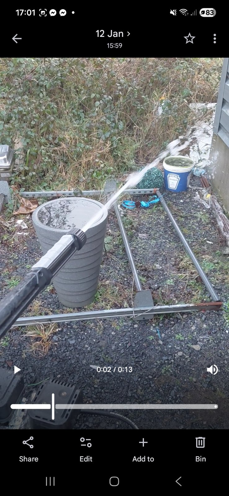

First pic im getting good pressure from this when i unscrew the top. I dont even know wyat the screw is for. Maybe for air locks.

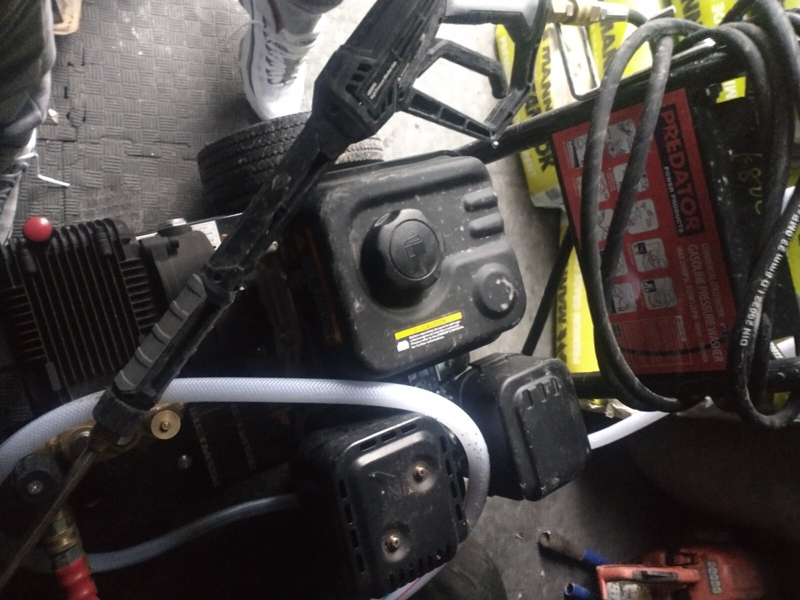

Second pic wyen i put the handle/gun on it, the preesure isnt as great.

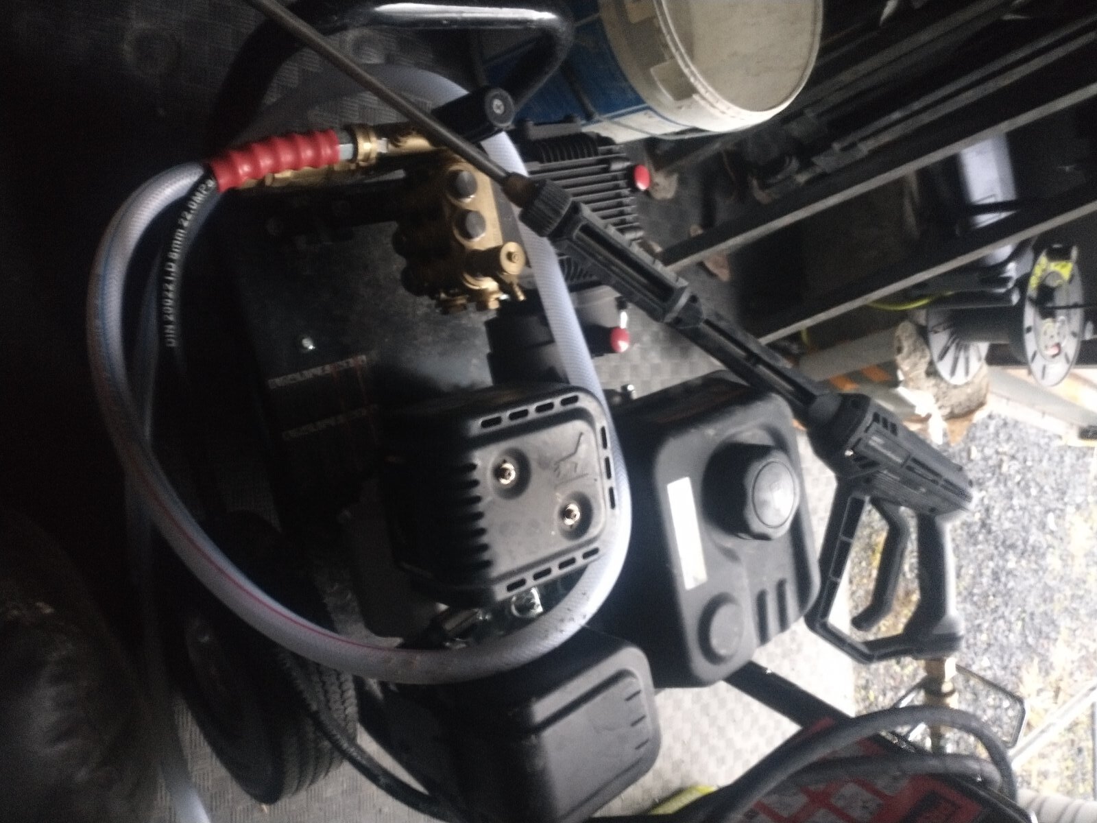

3rd pic, the same as pic two. Splutering

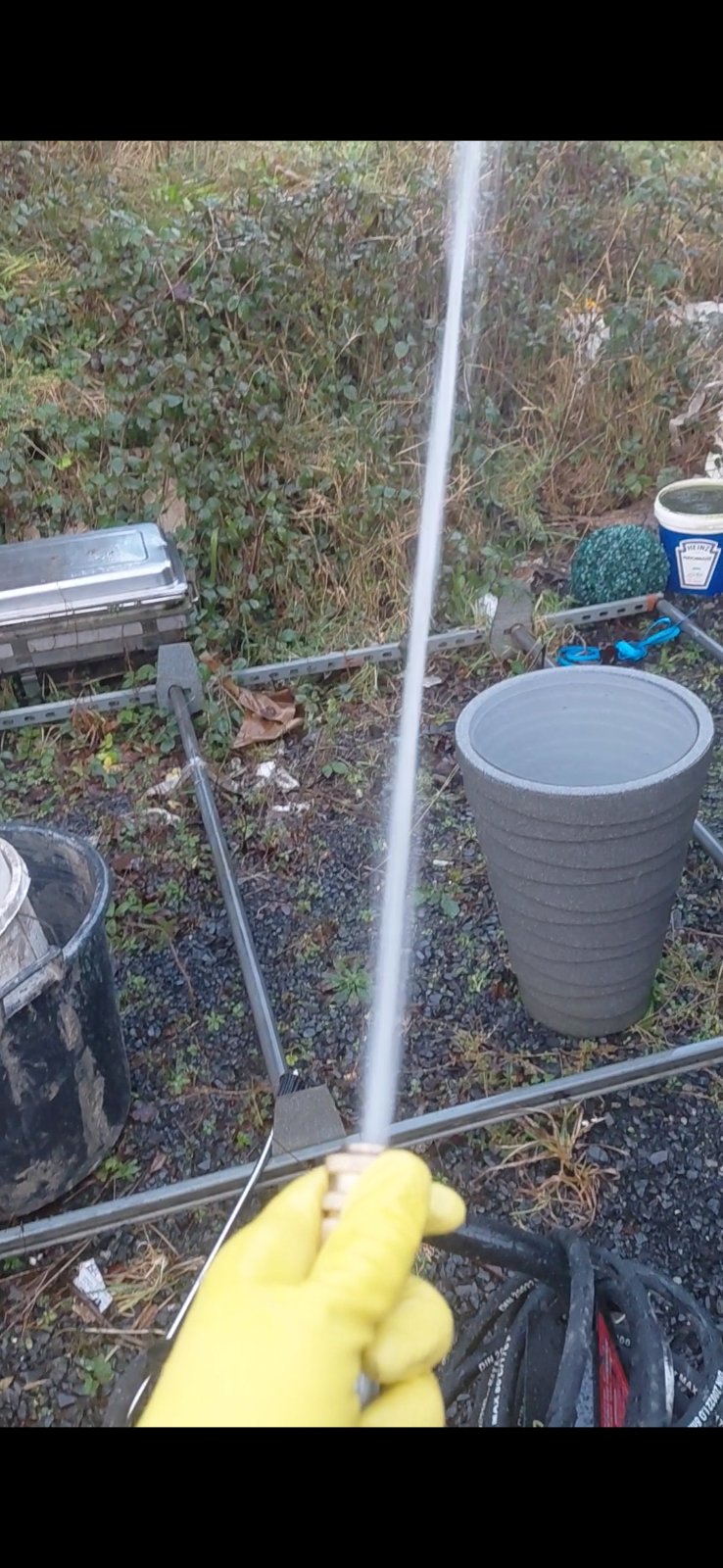

You appear to have pressure, at the washer, and at the end of the hose, but not much from the lance, when that is connected. Maybe the lance is faulty?
Maybe a filter in the lance or pipe connector that's blocked.
Remove lance and pipe and see what it's like.
Then connect pipe only and try
Is the lance a 2 piece one that you can interchange the bottom for different fittings. If so is there an o-ring on the plug in part as if that has come off it will allow the lance to suck air in and drop the pressure.
Have you poked something like a needle through the very end of the lance nozzle to ensure it isn't blocked? It's amazing how one bit of sand can nerf a jet wash nozzle.
If it does seem blocked (can you see daylight through the nozzle when removed from the handle?) poke it and back-wash it with the hose, or remove the nozzle jet (sometimes they're brass and unscrew) before you poke it. Not much point, if it is blocked, poking the blockage back into the lance body as it will simply block the jet again at some point

You've got half the handle/lance on it. The pressure there seems ok; you have to remember that the hole on the end is tiny and where all the power comes from. Without that part of the lance fitted the end won't emit water much faster than it would from a standard hose connection because the bore of the pipe inside the lance is huge compared to the jetting nozzle at the tip of the lance
The process for getting the air out of an jetwash, if the lance comes in two parts (trigger and end) would be to remove the end, squeeze the trigger and turn on the hose pipe but do not turn on the jetwash machine itself
Wait until it's finished blowing air bubbles (there may also be air in the hose pipe)

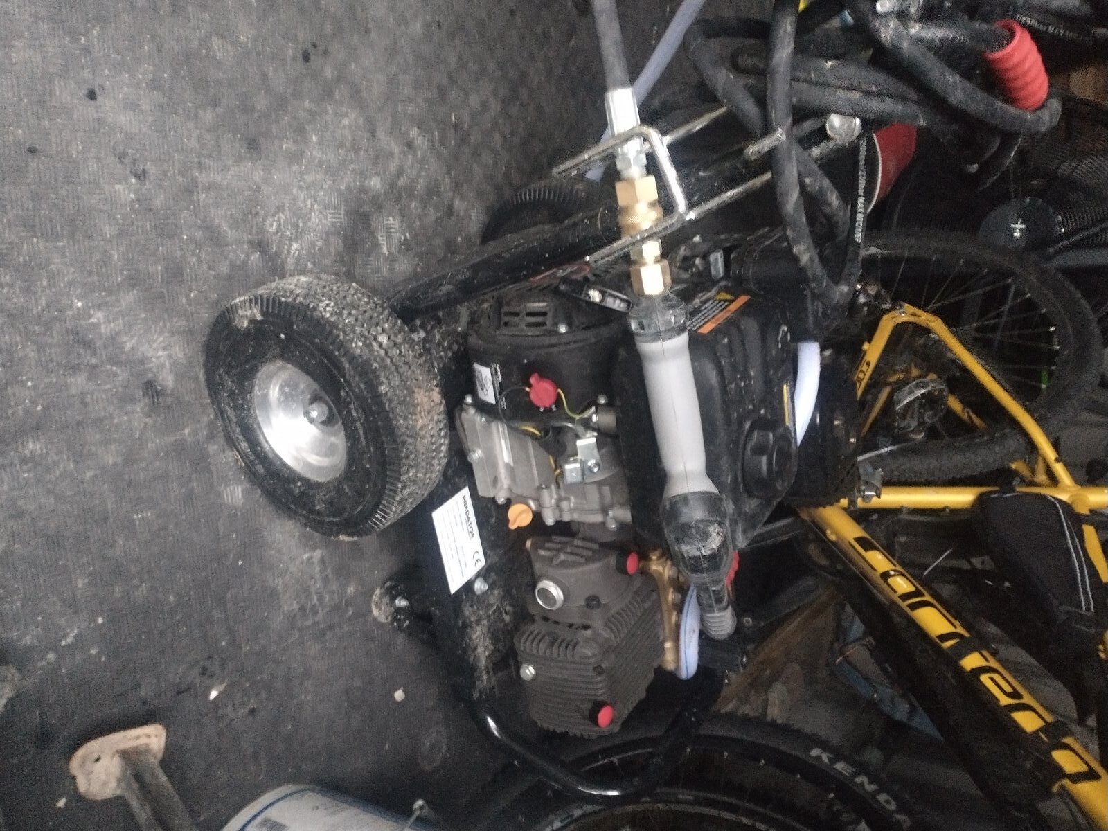

The pressure seems ok at the washer but when I put the hose on, it's not as much pressure. Then when put the lance on the hose, it's the same, not as much pressure.
But you need to appreciate that all these things you're talking about are pipes with different diameters..
"At the washer" - I presume you mean that brass screw on top of the pressure pump?
Small hole; it'll blast out of it
Then you connect the pressure hose; large hole, it'll pour out of it
Then you connect the gun trigger handle; large hole, it'll pour again
Then you connect the lance with pressure jet tip, tiny hole, should blast out of it
You can't look at the amount of water emerging from the pressure hose and say "it seems less/more pressure than X"
You need to be more scientific; collect the water in a bucket and time the period required to generate the volume.. Repeat for each component you connect; it will tell you where the restriction is coming as there will be less water delivered per the same time period after connecting that part
