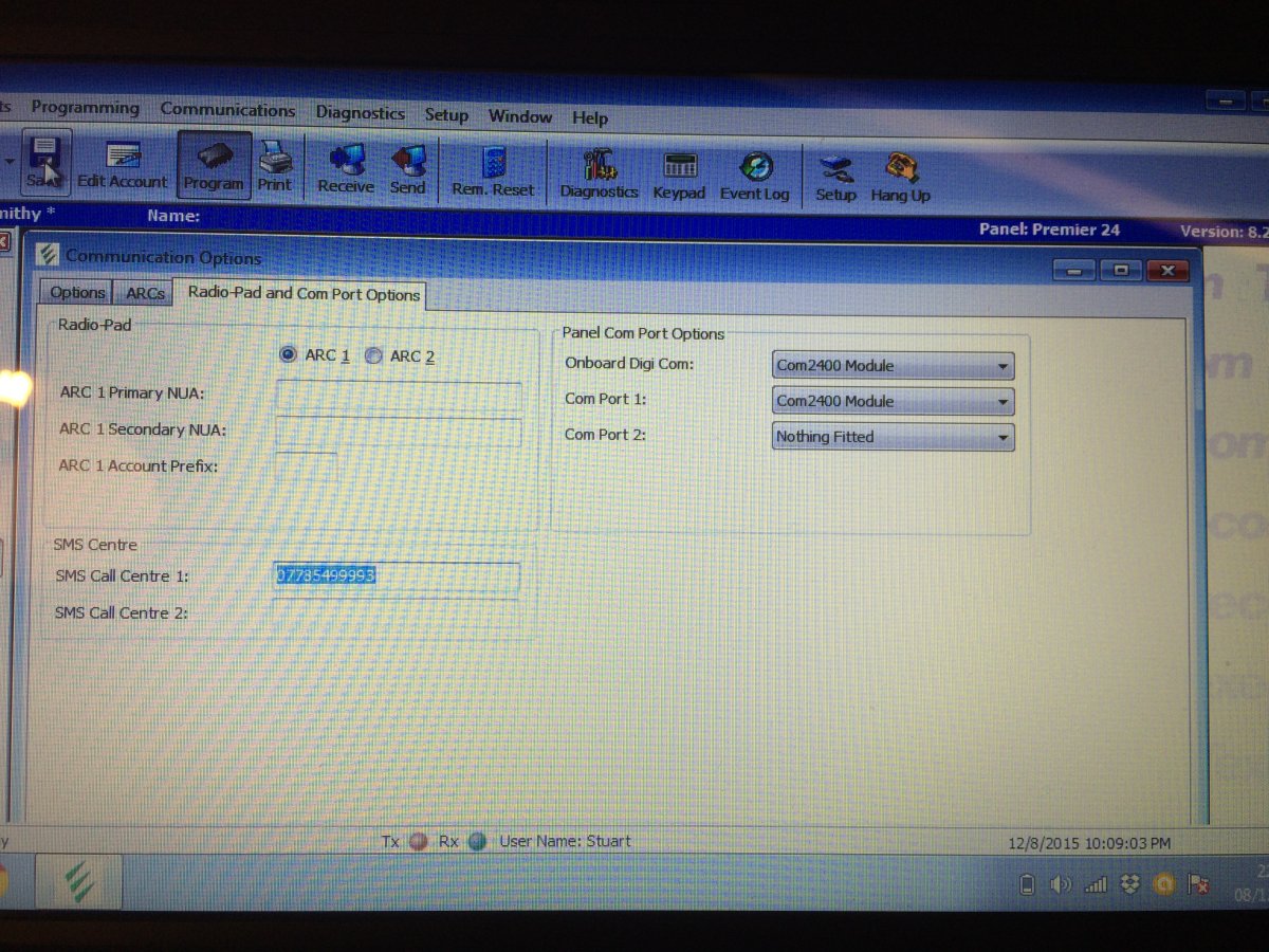

I've not done the following, as suggested, because I don't know how to i'm afraid...
"log into engineering and find the following. (x) s the quick number access rather than scroll through.
udl digi options(7).
1. program digi (3), you details in here.
2. digi options(4), digi enabled, dial all numbers only turn on if using more than 1 ARC ie 3 or more numbers, or more than 1 set of coms.
3. setup modules(7), sms centre numbers in here for the service your using the 480 one is no longer available.
4.comport (8), on board digi, com2400
The modem level is set in global options (3), system options(2) scroll down to modem level."

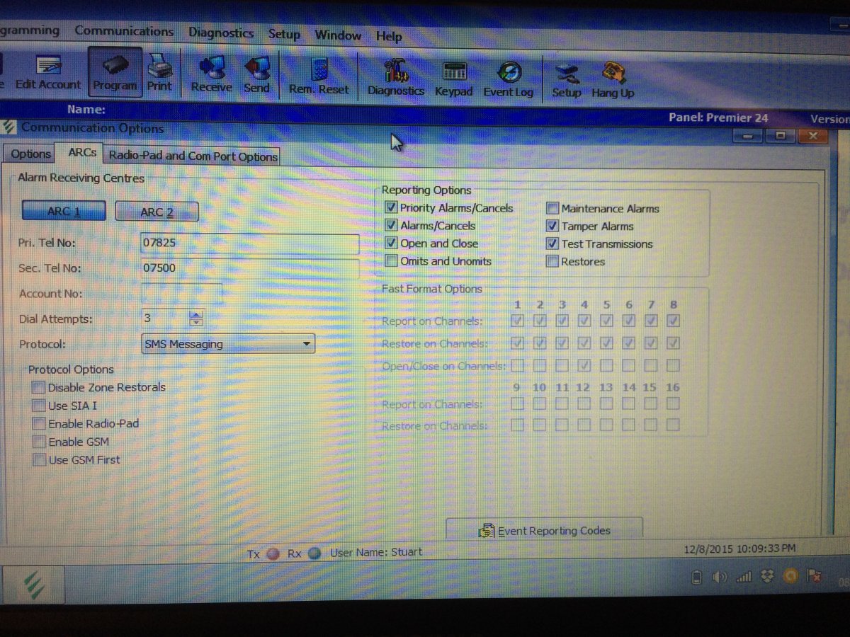

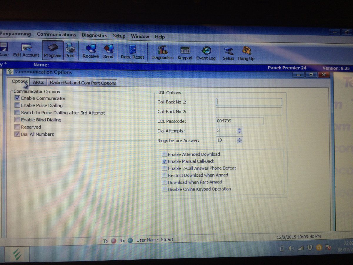

Hopefully screen shots attached... I've shortened the mobile numbers to keep them private.

dial all numbers only required if ARC 1 and ARC 2 are programed up.
you can still dial in okay?, just at default the 2 call answer phone defeat is turned on not off?
Okay, will change that.
Can still dial in fine.
Think answer phone defeat is off. If I call back a second time after 3 rings it doesn't answer. I did use to have that turned on. Not sure why it changes.
if you can still access the panel then I wouldn't be worried but the answer phone defeat is designed so the system rings, disconnects and then when it dials in second time it goes straight into the panel, defeating anything else that would normally pick the line up after a few rins, answer phone/ fax etc.
however that shouldn't affect out going messages.
