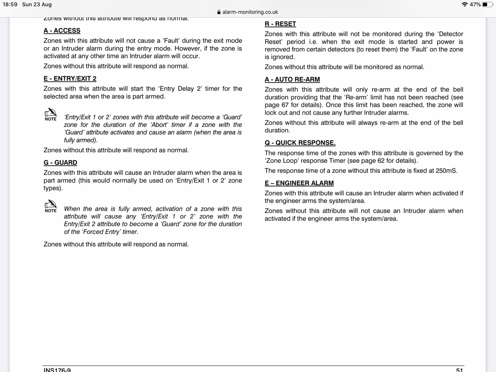

The issue is setup of the system, on a night set you would come down stairs on into the hallway the pir in the hallway would pick you up and start the entry timer
don’t know your settings so hard to say or where your devices are

Both of miy PIR's (hallway and livingroom) are omitted in the part arm mode. So they dont bother us.
My front door sensor is programmed as a entry/exit zone when full armed. IhI 10 seconds to disarm the systemwsystem i open the door when full armed.
I would like to have the same 10 seconds also when system is part armed and the front door opens.
Is that possible
Thanx in advance
Sounds like you have the guard attribute set on your entry exit zone ... FAE081F8-5772-48F7-9718-E9AB305A8E28.png
Yesssss.....oh man, how did i missed this :)
Thanx mate, now my system is exactly as i wanted to be.

If the hallway was set to zone type guard access, then it would start the entry tone when part set and someone enters the hallway and you could still have the guard attribute on the front door.
Taking the guard attribute of the front door has solved your problem but it also means you have no alarm in an evening either so not much point setting it?
