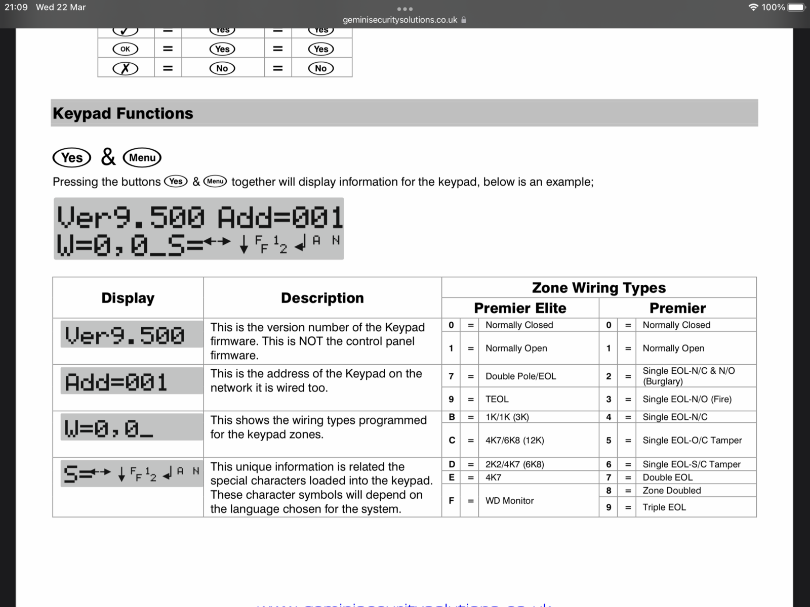

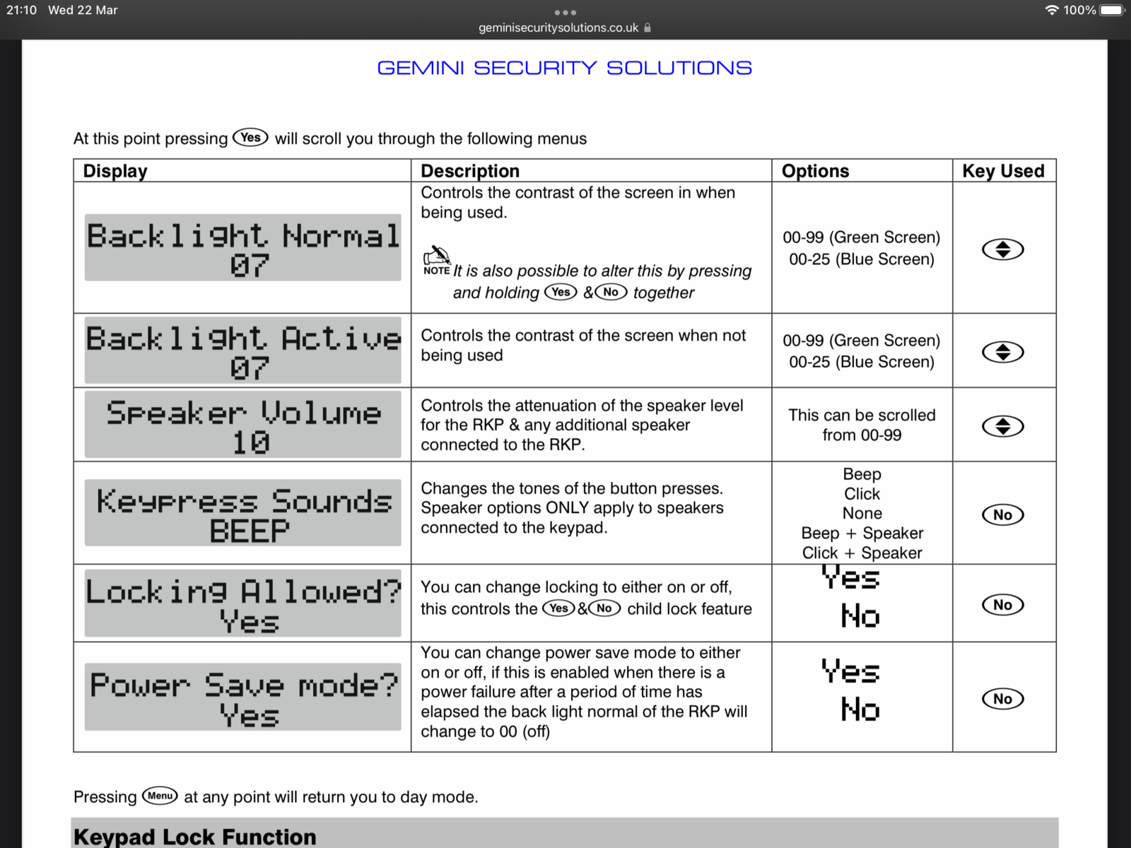

Well it's all connected up, new wired keypad by the front door and the wireless keypad on the landing, is there anyway to dim the lights on the wired keypad, it's very blue and very bright all of the time
As below
I would look at active being brighter than normal, active is when using the screen, normal is when it’s not being used.
