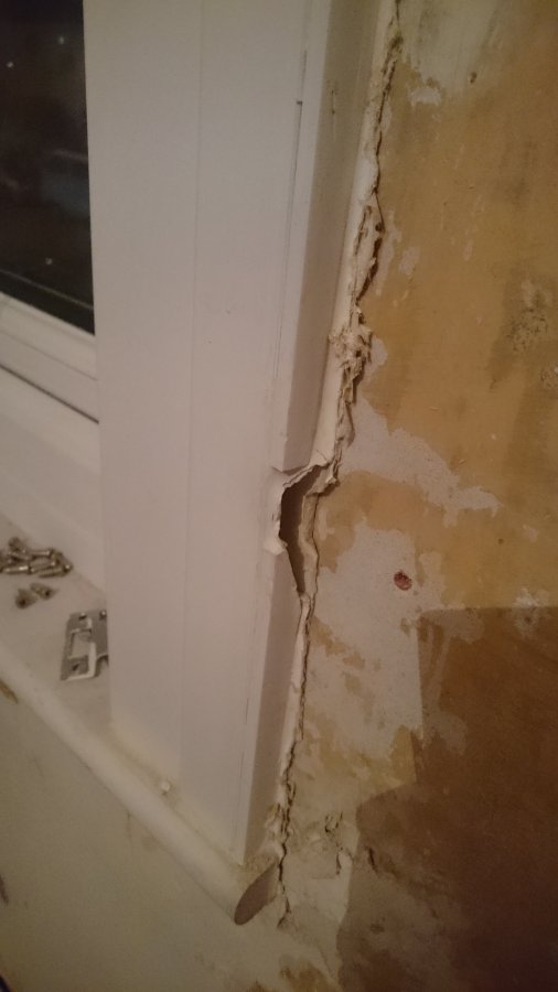

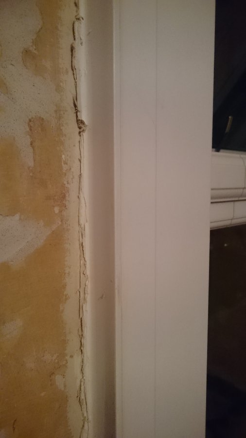

Our first room is almost prepared for plastering. The majority of the wallpaper has been removed (all three layers of it), the skirting boards are up and the coving has been taken down.
Getting the wallpaper off around the windows has been fiddly and as you can see some still remains. Whilst removing this it got me thinking about the window trim and the sealant that has been used when installing the windows.
In order to achieve the best possible finish is it better for me to remove this sealant and the trim it's attached to to give the plasterer the flattest surface to work with? Once he's done I can then source new window trim and seal as required. As you can see from one of the attached pictures some trim has been damaged (not our doing!).
If the preferred option is to remove the sealant what would be the best way of doing this? Do I simply just cut it away?
Thanks again for any help

Personally I'd remove the trim and discard it, plaster behind e line where it's replacement will go and fit new
If plaster isn't going up to a metal bead then the edges will always be a bit messy. You ideally want the plaster to start behind the trim and be a nice surface by the point it is in line with the trim so that when the trim goes on it's neat. Otherwise you're buggering about with caulk etc and trying to cover up/fill in
If you can't remove just that edge piece of trim and don't fancy removing the entire thing, I'd be tempted to use an angle gringer to cut at an angle down the entire length of it, near where it joins the wall, cutting off the sealant, the messy paper and a tiny bit of trim etc, get the plaster as far under it as it'll go then put a smooth bead of caulk on when decorating, or silicone on after decorating
Be careful with angle grinders; massively useful but they're easily one of the most dangerous power tools a person can own. If you don't fancy it, use a good quality Stanley knife instead and cut down the sealant with the knife parallel to the trim and also parallel with the wall. Most the sealant should en come away. This doesn't recess the trim to get plaster under it, but by the time the plaster is on and flatted, then decorated and a new bead of sealant applied it shouldn't look much different
As above take all the trim off, plasterer should do the rest, common now to skim up to a stop bead against the window so it's all bang on. No need for trim after plastering obviously as its to cover up when you replace windows but don't replaster the reveals. Bin the trim and over to the plasterer
