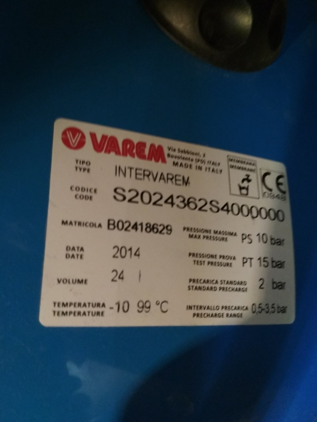

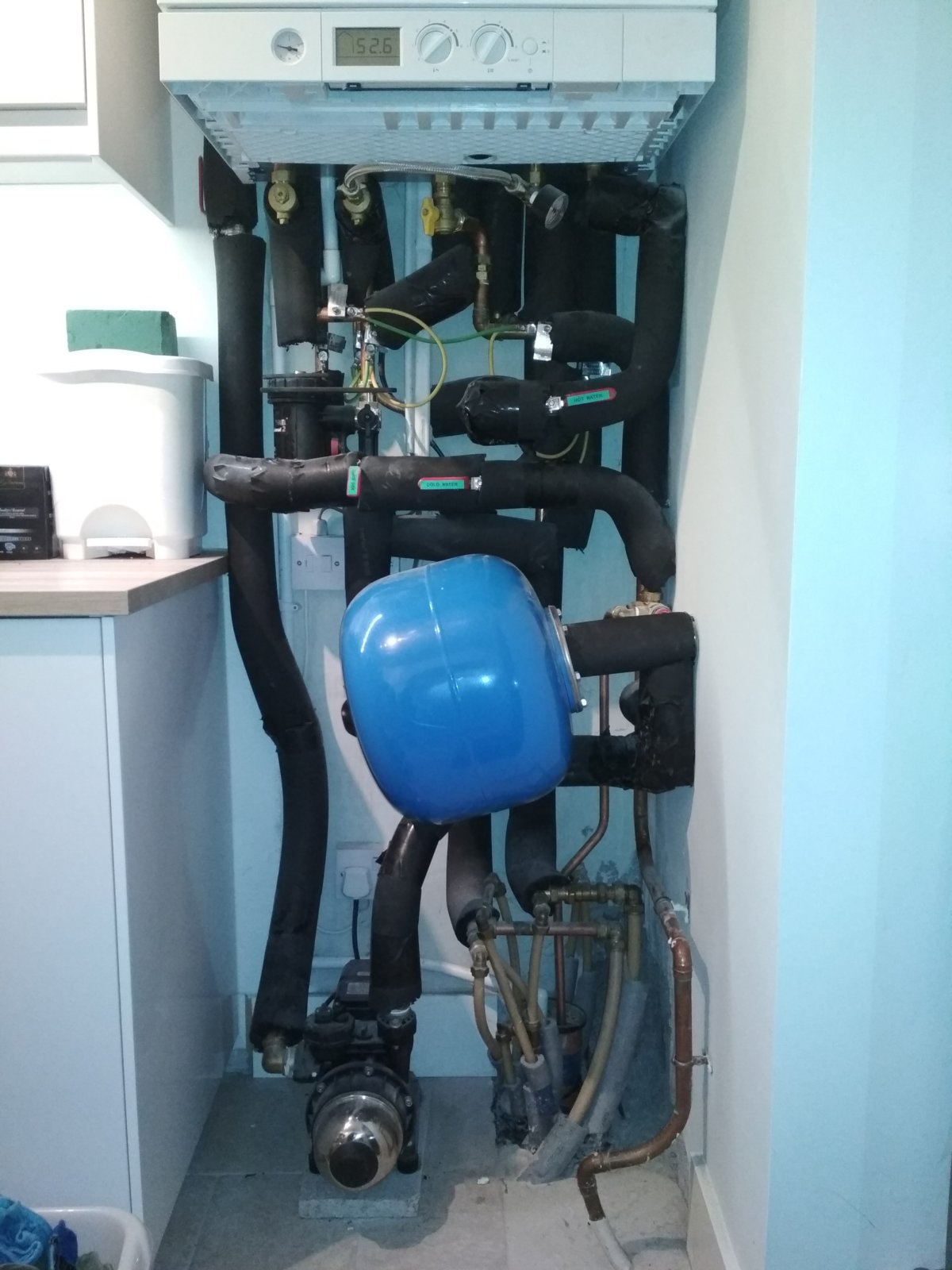

We had a pressurized system installed at our house by our builders plumber 2.5 years ago.
The pressure vessel (24l intervarem) beside the pump has recently started to droop but it is not leaking (yet!). No water from the Schrader valve so I think the droop is due to the tank being poorly supported.
I guess it should be supported with a wall bracket/straps.
Clearly I need someone do this work. However, (to avoid a bodged job) I want ensure the appropriate supports are used.
What would you guys use?

You have to be special to install a vessel like that :LOL:
Yes, it is not inspiring confidence in the rest of the system!
Most reviews of the screwfix mount mention that more than one band is needed and that the band clamps are rubbish.
Do you guys know what size band it is or where to source better quality bands/clamps?
Oh sorry mate , here let me google a better quality item for you as you seem to be busy. :rolleyes:

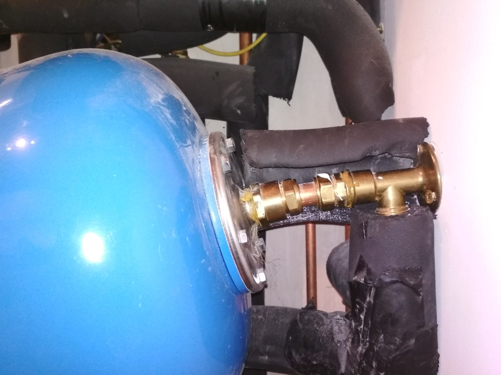

Yes, that Screwfix kit is absolutely useless (I bought one). Really you want something like this:
https://www.toolstation.com/shop/He...essels/sd3234/Expansion+Vessel+Bracket/p14121
I.e. the pipe enters the vessel at the bottom and it is supported there. But that will be difficult with your existing pipework.
Cheers, that looks more robust and I don't mind getting a plumber to move pipes around if necessary to better support the vessel.

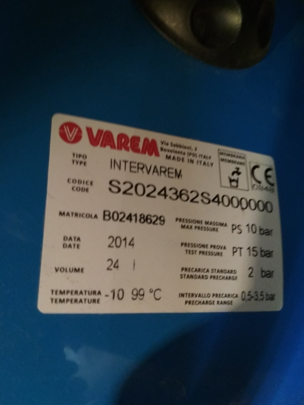

However, the 24L pressure vessel we have is quite wide @ 351mm.
Do you know if that L bracket arm and opening is long enough to fit this vessel?
Thanks for your help!

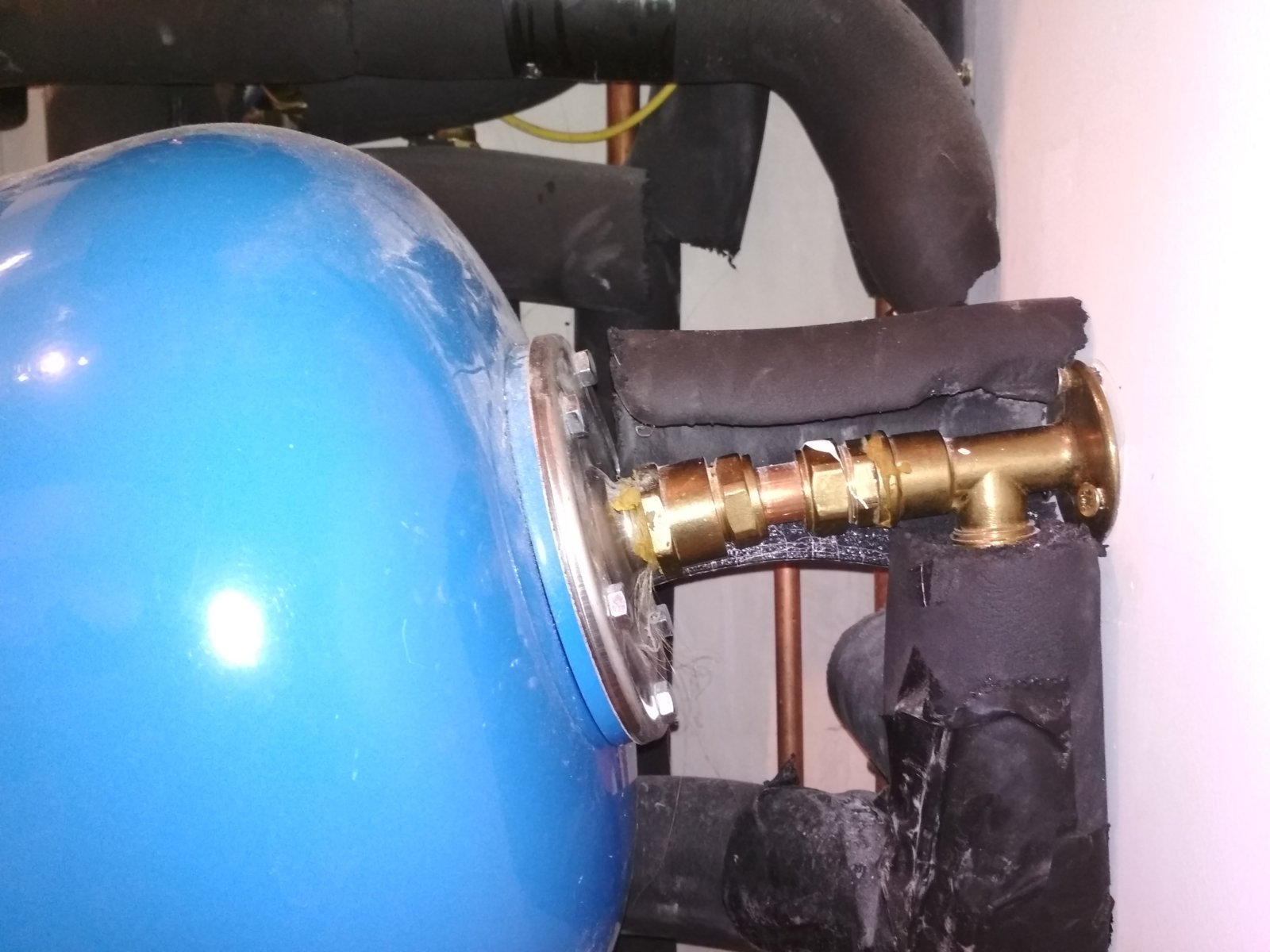

I'm curious, have you suceeded using that strap with the sort of flangeless vessel I linked to?
We can't actually see whether crollorc's vessel has a flange.
Oh I'm absolutely at the bottom of the list, but I do have a 100% failure rate trying to use that bracket!
FYI ... tiny flange
