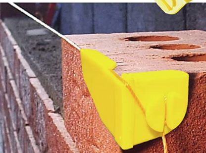

Are you saying you have a single brick at each end of the wall and the string won't stay in place when run between them?
If so, try using more than one brick at each end so they stay in place. Then put one or two bricks on top of the string.
Like this:
There are different gadgets available to hold the string but something like this maybe

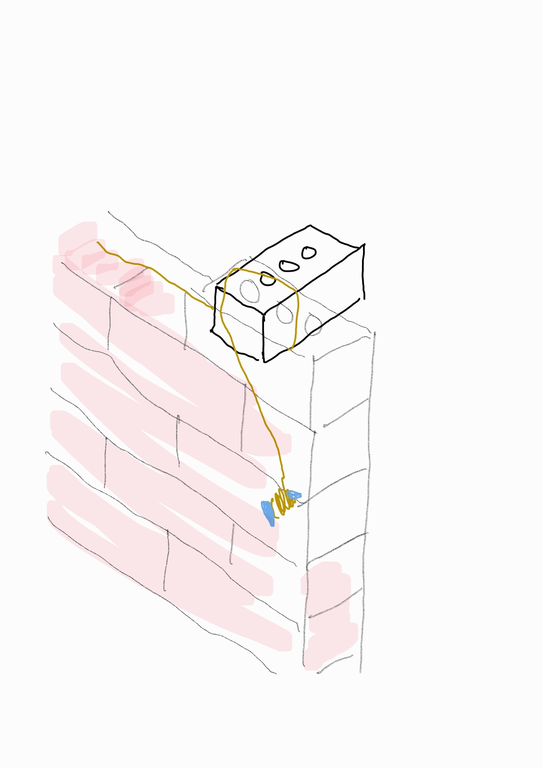

Unless it's just one course, don't lay just one brick, as that leads to inaccuracies which compound with every single other one brick.
Build a corner.
If you must lay one brick, try stacking a few dry bricks on top or a heavy block.

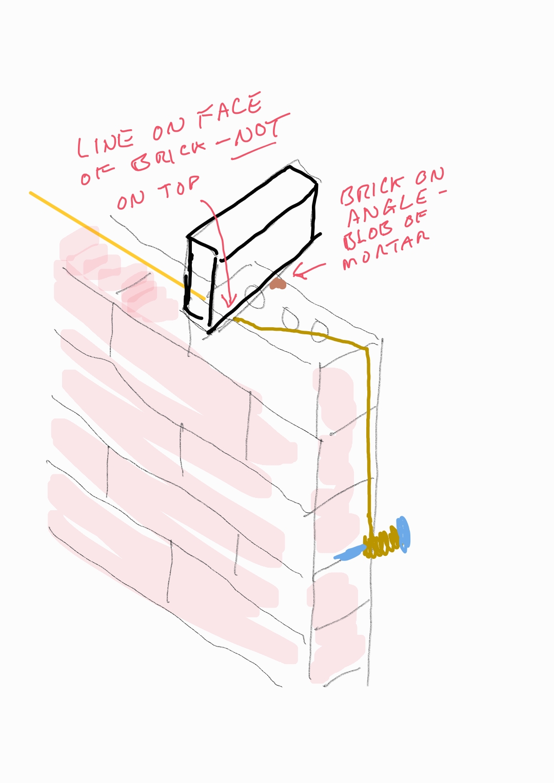

Otherwise, here's the principle to stop the line pulling it off. This stops the line pulling on the one side of the brick. The brick on top holds the line at the arris.
Alternatively, wrap the line around a brick and then pin the line in the wall further back, this restrains the brick from being pulled forward and does not pull on the laid brick.
