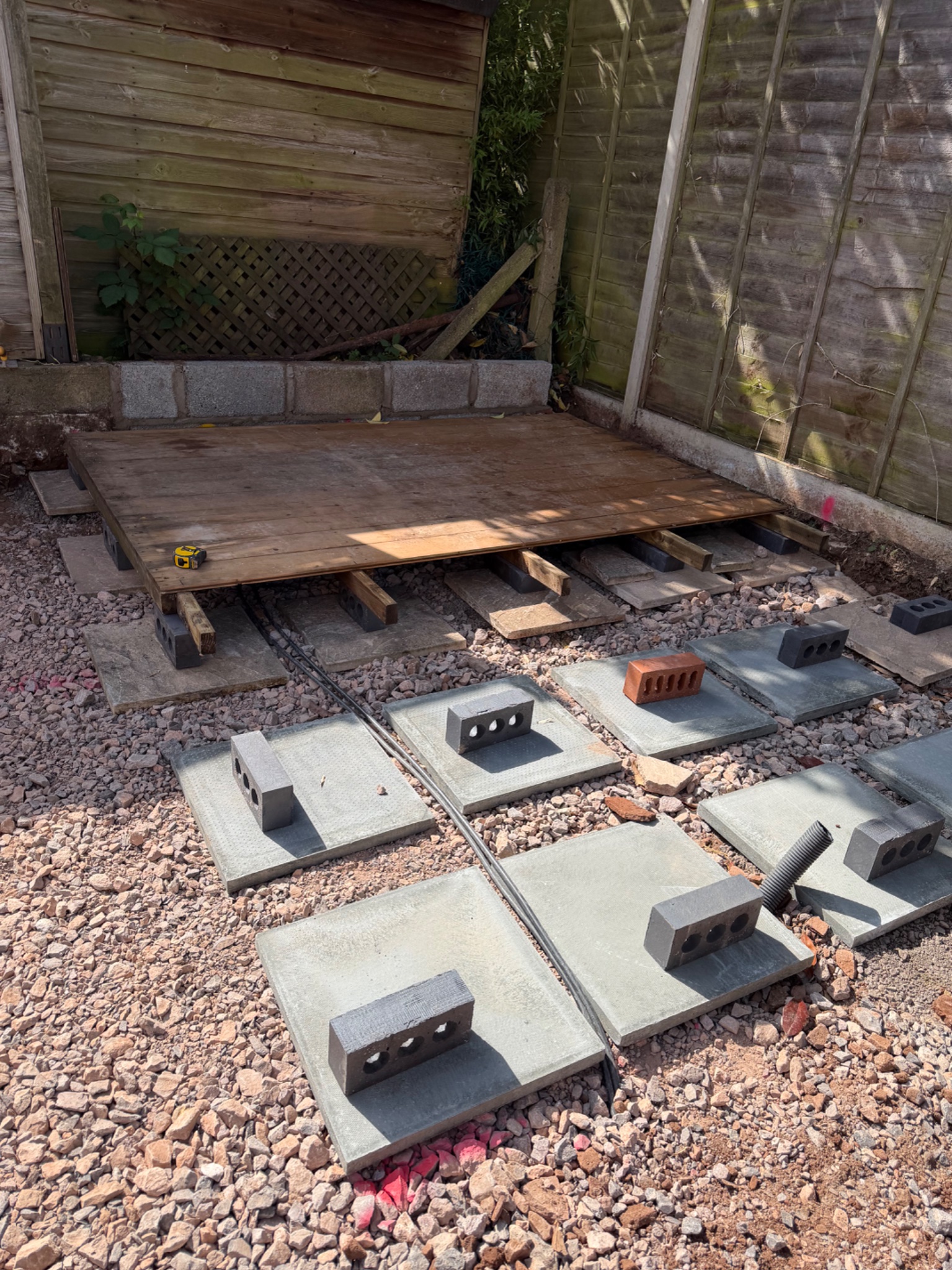

As per post title. Im relocating a very good quality shed and want to stop the base from rotting. I read placing it on engineering bricks will work well as they don't absorb water. Does anyone agree this is a simple good idea. placing on dpc etc will just trap moisture in my opinion
Anything impervious to water, that keeps the shed base elevated, is the idea. You will never stop the wood getting wet locally, but you can help it dry out. I saw some full length black plastic moulded lifters on a shed we moved in Stafford. Seemed like an ok idea. You can just about see them on this shed base...
So went with what i had lying around. Just needed to buy 8 £4 wickes slabs as had second hand ones I had kept. Slabs on the hardcore. Engineering bricks on slabs. Shed on bricks. Spread across 25 points. It’s very solid, plenty of air can circulate, no water can creep up the bricks. It cost me £32.00 as had everything else and took a couple of hours. The slabs sticking out will be covered in gravel. There’s new slabs going down to the level of the top of the bricks.

that will work just fine thanks for the update
mind and keep it to 2,5m from the gravel level [assuming original ground level]as shown in the picture
I’ve levelled the garden so now lower than both neighbours
I think the bricks will shatter on edge like that.
It will inevitably sit on several points on the bumpy surface of the slab beneath, which will be the equivalent of chisels when you stand on top.
