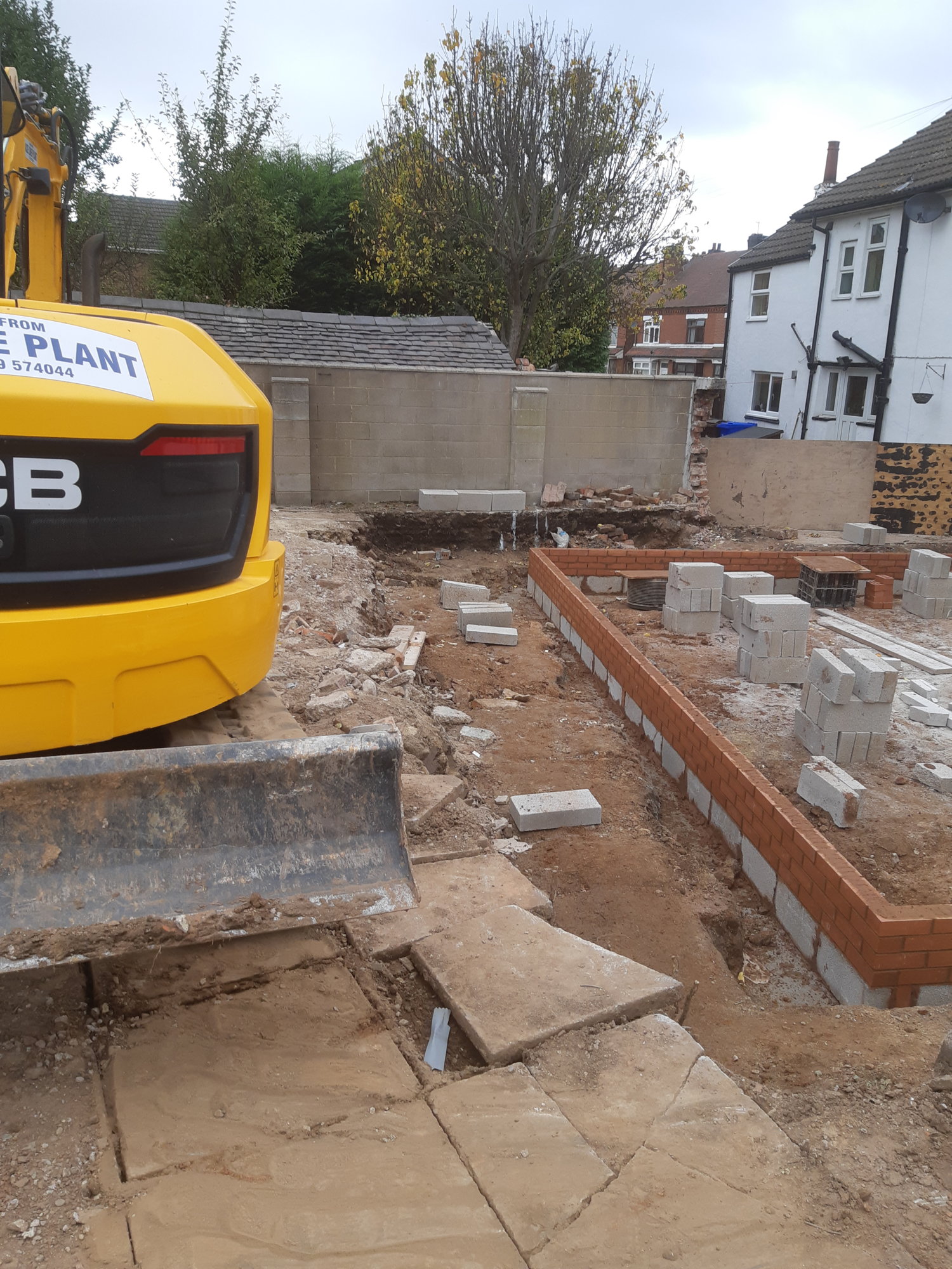

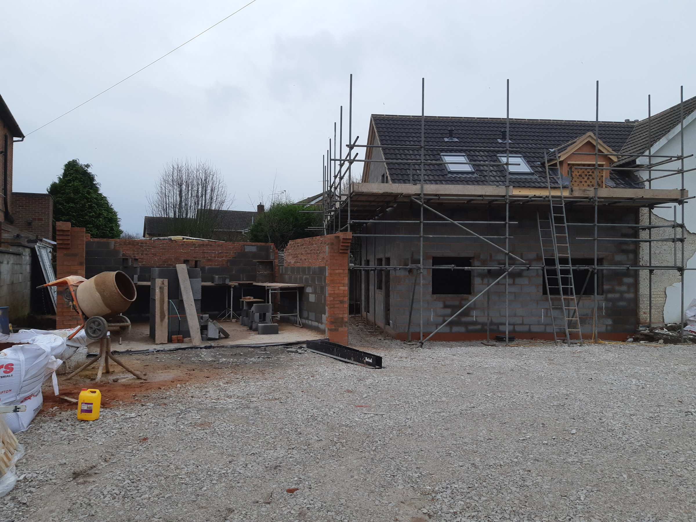

You don't have to use engineering bricks at all. As long as the brick has adequate FL rating, crack on. You could build it entirely in block, but aesthetically, it will look rubbish. Internal leaf and unseen stuff, can be entirely in block - yes.
Thanks very much Noseall. Yes I agree about the aesthetics. The intention is to render over the concrete blocks, but obviously below dpc isn’t really an option to render.
The ground is also sloping so one side would have quite a high dpc relative to ground level, so a lot would be on show.
Thank you for the photos, I think I will go with engineering bricks just on the external leaf up until damp, like the house in the “garage 1” photo you sent.
Match the house below DPC. No need for engineers internally, but may be more practical to just buy one type of brick.
Thanks woody, appreciate your help. Definitely saves a lot of money by not putting them internally
