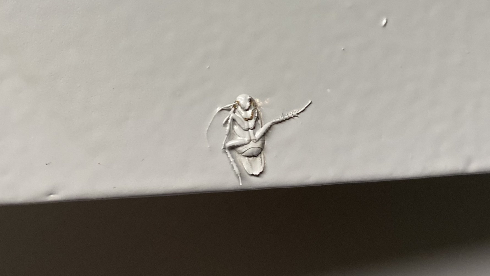

Hello,
So between the council (council owned property) and the previous tenant, someone has decided that you don’t need to remove pieces of food, blue tac or anything from the walls before painting them. There’s even streaks of paint, you can see where it was dripping down and eventually dried into that shape. No idea X what they painted with, must have been really thick.
They’re in really shabby condition. All of them, in every room…
What can I do?
I don’t even think wallpaper will hide how unflat the surface is.
If I intended to live here for a year or two I’d not care. But the location is ideal for my child to get to school. So I don’t want to move any time soon.
I'd scrape with one of these - screwfix scraper
Then sand then wash with sugar soap. Then fill and feather the holes with toupret fine surface filler. Only this, no cheap easifill.
Then sand and paint
Gonna be a long long time doing this
It’s the same on every wall throughout the apartment.
Bug does look nice tho! Wonder if I can buy some to install
