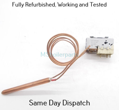

The pcb does not control the power to the pump, this is done by the seperate pump over run relay

Yes you will know if the pump is getting power, if it isnt it will be the over run relay , if it is getting 230v AC then it is the pump (most likely culprit)

The pump overrun has a Phial same as any other thermostat, and it will depend on the residual temp in the heat exchanger if it actually comes on or how long it stays on, and yes the water is circulated but the ABV then the overrun will control the pump, here isa pic of it
Thanks Ian. I just managed to find the Potterton installer's manual {original paper copy from when the boiler was fitted).
According to the fault finding chart, the pump overrun not operating -> replace overrun thermostat.
And since I also have the intermittent failure to power pump (still to confirm this vs a pump issue), the overrun thermostat is looking like the culprit.
I checked the availability of Potterton part No. 404507. Whilst it's still obtainable new and used, lots of suppliers show it as obsolete and out of stock.
We have been with BG Homecare since the boiler was installed 30 years ago, I wouldn't be surprised if they've no stock of that part and decline to repair the boiler. Whilst I would consider tackling a PCB swap out, I am not qualified to do the overrun stat since it involves removing the sealed case cover. In a way, I hope it is the pump as BG will have no supply issues replacing that.

Boiler is firing its just the pump is not always running, nothing to do with the thermistors, which this boiler doesnt have anyway, it has a liquid control thermostat and it isnt that either

I have wired up a small bulb to PL in the airing cupboard junction box. Next time the pump doesn't run, I plan to get there quick and see whether the bulb is lit.
Just seen the pump lose power and a variation on the issue I have not witnessed until now:
No demand for CH or HW. Boiler off. Pump off.
Demand for HW arrives.
Zone valve opens, pump comes on, boiler fires.
Pump ran for about 10 seconds then went off. The temporary light also went out.
Boiler continued to run. I turned it off power at the isolator before it started kettling badly.
Waited 10 seconds and turned on power.
Pump and then boiler ran as normal and continued to do so.
So I think this confirms issue is with the boiler. What's more I have now also witnessed the boiler start the pump successfully only to then cut power a short while after.
Does all this still point to overrun thermostat?
