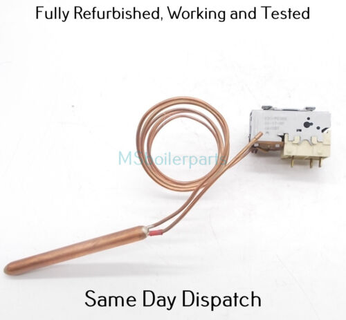

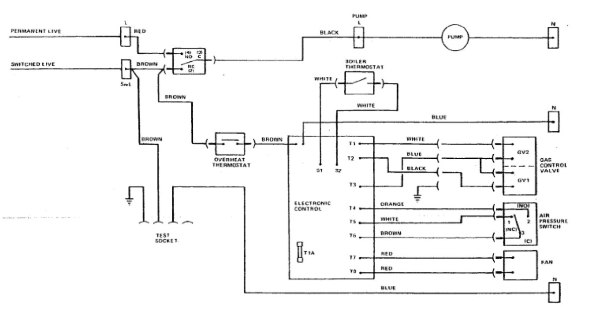

The pump overrun has a Phial same as any other thermostat, and it will depend on the residual temp in the heat exchanger if it actually comes on or how long it stays on, and yes the water is circulated but the ABV then the overrun will control the pump, here isa pic of it
I managed to find that part new. Fitted today and now all working properly. Many thanks for the help.

I'm curious, what happens in these overrun thermostats to result in poor contact to switched/permanent live? Is this metal fatigue in a bimetallic strip or something else?

With the benefit of hindsight and having got hold of the boiler installer manual, the overrun thermostat is unique in that it seems to be the only component that works independently of the pcb. The pcb seems to be the most prominent, therefore probably the most sought after, part for this boiler on ebay.
As these thermostats switch over every time your heating is switched, the contacts tend to become charred with the constant making and breaking of the contacts, same as any other relay, hence sometimes they make sometimes they dont
What was your logical conclusion that came to the fact that something as important as an on-off switch such as a thermostat (its what it does) is not connected to the board?
I arrived at that conclusion, with hindsight, and having subsequently got hold of the the functional diagram. I didn't base my decision to replace the component based on that but rather the advice received here and elsewhere. Also, I don't think I said I performed the fix myself.
The diagram (I attached post #16) suggested to me that the power to the overrun thermostat isn't via PCB but rather direct from either boiler's permanent or switched live, depending on the state of the thermostat. You might want to reread this thread!
