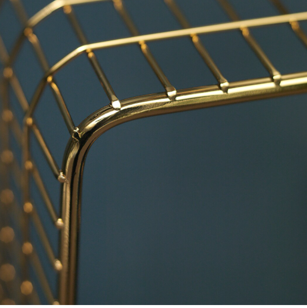

Hi,
Does anyone know whether I'd need to use a self etching primer over this steel, nickel plates shelves? Or would Rust-oleum multi surface primer for example, do the job?
Cheers,
Chris
I would use etch primer after first scuffing it with wire wool or emery cloth.
