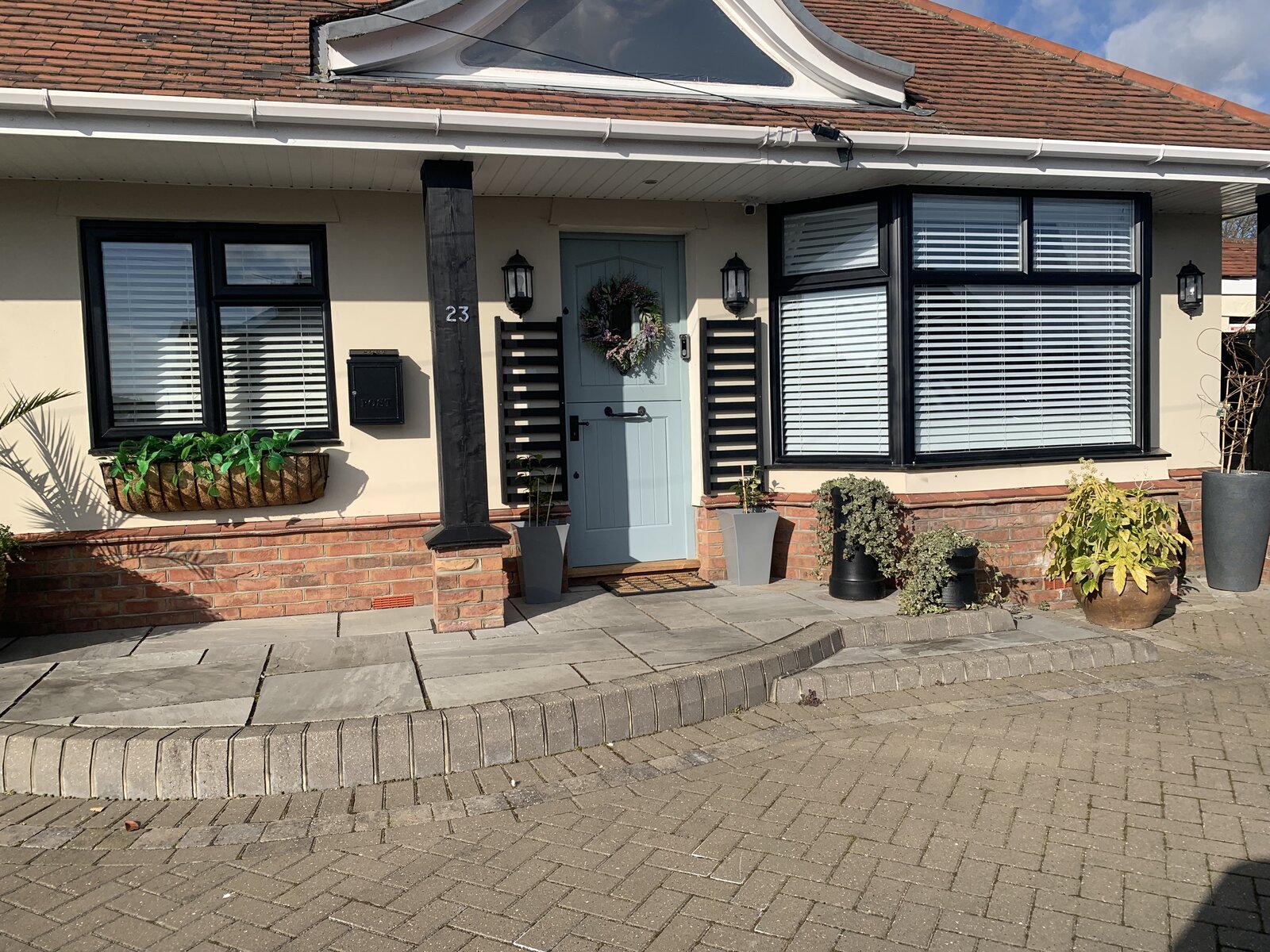

You can spray directly with correct plastics paint no primer required.
Did mine with rattle cans around one can per window.
Were they white to start with. A very impressive job. which paint makers did you use if you don't mind me asking. May be needing it myself soon.
Yes white to black , used paint from PN-trade ( my link was removed).
They do matching paint in small tins to touch up any areas too small or difficult to spray .
