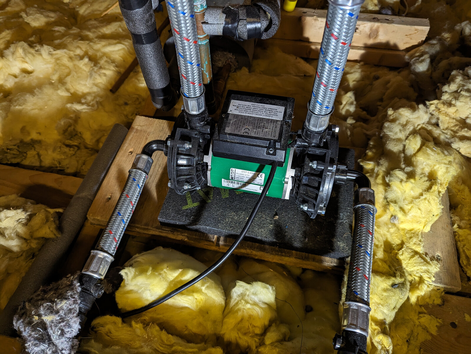

So the deal at the moment is an odd setup. We moved in last year to find the well water was sent through a filter, then a ph correction and then through the UV but then sent to the holding tank where is was free to pick up anything that found it's way into it! The outlet is then split: Hot via the cylinder to a pump along with a cold feed. This gives us pressure for H/C to showers and upstairs bathroom. The other feed, both hot and cold, is gravity downstairs which is really poor.
So my plan:
Have the well water sent direct to holding tank. Then the cold is split, one fed through the filters to the existing pump along with the existing hot feed, the other to a new pump along with the old gravity hot feed so I have full pressure downstairs.
So my question is more about if that sounds logical, and rather than getting a new pump, would the existing pump cope with adding the other feeds instead of getting a new pump?
The only reason I mention a second pump is that of all the plumbers that did turn up (and not get back to me), the only one that came up with a solution was a company called Filpumps who corner the market here with prices to match. They mentioned a similar setup, but said a second pump would be needed. I presume because the existing pump would be inadequate for the whole house as it's only 1.5 bar - see pics. But why not just replace the old pump if this is the case I wonder?
If a single replacement whole house pump would do the trick, any recommendations? I don't want too much pressure as all the piping on the gravity fed has not had pressure before, so this is a concern.

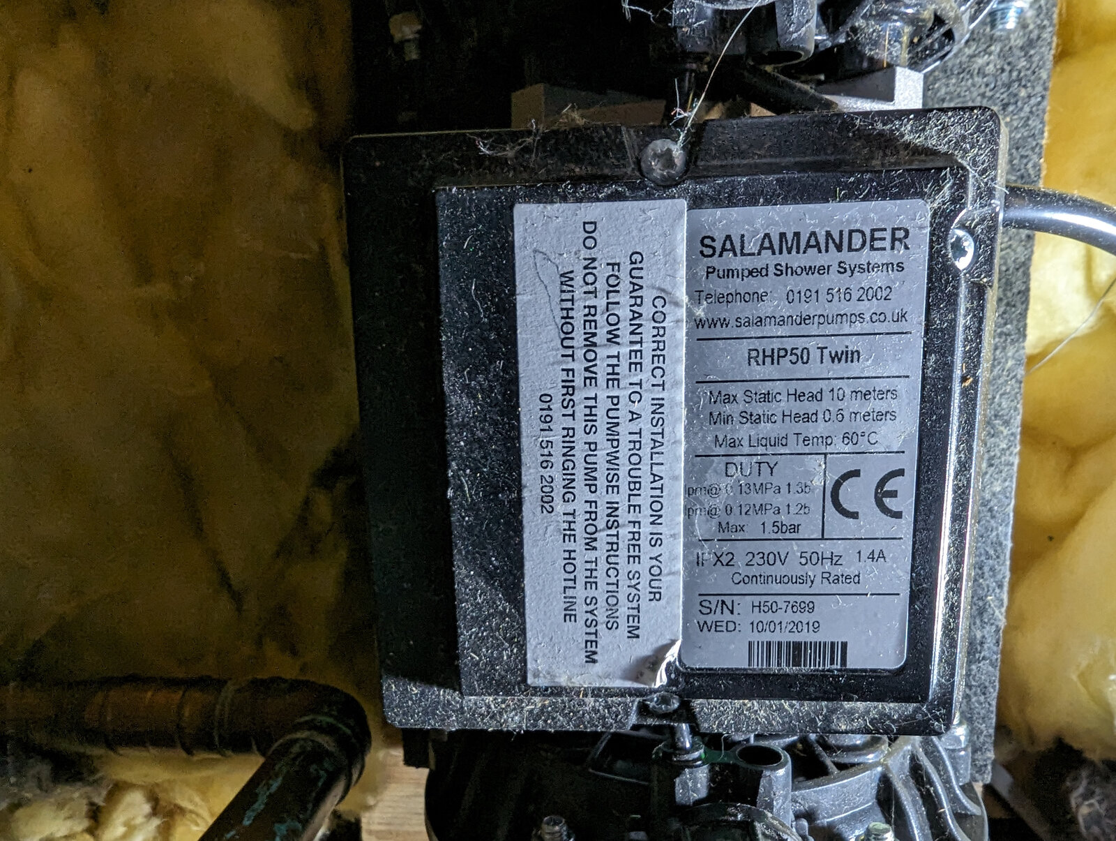

Whole house pumps, then you can't do much better that an ST Monsoon, size would be determined by what it may have to feed dynamically. Given the number of bathrooms and potential showers/bath that could run at the same time then a 3bar setup would probably be needed.

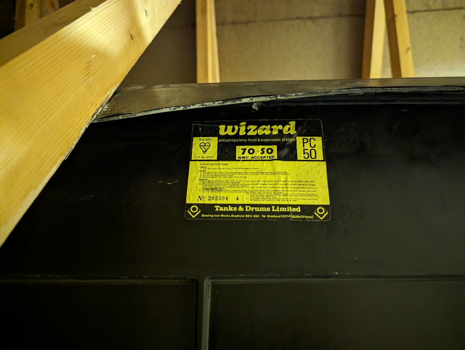

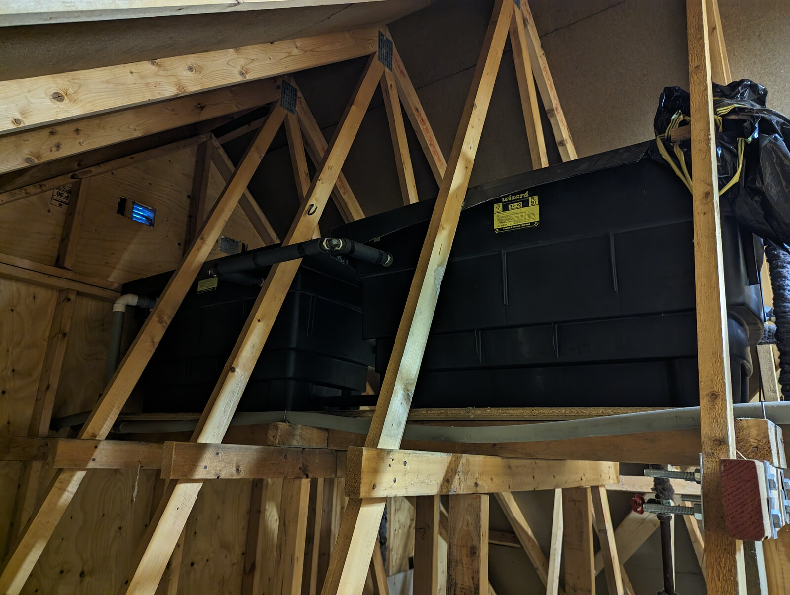

If it were me, I'd be looking to keep the lift pump and filter arrangement as is. As Madrab says, seal the header tank(s) so the only ventilation is via a filter to stop "things" getting in, and insulate them well so that a) they don't freeze in winter, and b) they don't warm up when the roof is hot in summer (I'm sure that happens even in Aberdeenshire :D) - it looks like the roof itself isn't insulated so the loft will get cold and hot with the weather. If they are "cruddy" now, then a good clean would be in order.
I'm thinking that your lift pump may be relatively low flow rate, and putting the higher flow rates, and in particular the "lots or nothing" regime through a filter would mean a bigger filter to cope with the max flow and poor utilisation when it's sat idle. Again, I'm guessing that if you (for example) fill the bath, the lift pump will take a while to refill the header tanks.
In terms of making sure you have through flow, make sure your inlet and outlet are at opposite ends, such that water flows through one tank, into the other, and then to the house. If supply and demand were on one tank, then the other would go up and down a bit, but the water would not get regular changes.

For simplicity, your first options would be the way I would go but a question; Would you suggest I exchange the pump I already have for pressured hot and cold for something like the Monsoon pump Madrab suggested which would enable whole house pressure - with me teeing in the existing gravity feeds off it, or perhaps a smaller pump inline of the gravity H/C and keep the existing? If that makes sense.
1.5 bar of pressure is 15Metres head. I'd have thought that would be enough. I think you probably need a higher flow rate water pump.

That tandem tank setup doesn't look quite right given where the communication pipe looks to be so high up but not seeing the whole set up then it's difficult to be sure. The norm would be fill the first cistern, large comm pipe is at the bottom and the downstream cold feeds are all at the far end of the 2nd cistern. That ensure a constant flow through the whole storage. They should also be insulated. Also if it's an open vent HW then the vent should be taken up and out and not back up and over into the storage.
Once it comes to designing the downstream setup then that would normally follow any normal gravity design approach.
