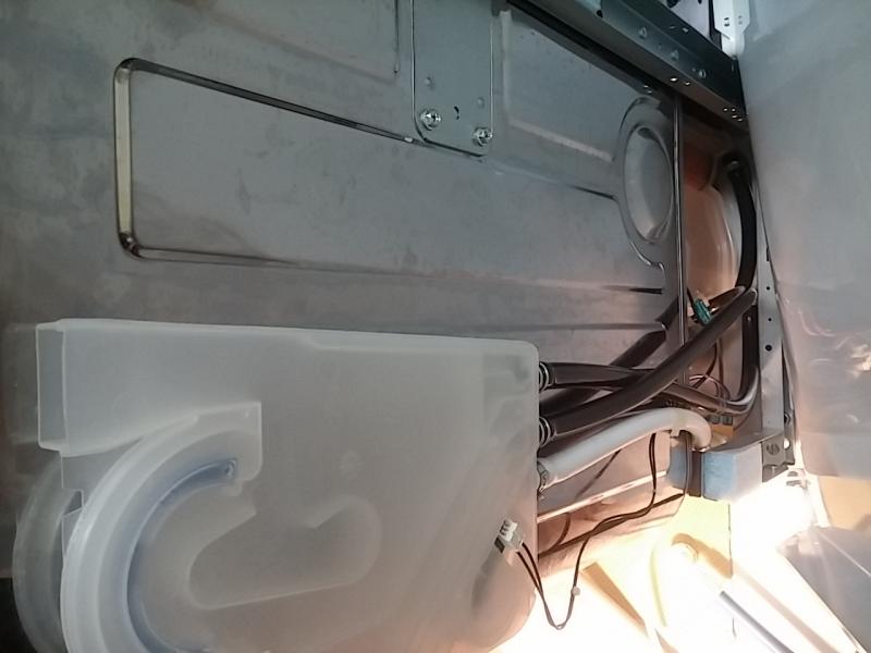

My dishwasher won't heat the water up, everything else seems to work fine though. I am considering attempting to replace the heating element. I couldn't find anything on the web regarding this job, or the correct replacement part, except that this model is sometimes rebranded as 'Haus'. Any ideas?

I took the back and top panel off and most of one side. Removing this side panel is tricky because the remaining screws holding it on are difficult to access as the bottom panel (small section under the door) is in the way. Maybe I will have to turn it upside down or on its side to remove this panel completely... Anyway, can you tell me which component is the heating element / thermostat / which part should I test? (To recap: the water doesn't heat up at all)

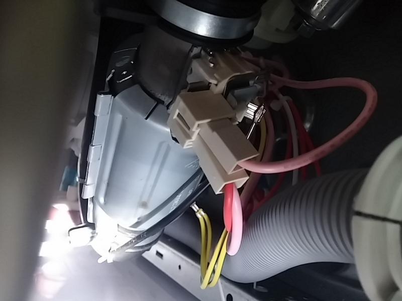

2nd photo is showing the circulation pump (the big white block with metal pump attached), can't actually see the heater but it must be further in but on the same side as the pump usually.
Try to get a photo of the left side more i.e where the 2 pink wires are that attach to the white disc sensor. Might be poss to id that part too then.

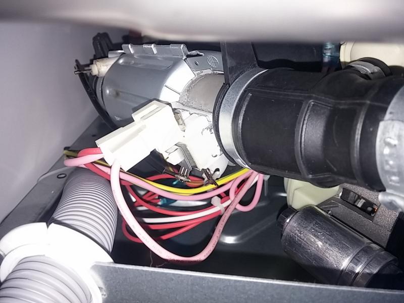

I am convinced the heater on your will look like a long cylindrical metal cased heater, looks a bit like an car exhaust silencer if that helps.

I transported it on its side. I'll get the panel off to get another picture, see if I can see the element as you describe.

Next it fills, you will see water coming in through the pipework in your 1st photo, after it finishes filling open the door and check the water level in the tub, how high is it? This is to check if too little or too much!

Yes thats the heater and the two pink wires that attach to a white disc, thats a pressure switch, one pink will go to the heater, correct? no water no pressure no heat.
Pressure switch could be faulty or stuck.
