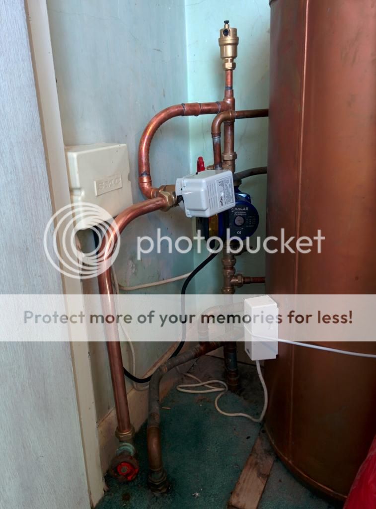

problem iflo 3 port valve install? help required please.
An auto air vent just above the tank.
Found the problem I somehow have overlooked putting the 3 port in wrong!.. :oops:
Thanks again for pointing it out.
That looks like an ACL drayton valve, if so its connected wrong
It doesn't matter which brand valve it is, it's been installed incorrectly.
For a start, the pump should be connected to the centre port!
Never seen one done like that before :lol: . I thought mixing up the "A" and "B" port was bad enough! (everyone has done that at least once, I'm sure!)
Haven't seen a TAM4 for a while now! Quite a job to change over now the relays etc are obsolete.
Strangely it seems better now! :oops:
I even took the valve out to check it worked OK, never put one in before but that's no excuse for not seeing the obvious, I knew which port went where, so think the brain must have gone to sleep!
Oh well won't do that again, that's for sure.
Thanks again for the advice.
