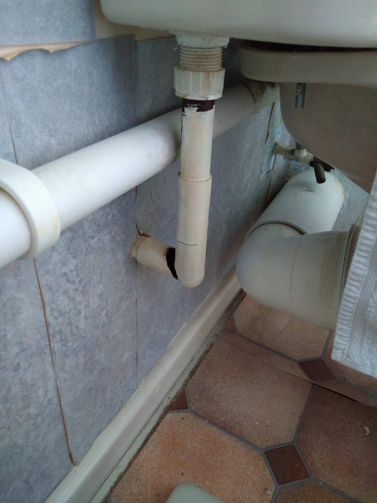

finally got it back together and no leaks so far, only flushed it once at the moment. Had to change the Torbeck fill valve to a Fluidmaster with a brass shank, which I had in reserve as trying to get 6" flexi tail to screw on to plastic one I got it cross threaded, only a short tail and it does not have a lot of movement. Fluidmaster was a tight fit on the cistern sides but finally got it working. Now the broken overflow pipe, see photo, if I get some new piping and 90 degree bend will I be able to hammer the pipe through from outside, on ground floor, and if I can get it out more to the point will I be able to push some new pipe through easily? OR could I get the remains of the old 90 degree bend off by heating with a hair drier to loosen the glue?

Depending on your skill set, you might be able to cut along the broken elbow lengthways and break with a thin screwdriver blade - I’ve done this several times with success.
Thanks terryplumb and CBW, have a Dudley Edge syphon, meant to mention this, I realise it has an internal overflow wanted to plug old one but the other half wanted a back up in case internal one did not work, not worth arguing with her! Will try to cut old bend lengthways and see if it will prise off as you suggest CBW. Thanks both.
