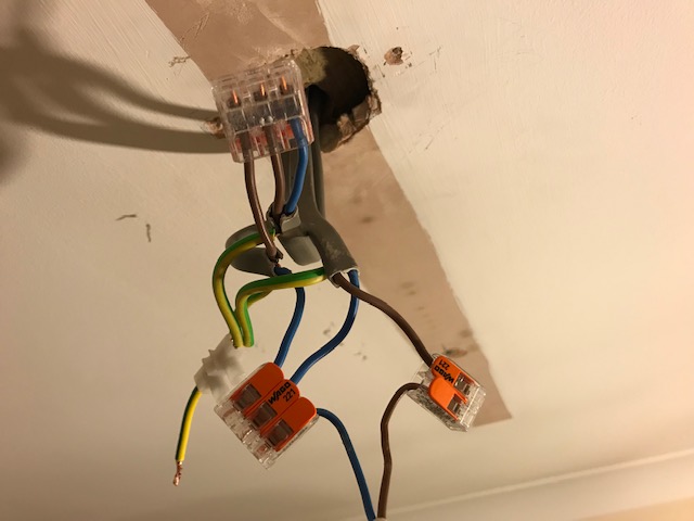

Hi
I changed a fluorescent light with another spot light but problem. The switch doesn't turn the light off.
The mcb controls 5 lights, this one am changing, another 3 plus another fluorescent light in garage. The 3 are working fine, garage light now stopped working.
I wired the new light same way as was the fluorescent. Pls see pic attached, I've put a ceiling rose now for testing.
What can I try? I tried diffrernt light switch, didn't help. Even if I remove brown wire form L1 on the switch, light still on. It's 1 gang 1 way.
have a look at the wiring here
cant see clearly - but it doesnt look the same - can you move out the 3 grey so we can see clearly where each blue/brown connects
looks like 1 grey has been connect to the 3 way - both blue and brown - maybe wrong - only have a small screen

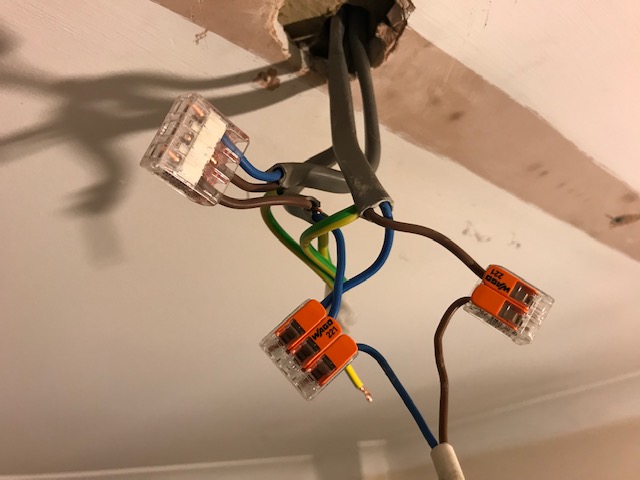

Another pic, hope is clearer
You have mixed up the switch cable with the permanent line and neutral.
as suspect you have 1 grey - blue - brown = both connected to the one connection block
have a look at the link i sent - shows how it should be cabled
you just need to identify the switch cable - .... power in -out
Thanks guys
I got in touch with the electrician who wired this part of the extension in 2006, with the aid of meter he identified the switch wires and from then on everything was wired. All working including garage light. Phew
