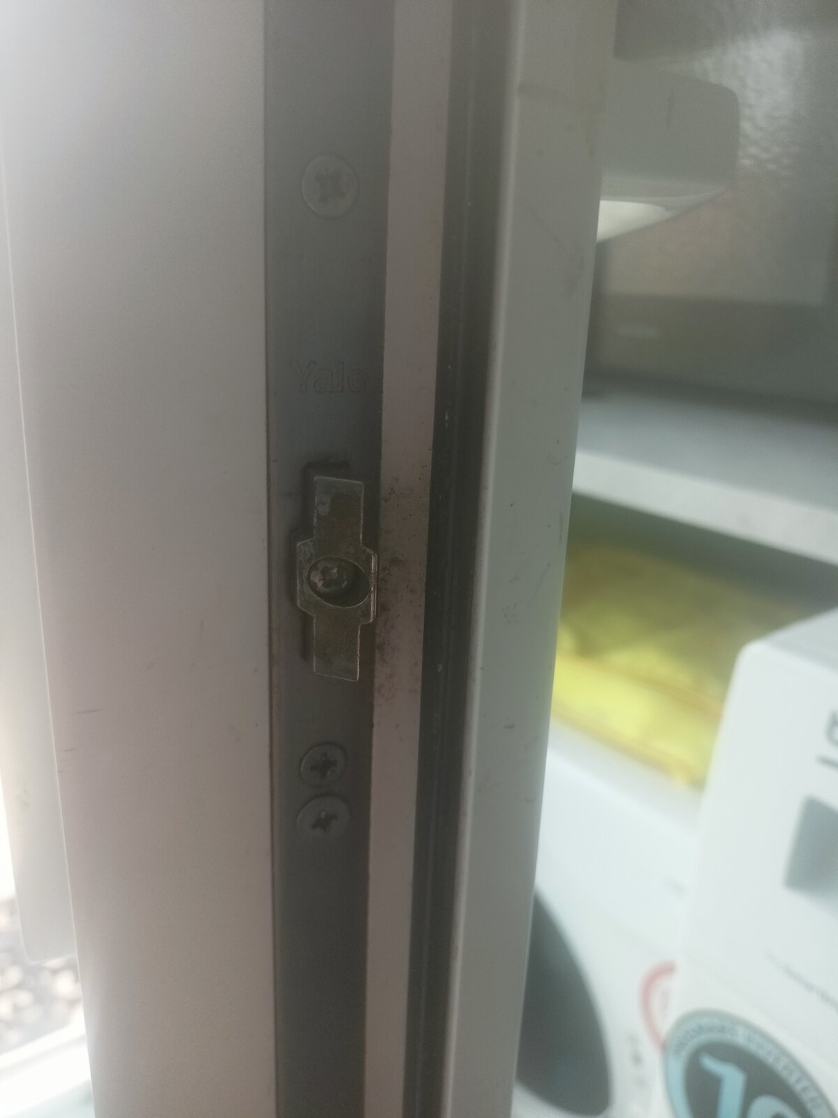

Hi everyone, all of a sudden the front door latch isn't working correctly, we have to lift the handle up to get it to stay closed, I've tried lubricating it with no success. I've attached a photo, it says Yale and has a screw in the middle, but no idea what that does
The front and the back door used to be exactly the same, so pull the leave down open the door that latch goes in release the handle and that latch comes out. You can then shut the door and it will stay shut until you push up and leave it down again, but on the front door that doesn’t work
Before ordering just check whether you have a deadbolt under the latch or a hook, if its a hook make sure you order the correct one, some hooks go up some go down
There's a shop locally that stock these, so I'll remove the old one and take it with me.
Job done, new mechanism, of course when I fitted it, by mistake I put the new mechanism inside the door, what you actually have to do is fit the mechanism to the strip where all the hooks are etc and make sure that everything lined up and works.

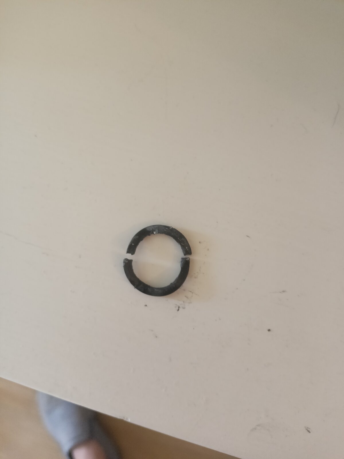

When I remove the door handle a washer fell out, it made the handle very loose I've replaced it with a rubber washer I presume that's right I did think about fiber but as it needs to slip into a groove I presume rubbers right I shall attach some
pictures
