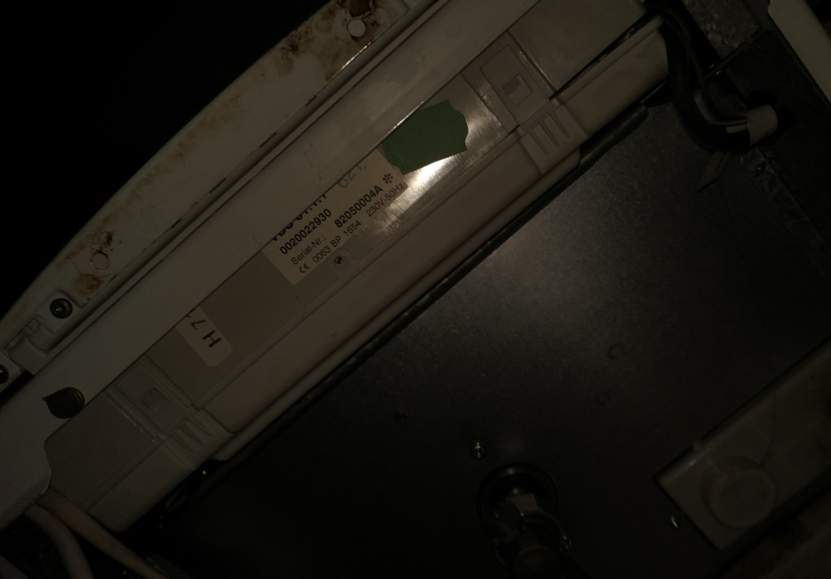

what ecotec have you got ??( full name ) , combi or system boiler
i
Vaillant Ecotec plus, I think it is a system boiler. I would suspect that the system water is quite sludged as it is old and has no magnetic trap etc.
The engineer is the engineer who fitted the boiler.
Would it benefit from a powerflush?
If so how often does that expose leaks and if it does leak who pays for the repair?
its like you asking me what car I've got and me replying a ford ;) look underneath the boiler for a label
Ecotec 418
