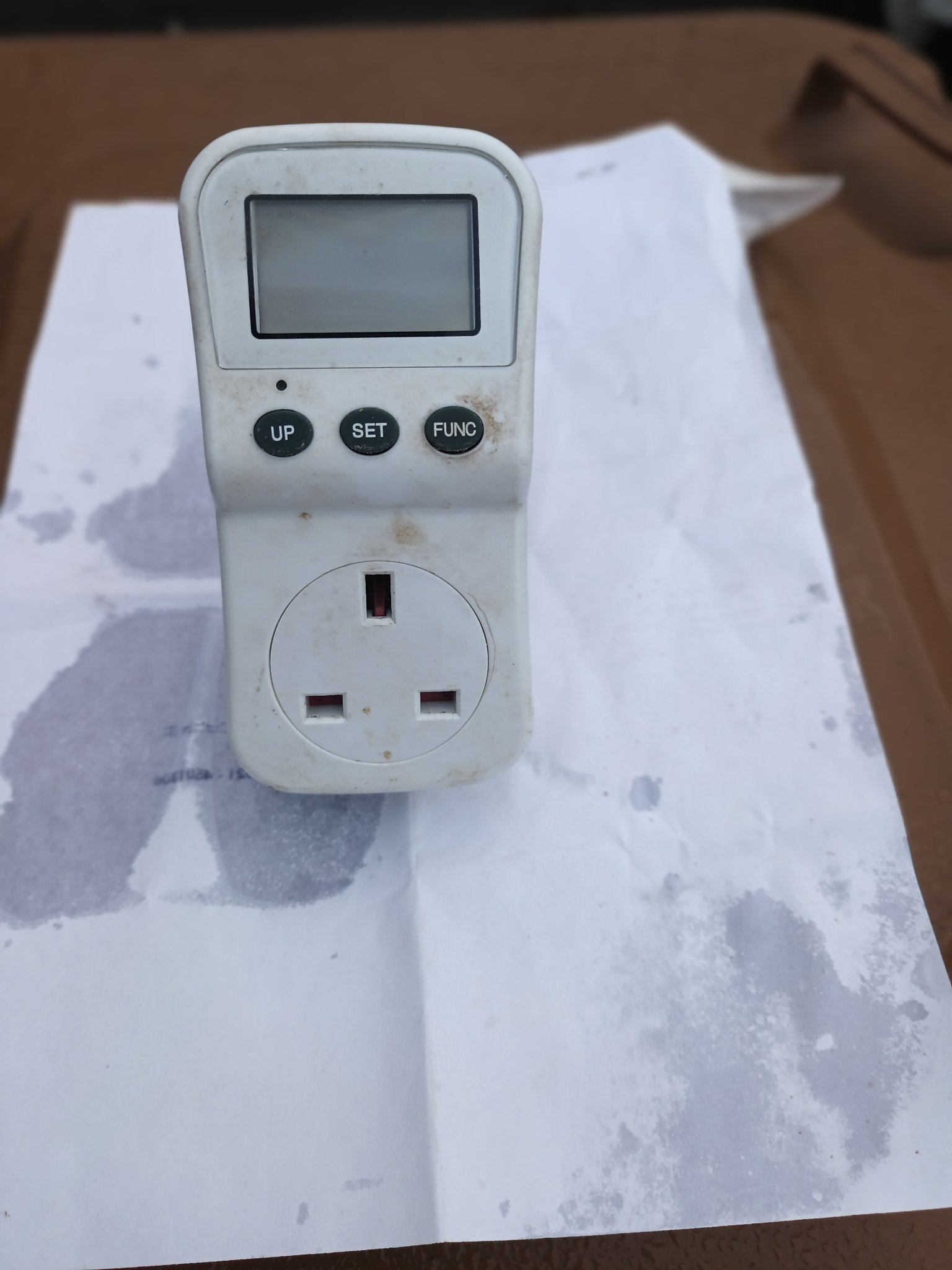

This Boiler has a Grundfos UPS3 pump?, if so, unfortunately, it doesn't display the power in watts like most A rated pumps now. The pump flowrate (if any) can then easily be derived from the pump curve or if the pump is defective or impeller vanes sludged up. If you have, or obtain a energy monitor like my one then you can read off the power in watts very accurately and from that and the pump curves rule the pump in/out.

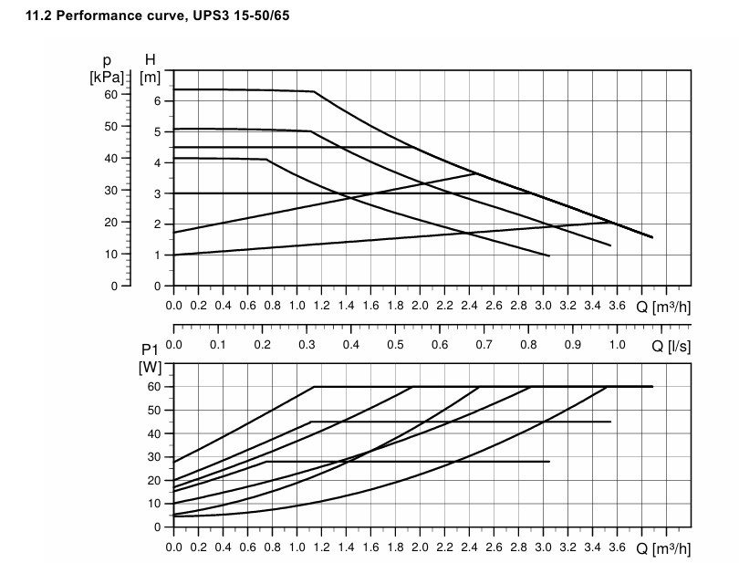

Sorry, I dont follow. Yes its UPS3 pump, and although its powered its difficult to know if its actually pumping. The manual gives the pump curves, but thats only if its working propery. Its on CC setting, so it shouldn't be varying according to demand.

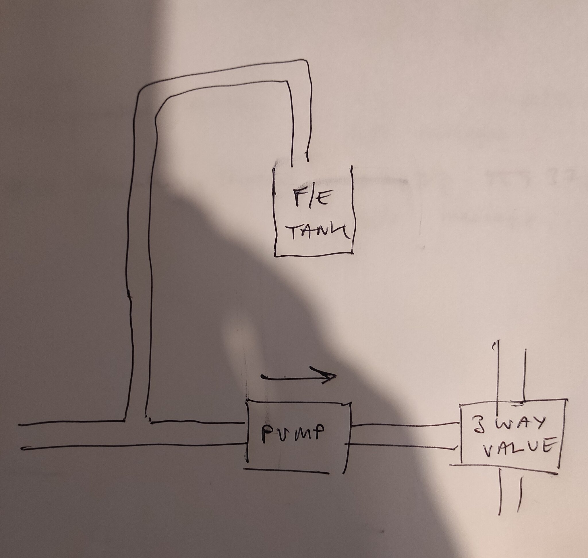

one odd thing. the vent which runs to the FE tank is on the boiler side of the pump ie the feed to the pump. but that means the pump can suck air in through that vent??
Edit: sorry that hasty sketch is misleading. There is feed also after vent so pump should take from there... assuming feed is clear. I did clean tank before refilling.

Yes, remove the pump cable cable from the terminal box, get a bit of cable and connect a socket to one end connect the other end to the terminals that you removed the pump cable from. Connect a a 3 pin plug to the end of the (now removed) pump cable, plug the energy monitor into the socket and plug the pump cable plug into the energy monitor. Start the boiler and I would suggest change the UPS3 to CC2, then start the boiler and read off the watts.
If the pump is OK but pumping against a full restriction the power will be 20watts, if its pumping say, 0.5m3/hr (8.3LPM), the power will be 30watts, if its pumping 0.8m3/hr (13.33LPM) the power will be 38watts, etc.
That pipe should be from the boiler flow (hot), the cold feed is then normally teed in after the vent but no more than 150mm from it, try and establish where the cold feed is, are you sure that the cold feed isn't teed in to the vent with a short bit of pipe from the F&E cistern, a combined vent and cold feed, like mine.
Its not combined. vent first then feed after about 120mm
