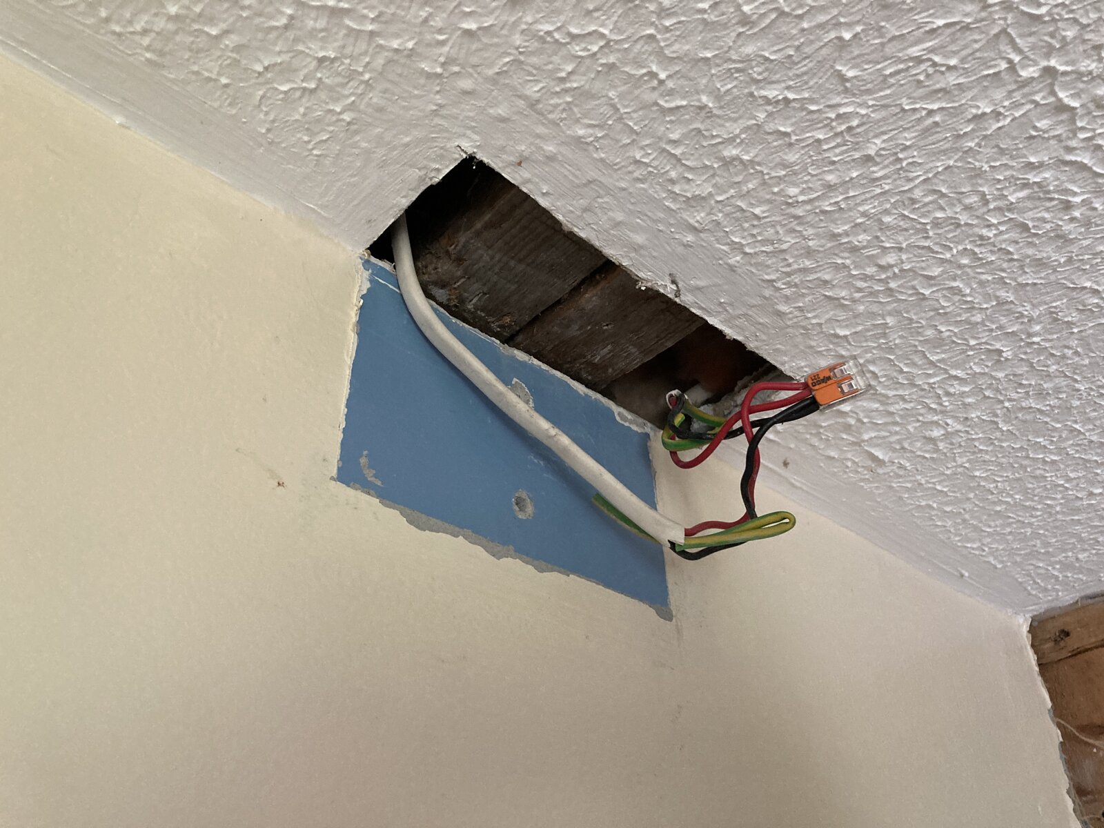

I would be grateful for a bit of help with my extractor fan which I have tried installing. I have a switch (not connected to light), which I had intended to just leave on as I have purchased one with a humidistat so would just switch itself off when the humidity drops. My old one had a separate humidistat/transformer as it was 12v- I have removed this and connected up the wiring using a wago connector. Therefore the only wires I have are a neutral and live.
I then came to wiring up my new fan and having tried connecting the live up with both the L and switched L terminals, it won't work. I have tried all the different settings on the fan itself and it definitely should be turning on. I have checked with my voltage pen and there is showing that the wiring is indeed 'live' when I turn the power back on after isolating.

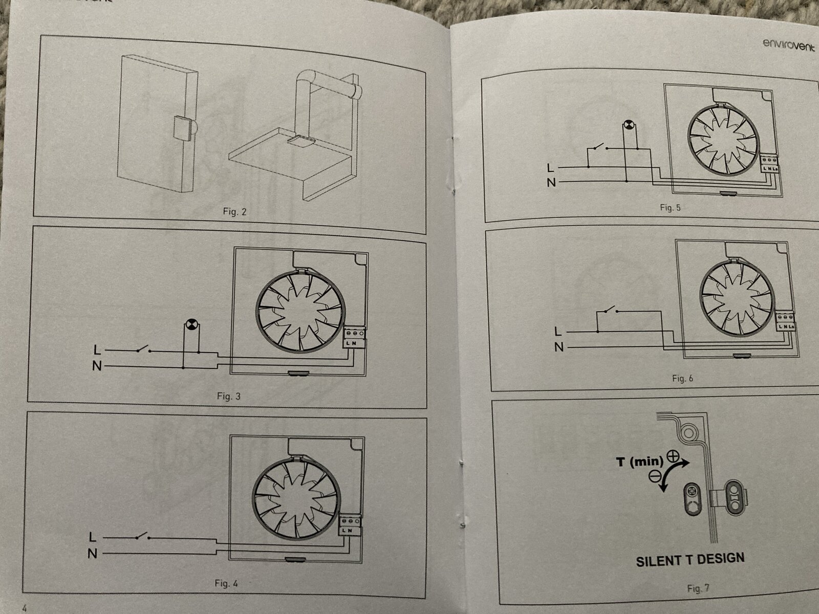

Is anyone able to advise what I might be doing wrong? I've attached a photo of the instructions as well and thought I was going with fig.4....

Wago connectors don't work like that. Only one wire goes into each port of the Wago and both ports are connected internally. So you need 3 Wago connectors. 1 for the red wires, another for the black wires and a third for the green/yellow wires.
You have connected live to neutral. This will have blown a fuse or tripped an mcb.
Thanks! Feel like a bit of a numpty. First time using wago connectors as you can probably tell. All sorted and working now.
That'ts ok. We all have to learn. Your Wago connectors should not be left dangling loose above the ceiling. They must go in a Wago box.

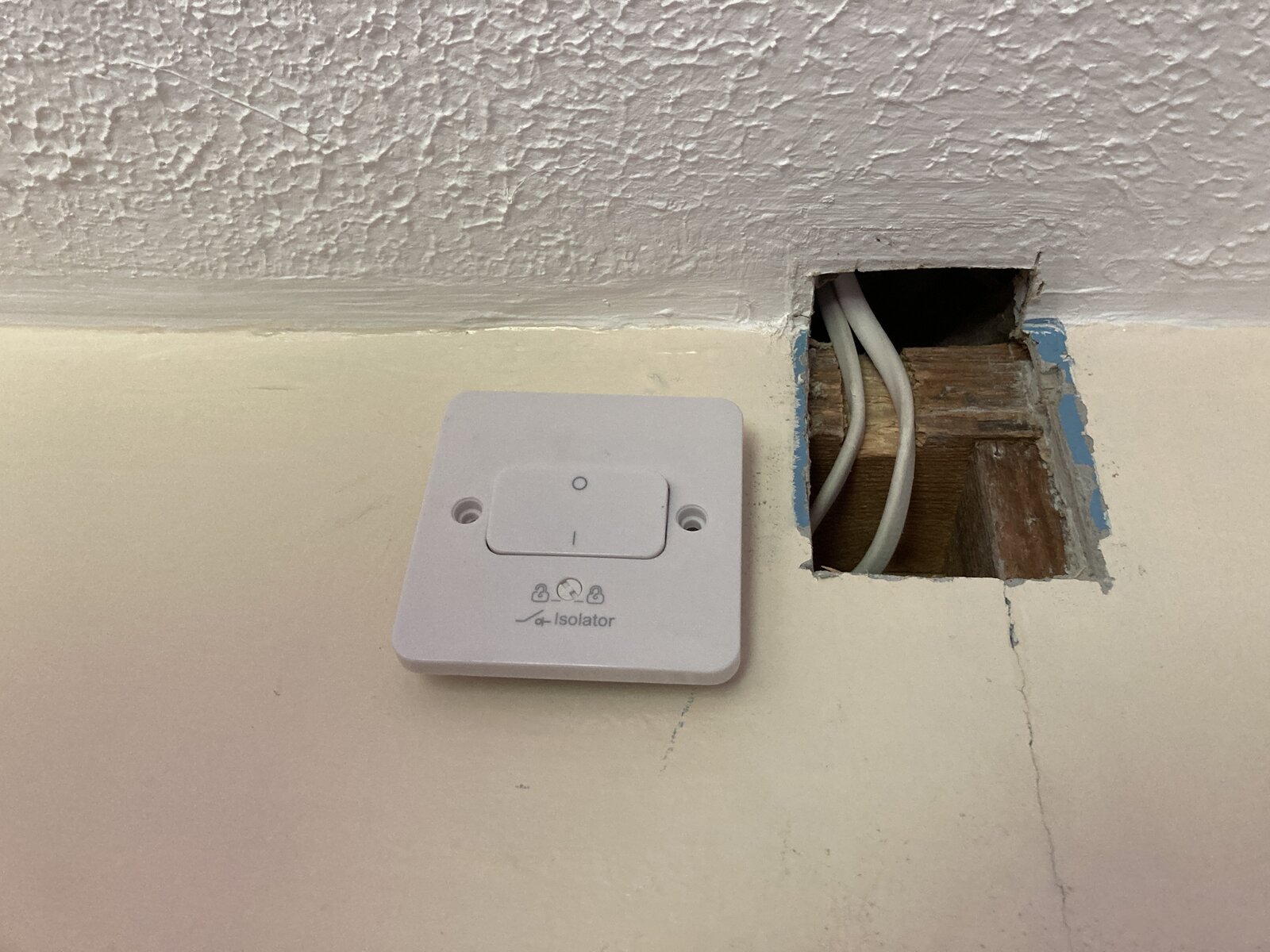

In your second photo, where is that white cable going to be routed when you put the plasterboard back?
Right understood. Didn’t know that either so will buy a junction box. As for the cable- good question. I was thinking about notching into stud work below and routing it there? Open to suggestions…

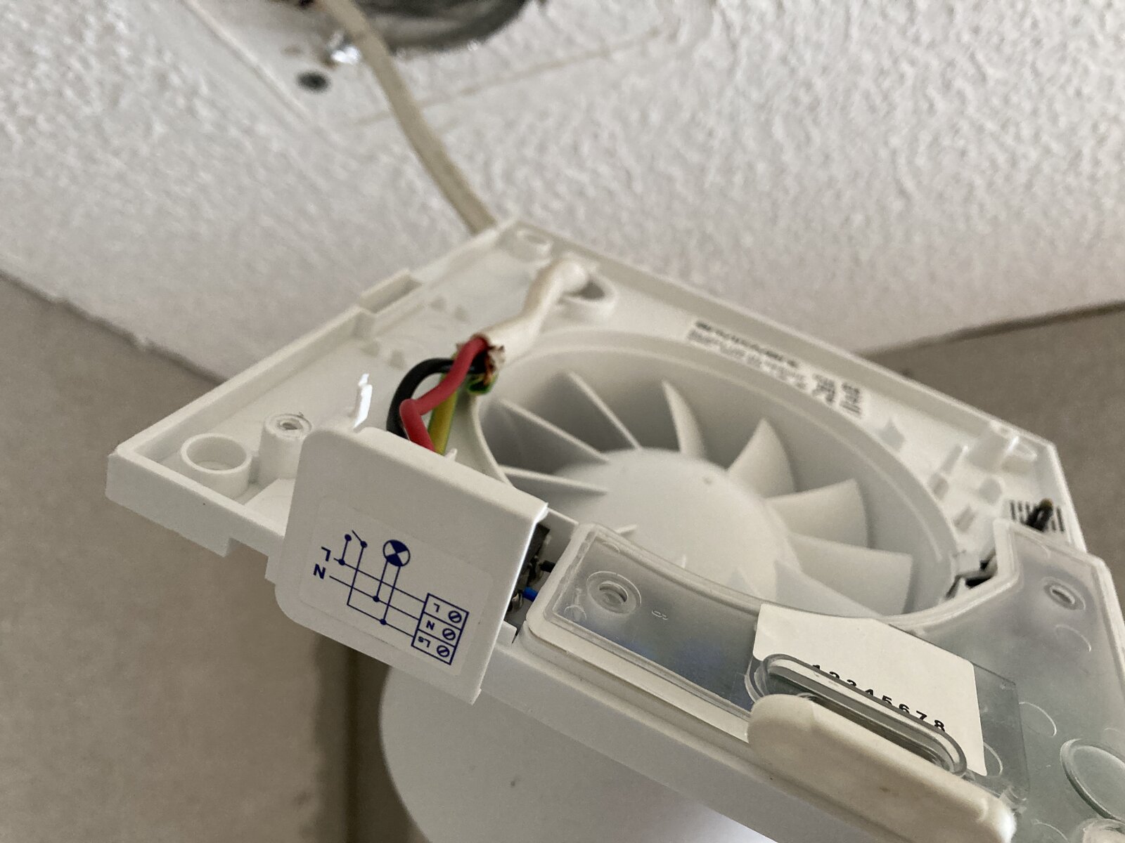

Only issue I have with the fan now is that it is permanently on which I can’t figure out as I have the settings on for humidity and definitely shouldn’t be triggering presently. Will have to keep fiddling with the settings.

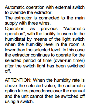

I've attached the instructions- so it does comment on the setting one can use to switch it on if the humidity levels are permanently low. It is an Envirovent SILDES100HT.

Mmmm. It does say that.
Have you set all the dip switches correctly - if you have to.
In instructions I have found, later on it states:
I see it says that at the end of the page you posted.
Yes I have- they are all in the 'off' position which should mean that the fan only operates if humidity is over 90%.

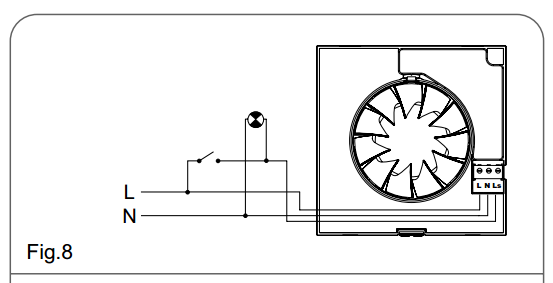

I saw that bit, and just thought in my case as I don't have a switched live it would operate as per the other section of the manual.
Figure 8 is the normal set up, but is described rather strangely.
It's not really overriding the thermostat when humidity is low; but the humidistat independently operating the fan (whether switched on or not) when humidity is high.

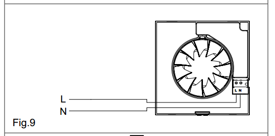

You will note that Figure 9 only shows two terminals, L & N.
Could it be that there are two types of fan and you have the three terminal one.
That doesn't make sense but I can think of nothing else.
