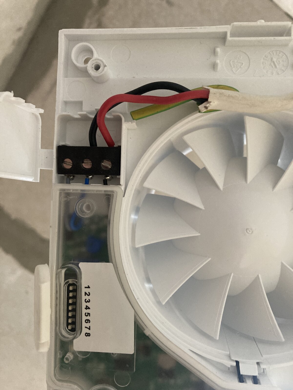

I took a live from the upstairs ring.
The fan had a connection for a perm live, a switched live and a neutral.
I ran the live in to a fused spur unit. From there I branched two lives. One became the switched live (via a switch) the other live runs directly to the fan and acts as the perm live.
That was 12 years ago, it works as it should. I do not understand why you think there is something wrong with that. Whilst not wanting to disagree with someone whose advice I respect.
I have a Silent 100HT.
...this thread is a bit confusing to me, so I'm worried it is also confusing @drives.
From what I can make out, the OP has a switched Live and Neutral at the fan.
They are happy to keep the switch turned on, to allow the fan to work automatically from the humidistat.
If this is the case, the wiring should match fig. 9
The OPs Switched Live can connect to the L of the fan, there doesn't need to be a link between L and Ls
The 100HT has three terminals, fig. 9 is purely (lazily?) using the 2 terminal diagram for its Silent 100 model (maybe for simplicity, or clarity :unsure: ).

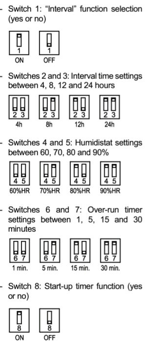

The switch settings on the instructions are also a little confusing, being shown in two different forms:
If, the fan is to be used in a more conventional way, the wiring will need to be modified to match fig. 8

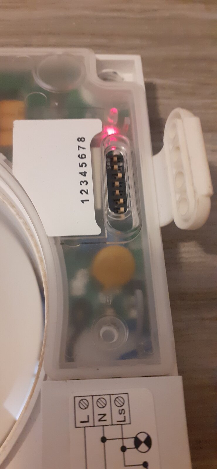

Thanks for this- definitely a bit confusing in parts but all massively helpful and have got my head around a few basics as a result of advice received. I can confirm I have the switched live and N at the fan. The fig.9 wiring is what I have done. I've attached a photo and as you can see all the switches are off which by my reckoning means the fan should only be coming on if the humidity is 90% or over. I turn it on via the switch and it keeps running.
So from what you say, my fan should be wired up correctly? To confirm, the rH in the room presently is 29-30 measured by a portable humidistat which is what I'd expect as the room is currently not being used/being renovated, and is well ventilated as half the partition walls are missing :)
The instructions are definitely not the best...

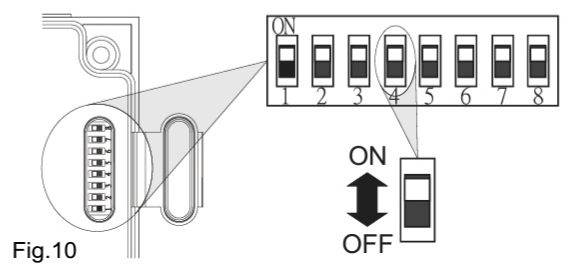

I have just figured this out with the help of envirovent and of course user error! So...I thought my switch settings meant it was at 90% humidity but it was actually 60%. Therefore if I turn it up to 90% by pushing the switches at 4 and 5 to the up/on position, this sorts it. The manual is so confusing...
I have to say the Envirovent tech support line were really good/quick at answering, and helping. I guess my standalone humidity sensor is massively inaccurate

Sorry, I was just about to post! - it's the small squares (that represent the switch position) in the picture that you should be looking at.
Here's my settings for 90% humidity, a run-on and a start-up timer...
