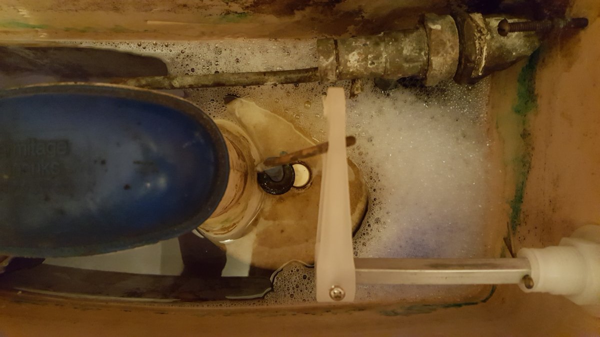

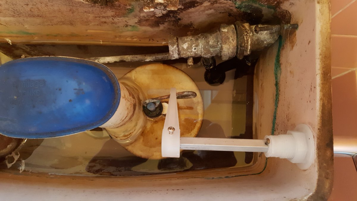

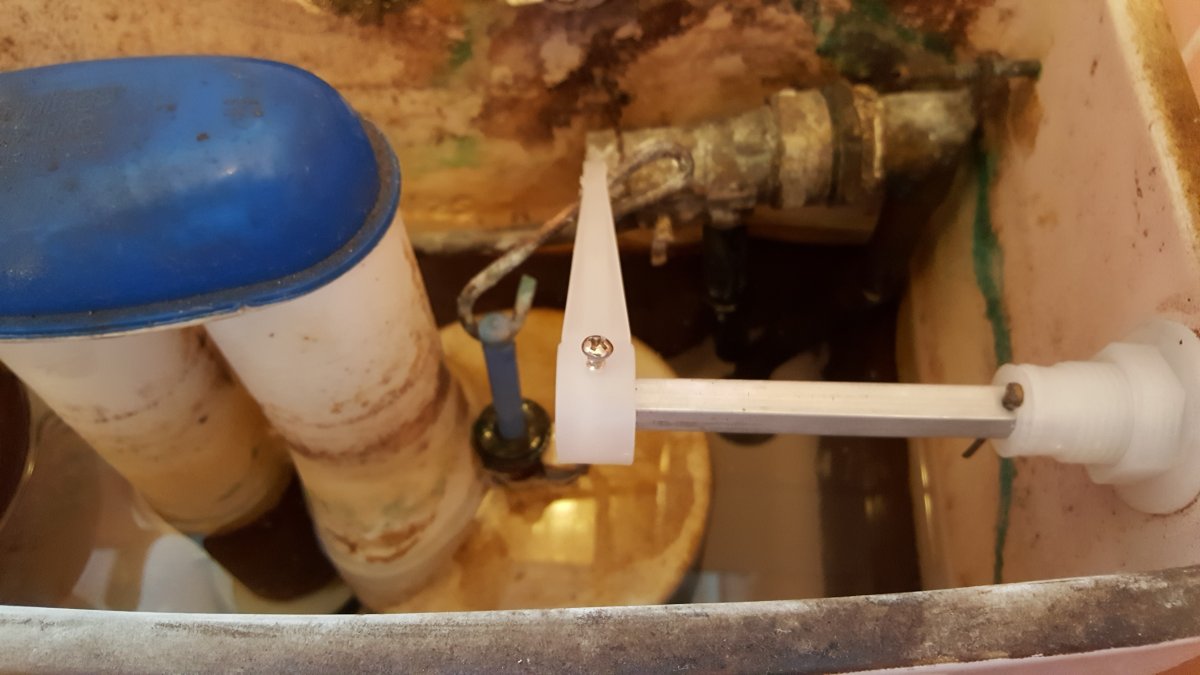

Hi folks,
A few months back the rod the arm's attached to snapped and I replaced with the closest length I could find to the original.
However, I'm now finding the arm doesn't return to it's correct position after a flush (e.g. the handle is still down) which means the flush mechanism isn't resetting for the next flush. It looks like the arm 'sticking' on the C hook.
I've attached a couple of photos below, would someone be kind enough to advise, do I need a longer rod, different arm/lever, C hook or?
The current rod (including plastic fitting) extends 120mm into the cistern and the flush lift rod is 140mm from same cistern edge.
While I don't mind giving the handle a a bit of a wiggle to sort it out there is a certain lady of the house who is scream blue murder the toilet is broken.
Photos, 1. before flush; 2. at flush; 3. post flush
Simon
The arm is still a bit on the short side.....ideally it needs to be in line with the blue post that causes the diaphragm inside to be lifted as vertically as possible.
John :)

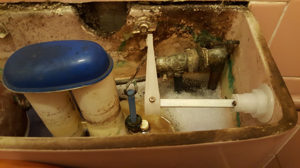

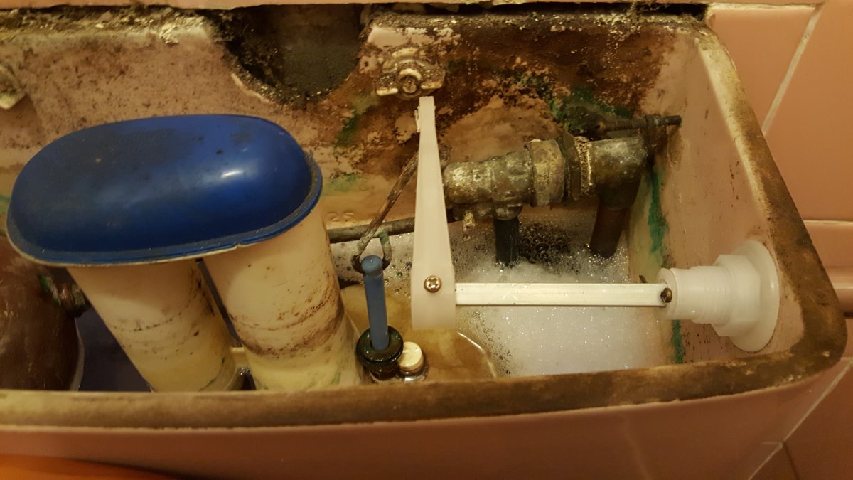

I wasn't suggesting a shorter C link @eviltoad, you need to get the top loop of the link through the hole in the plastic arm so it can hinge properly. At the moment it's tight against the straight bar part of the link so it will not allow it to move properly
@Madrab I'm with you now. Right it's in the top of the loop and so far ( half a dozen flushes) it flushes fine each time. Only thing left to resolve is to get the handle/blue rod to reset after the flush to the correct position. It's almost as if there is friction somewhere preventing this. Is this something obvious or am I looking at replacing a part for this matter?
Pretty sure if you can get the blue rod, C clip and handle in a near vertical plane that'll be cured.....I think the blue rod is being pulled over at an angle.
You can test by disconnecting the handle and just pulling the C clip up...it'll reset every time.
John :)
@Burnerman. That seems to be the case.
So the blue rod is 140mm from the right internal edge of the cistern.
So to position that right I'm looking for a 140mm (internal to cistern) handle/bar - as reference that would be a 193mm (not 173mm) total length based on the one from Wickes.
I'm guessing as the with plastic arm would be over the blue rod I'll need a shorter C - Hook as well.

Yep, there's a bit of suck-it-and-see with these, but a longer square rod is the way to start, anyway. Sometimes you can rotate the rod on the plastic lever to give you a more positive press, if you like but occasionally the lever then clunks on the underside of the cistern lid!
Good luck with it
John :)
To be honest that should work ok now. The return is controlled by a spring internal to the syphon above the diaphragm and when the syphon action of the flush is broken by the air entering the bottom then the spring should push the diaphragm back down and therefore the lever backup. Either of these may be getting tired and the angle is compounding the issue, though for £6 then it's a no brainer replacement.
You can bend the C link in the middle to shorten it if needed.
Or OP could try to gently heat the white plastic leaver with an electric hot air blower gun and when it starts to feel soft pliable, bend it towards the plunger rod (blue) and allow it to cool in that position, so you reform its shape with heat. This would make it sit more closer to the top of the rod, worth a try and if it doesn't work still get a new longer length handle.
