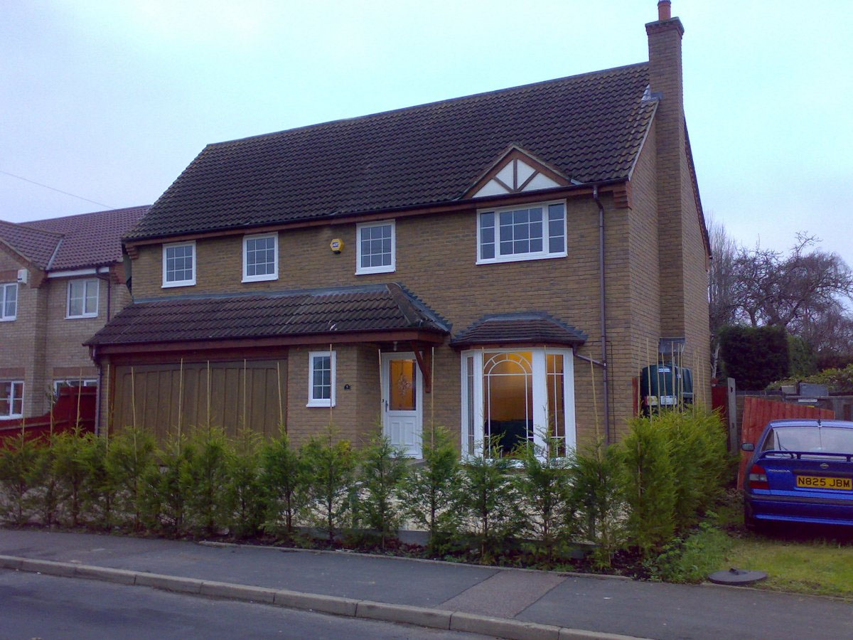

We currently have a detached home with an attached garage (Please see pictures). Above the garage is a bedroom but the eaves in it make it almost uninhabitable. So we've put in planning permission to build this room to a full height (like the others) which means the roof will match the existing roofline.
Planning have come back and said we are not allowed to match the existing roof height! They want it stepped down by a meter. The reason given is:
Currently the proposed development is considered by virtue of its scale, design, appearance of bulk and impact on neighbour amenity, to create a visually intrusive and dominant form of development within the street scene.
None of the neighbours have a problem with it and are willing to sign a letter/petition to say so. Furthermore, everyone agrees that it would look better if the roofline were matched to the existing height.
Am I going crazy here? Can someone please offer up their opinion and better still, can someone please chime in with some help as to how we can fight this?

You will more than likely find in the Local Plan guidance that it will say side extensions should be subservient to the existing dwelling which typically means the front wall is stepped back and the roof lower so they are following their own guidance. And your designer should have warned you that they would likely take this stance. So if he didn’t get a refund. Was the bedroom not like that when you bought the house?

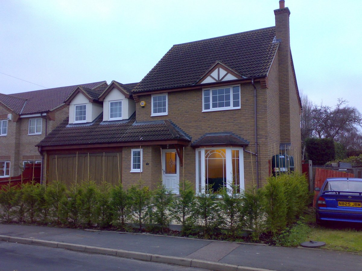

Thanks for doing that mock-up Nakajo! I think it looks great!
freddiemercurystwin - thanks for the input, the designer did say it was a possibility and yes, the house was already that shape when we bought it. The houses to the left were built some time after this one. The reason for the shape of the roof as it is was because Planners kicked up a fuss at the time of initial application (again, because they felt it would look better :whistle::unsure:). Not sure it would look all that great with the roof height being lowered by 1 meter on one side of the house, especially if you consider that the pitch will not be the same as the existing roof pitch. Plus, it causes extra maintenance issues in the future for me as it will need flashing to adjoin to the house (which we already have thanks to the existing roof design, that requires maintenance every few years) . Having one straight roof just makes more sense to me.
To set the proposed (raised) ridge down 1m from the existing ridge would mean the front at first floor level would be set back considerably from the main frontage - if the roof slopes were to be the same - which they should, otherwise it would look naff.
I doubt they will stipulate a 1m difference in ridge height in their policy guidelines, probably just that the extension ridge should be 'lower'
than the main ridge. You need to consider an appeal.

very true, move the front wall of the new room back and re pitch the roof off of that after all they are currently only two boxy dormers, whilst the absolute dimensions will be smaller you will still have more usable space
