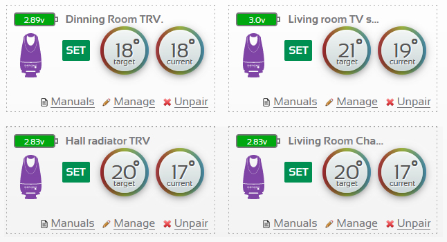

1} Setting the lock shield valve is easier once the programmable TRV is fitted. 4 TRVs-1.jpg Many programmable TRV heads tell you the current and target, and if the current is above the target, then the lock shield needs closing a little so it does not over shoot.

I tried with Energenie to start with. The PC and Phone show the target and current, Flat Battery TRV.jpg so if current exceeds target then the lock shield is open too wide, adjusting the lock shield, so current does not exceed target, and I found it was within 0.5°C if setting. But the wall thermostat needed turning right up, so the boiler did not turn off.
