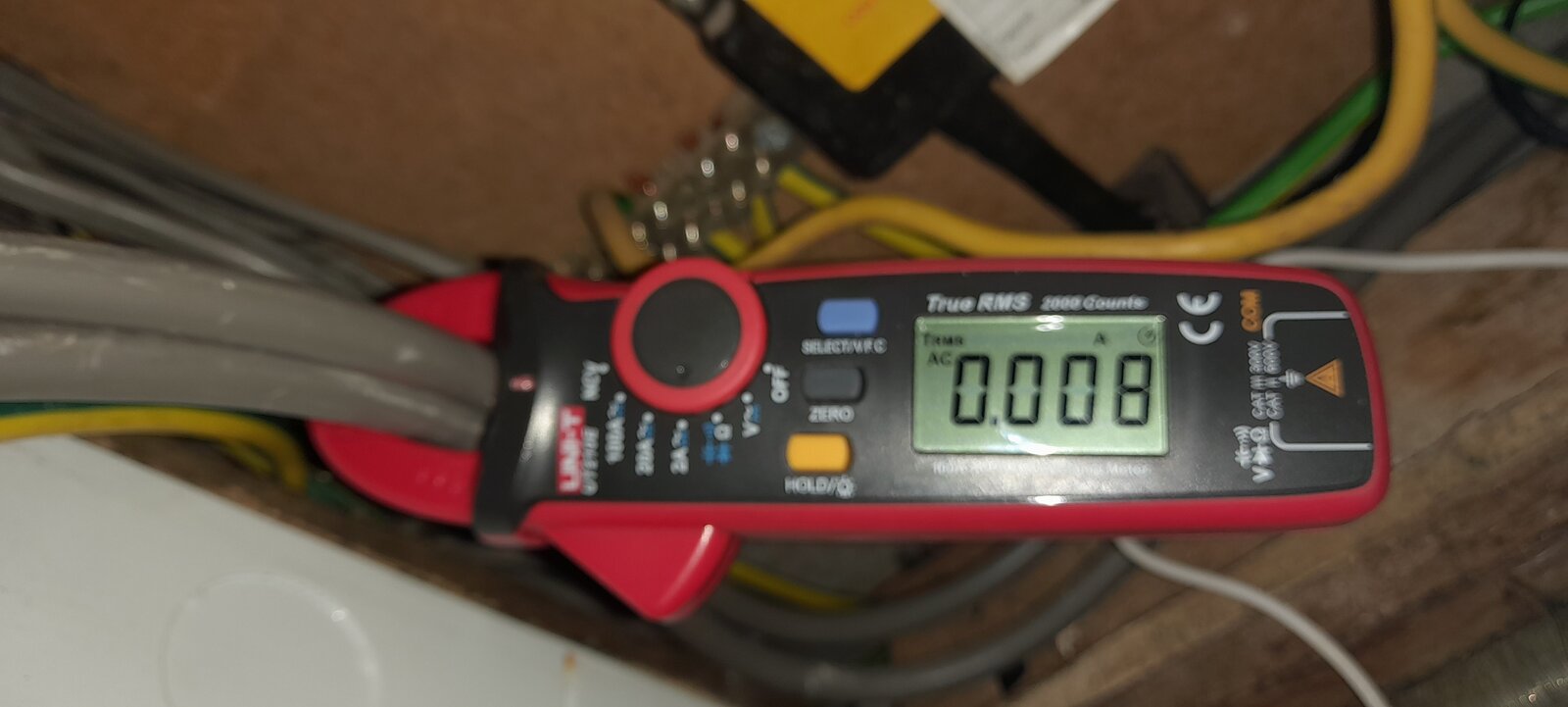

one sees as a professional tool, but it will not measure DC amps, there are specials Ethos for example designed to read down to 1 mA to test earth leakage, but the name is not well known, and the Diffrence line neutral 8 Feb 24.jpg UT210E from UNI-T will measure DC amps and down to 1 mA for a fraction of the price, so is it worth buying the professional models anymore?

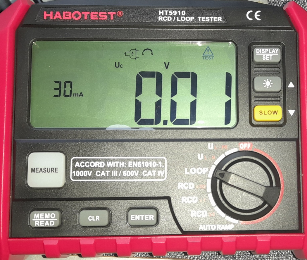

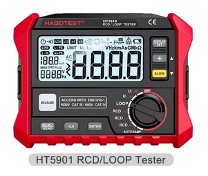

Then I saw this 1731154398386.png meter for around £70, and this one will show 1.4Ω or 1.3Ω etc, so actually know if within the limits, and it tests 10, 30, 100, 300, and 500 mA RCD's at full or half, or ramp, it does not have the type A or AC settings found with pro meters, and it is unlikely to ever be calibrated. So as an electrician I could not really use one of these to enter the results in a certificate, but DIY wise it is so much better to the Martindale plug in tester.

But with other tools, the situation is different, my loop impedance meter, and RCD tester died some years ago. So I was looking at a plug in socket tester now retired, as don't use it much, so good quality Martindale View attachment 362181£60 however it passes items at 1.7Ω and the pass point for a B32 MCB/RCBO as used with a ring final is 1.38Ω and as to the RCD test, god knows what it passes. So I thought look out for a second hand tester, but even second hand expensive.
Then I saw this View attachment 362182 meter for around £70, and this one will show 1.4Ω or 1.3Ω etc, so actually know if within the limits, and it tests 10, 30, 100, 300, and 500 mA RCD's at full or half, or ramp, it does not have the type A or AC settings found with pro meters, and it is unlikely to ever be calibrated. So as an electrician I could not really use one of these to enter the results in a certificate, but DIY wise it is so much better to the Martindale plug in tester.
