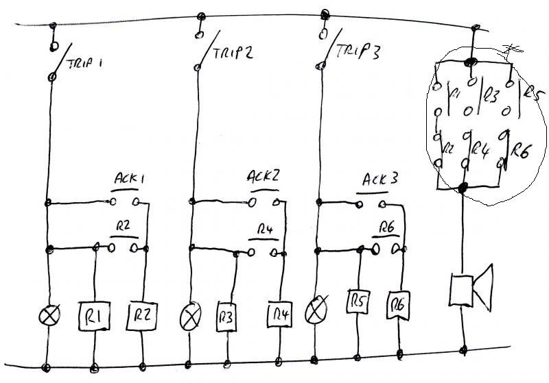

This one seems the more simpler one but im still confused with your drawing... Can you explain a bit more please. How many relays in total are needed for your design and does it allow for the fload switch?

Mine was assuming that the remote unit is to remain latched irrespective of a change in the fault condition and that it can only be reset at the unit.
I was trying to do it with a single silence and reset buttons rather than 1 per circuit.
In my drawing there are 6 relays labelled R1 through to R6.
The float switch is just wired as any of the trips, i.e. use trip 3 if you like. When trip 3 closes the lamp will illuminate and R5 will energise. The contact for R5 will cause the sounder to alarm via the normally closed contact R6. When the acknowledge 3 button is pressed, R6 will energise and retain. This causes the sounder to silence as the normally closed contact will now be open. The lamp will remain on.
When trip 3 opens again (i.e. the water goes below high level) the lamp will go off, R5 and R6 de-energize and the system goes back into ready state.
When trip 3 is activated and silenced, either of the other two trips operating will cause the alarm to sound again i.e. ack3 does not inhibit the sounder function of either of the other two alarms, you will need to press ack for the relevant alarm.

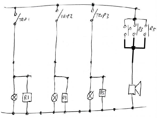

Does the relay count go down if there is no alarm silence button?
Yes, you can get away with 3 relays.
Rob gave a method for this in the second post, you could drop down to SPST relays and put the lamps across the coils instead if you wanted. Use the contacts in parallel for the buzzer.
(I have left the relay numbers as 1, 3 and 5 as am using another PC so just used the DIYnot editor, in reality you'd number them 1, 2 and 3)
I also edited the original pic to put some missing links into the relay logic :oops:

In this version you say there are 6 relays but what is the part what i have circled?
Wire everything back to its own pin on an arduino, and then you can come up with as many torturous designs for how it fits together as you like. Big transistor to drive the sounder, same for LED's if you're using superbrights or ones that want to be driven at 24v or whatever.
Those are the relay contacts, there should be two vertical lines in there too. See the edited drawing on page 2.
R1 is a Normally Open contact, R2 is Normally Closed.
R3 NO, R4 NC, R5 NO, R6 NC.
