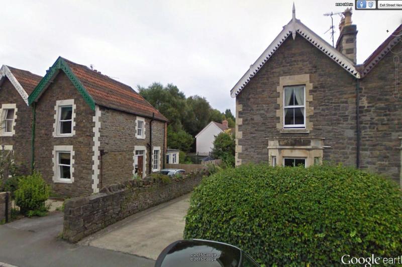

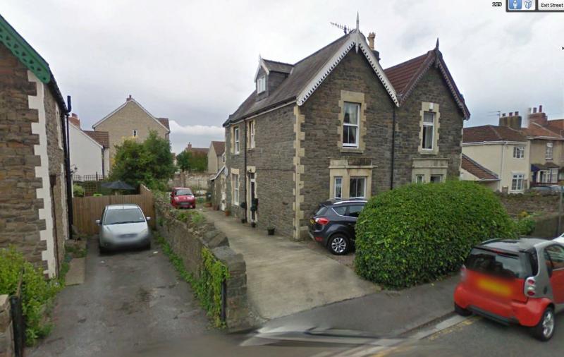

Hi thanks for your reply.
I have attached a couple of photos to show the view from the street. (my house is on the left hand side.
Mark
Personally, I would say that the elevation facing the road would be the 'principal elevation', on the grounds that the elevation facing the house across the path looks more 'workaday', including the downpipe and lean-to at the back.
There is also the attractive bay window and decorative barge boards on road- facade.
But that's just my opinion. There are a number of appeal decisions on this question, and it could go either way. If you did appeal, it ultimately depends on how a Planning Inspector would see it.
