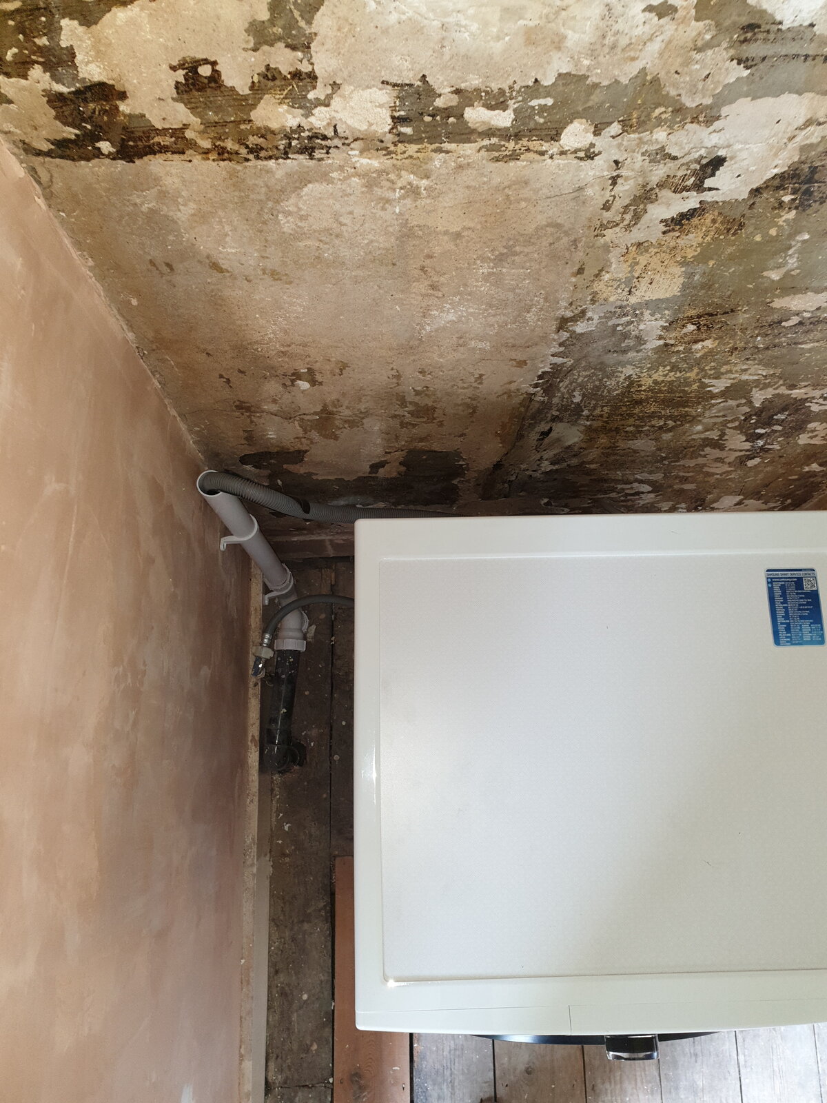

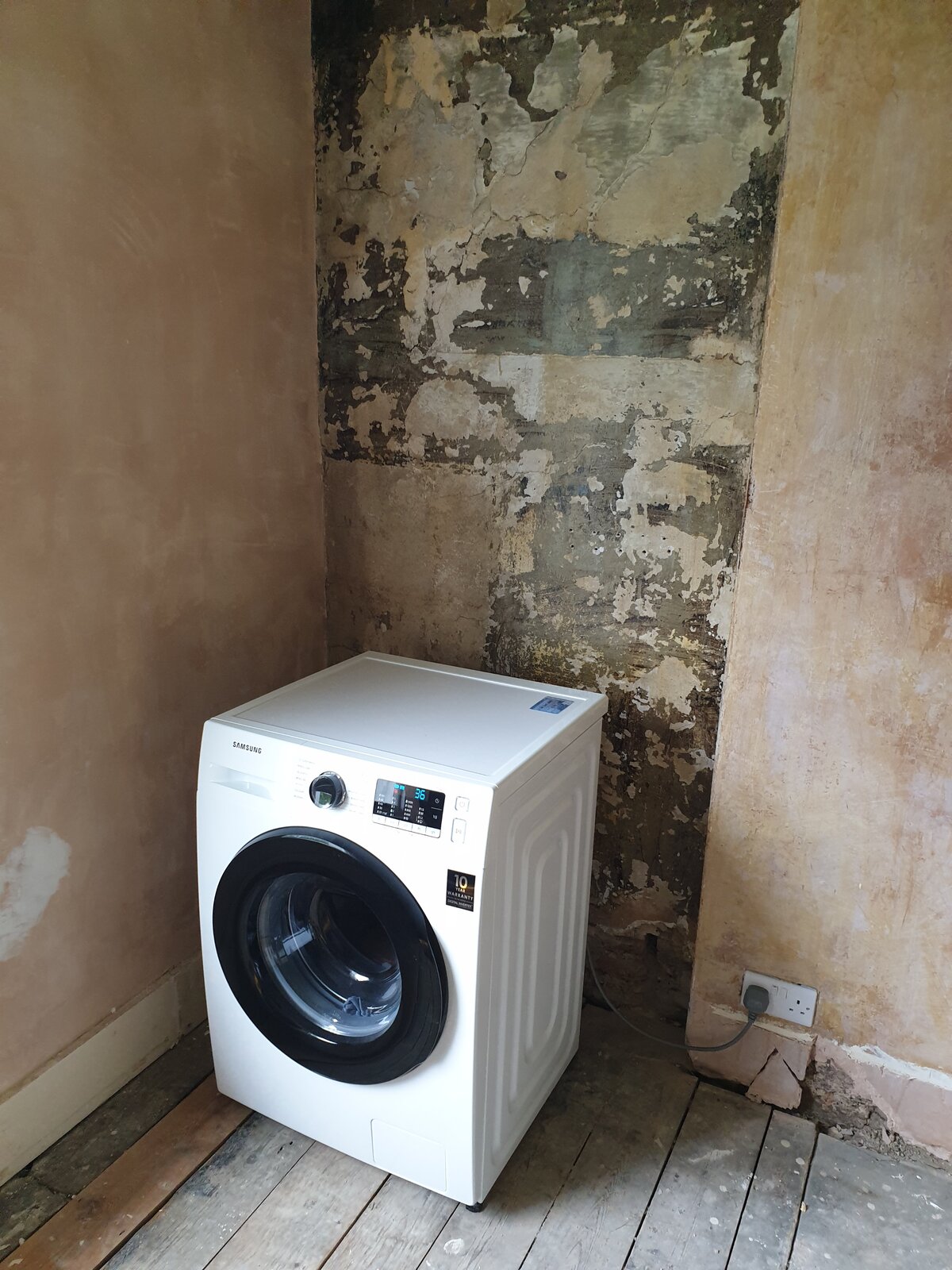

I will have the builders soon replacing floorboards with plywood and laying engineered wood on top. The washing machine will be concealed in a corner cupboard with a row of built-in Ikea Pax wardrobes right next to it along the wall.
What is the best way to isolate the washing machine, so that any leak either from it, or the cold water and waste pipes, wouldn't spread all around along that plywood/hardwood?

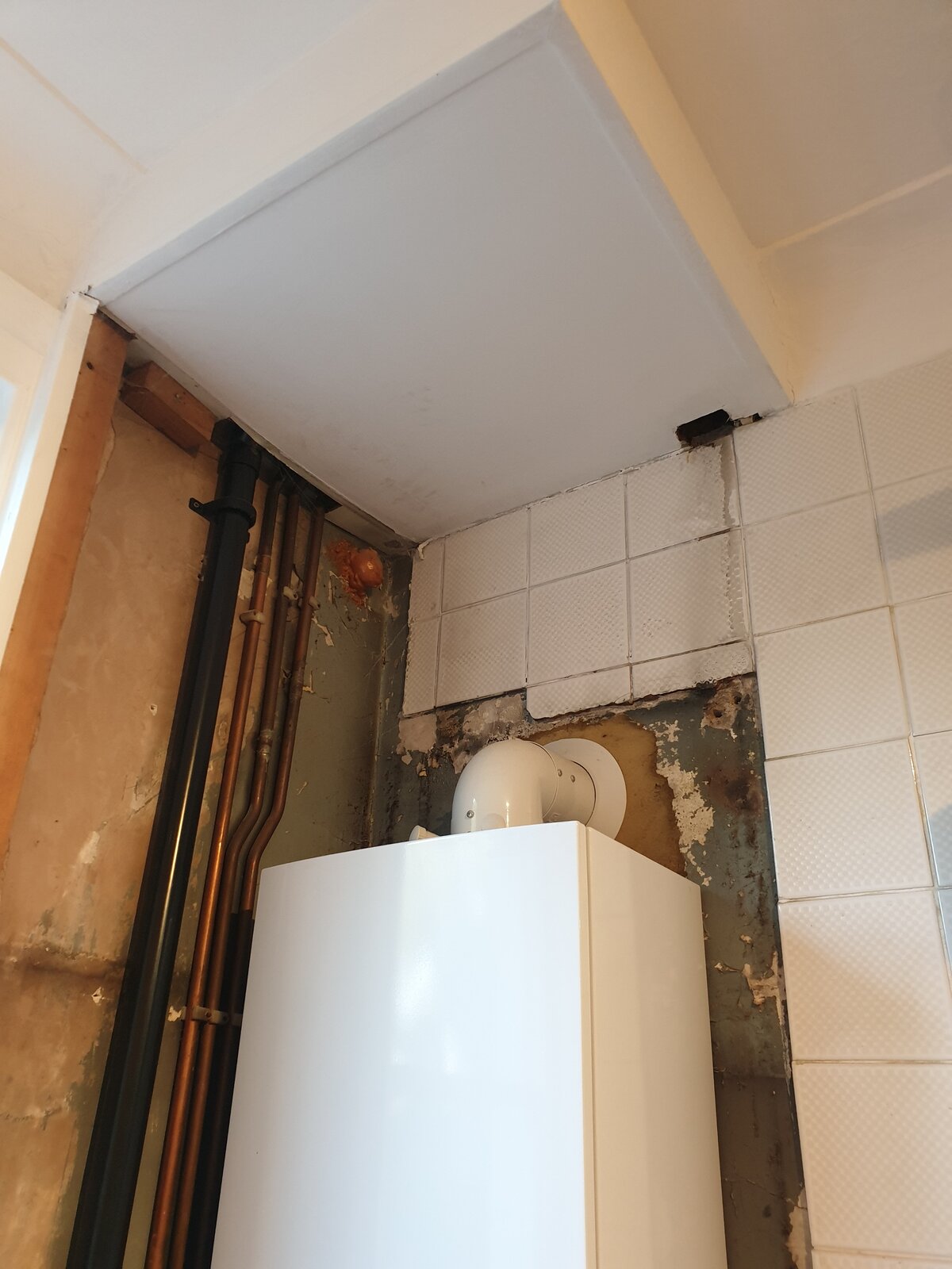

What is under this floor?
Wooden joists under the floorboards. One floor below there is kitchen with a boiler in the corner. I want them to reinforce the floor as well just in case as I'm going to stack a dryer on top of the washing machine – a bit concerned about the total load right above the boiler.

If you are that concerned install the washing machine in a bund to capture any overflows. They actually sell these in the USA, but basically they are just a shallow shower tray, sized to fit a washing machine, with a low point and a drain in one corner which gets connected to the waste water pipe. They are actually mandated by code in timber built apartment structures in somd states (although many apartmemt buildings have communal laundry rooms which side steps the need). I think they are called "flood savers", but it's 20 years since I was over there and I really can't remember exactly what the generic term is for them. It should be possible to build something like this in plywood, tanked and finished in tile.
@JobAndKnock thanks, I've found some of these trays online following your advice. Debating now whether I need a drain in it or not, as I'm not so keen on cutting into the existing pipe that proved to be working well...
