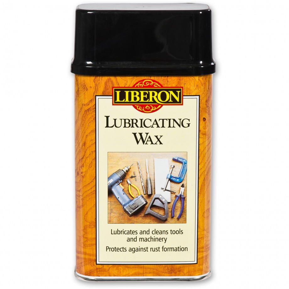

I use liberon lubricating wax on all my ferrous tools. I last coated my band saw table which is cast, last spring and it's showing no sign of rust yet.
