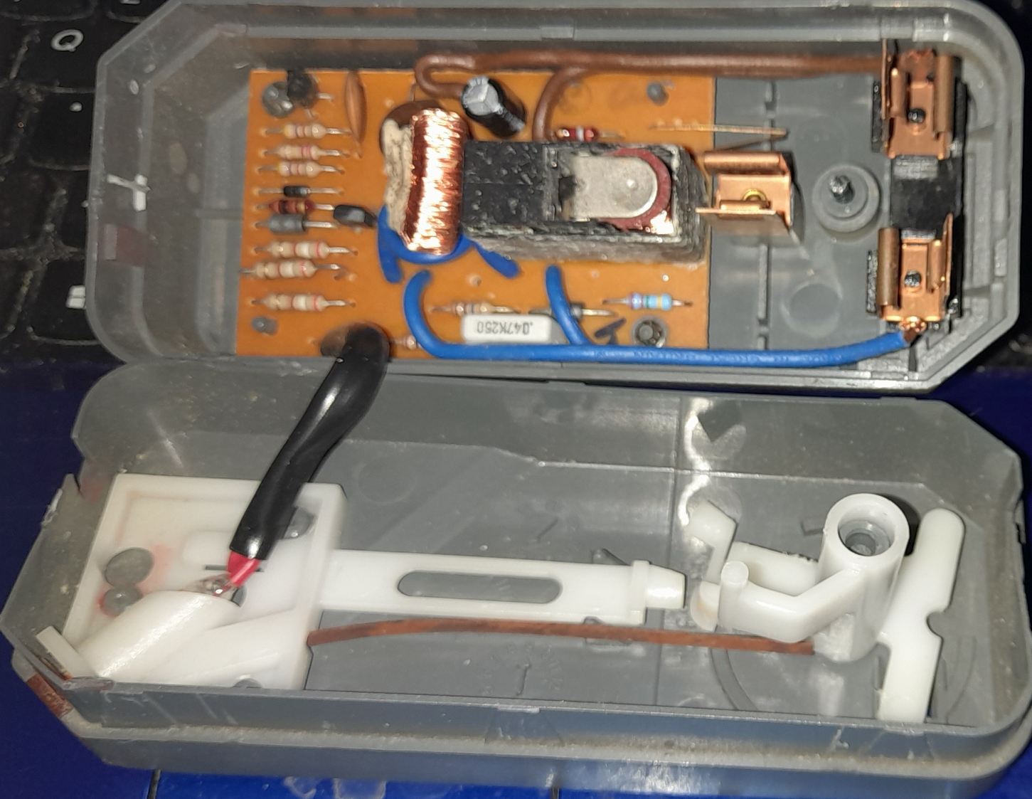

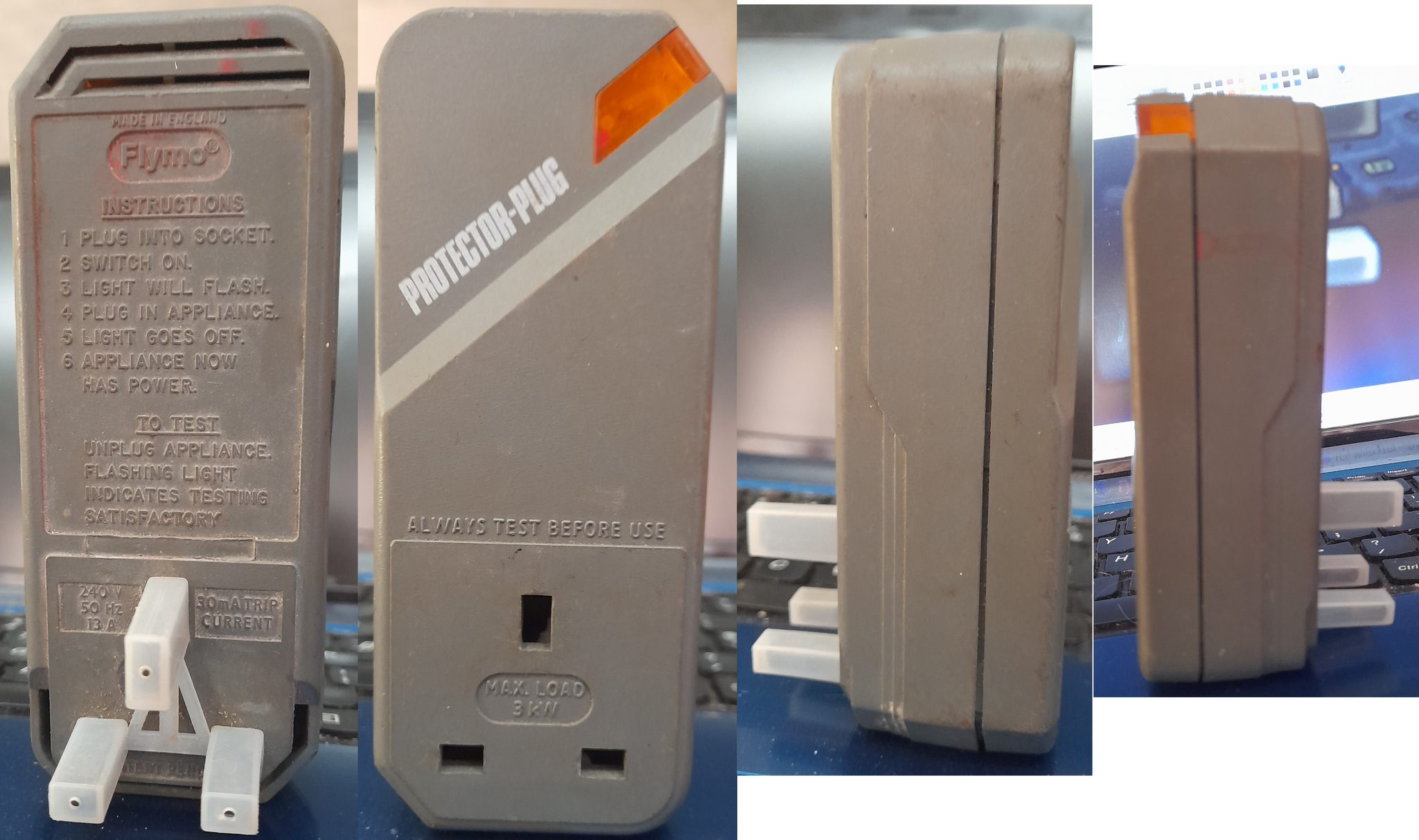

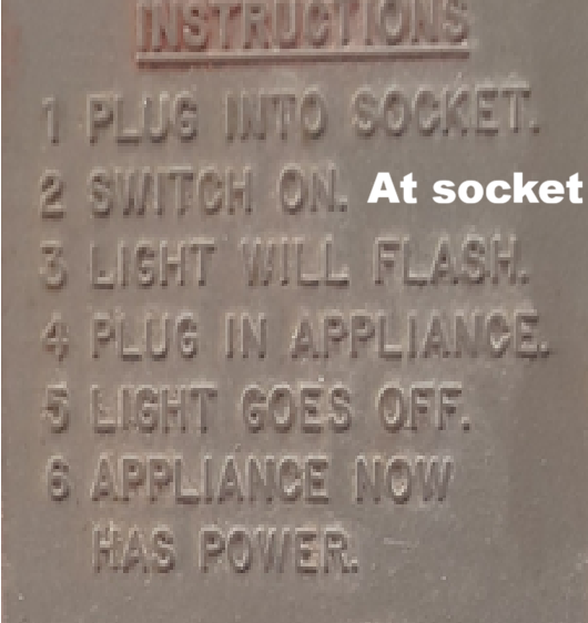

2. SWITCH ON. But can't find a switch, the light does flash, but 4. PLUG IN APPLIANCE. And the appliance is not powered, and the light continues to flash, I was going to test it, but one it is 30 mA so have no socket over 30 mA to test it with, two batteries flat in the tester, and three can't get it to turn on, so seems going in the bin.
Found when clearly out some old tools etc, and at first glance thought it was 10 mA, since 1990s all my sockets have been RCD protected, my dad it seems unlikely he would have used one, so likely father-in-law, the pin protector still on it, but seems it has seen some use.

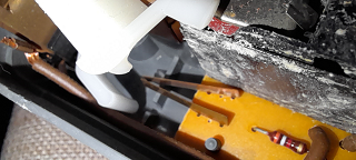

Think I may have found it. Noted shutters open, sharp rap closed them, but still no power from it. Google takes me to Wellco RCD which is very different, temped to break it open to see if a switch on the shutters.

I have no intension of reassembling it. 1787526400638.png The white bits seem to also push on the top of relay as well as the contacts, and I am not sure how they interconnect with each other.

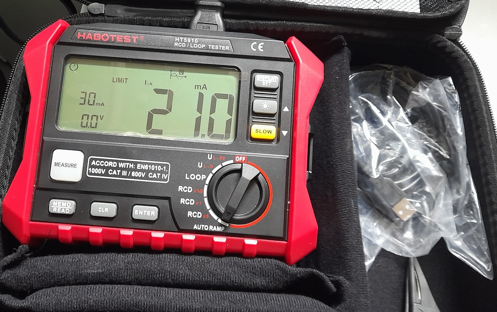

I can't test it as all sockets are RCD protected so likely the main ones would trip first.

The esy way to test it on an RCD socket is to get a plug and wire N on plug to both N & E on a test extenion type socket outlet and the L plug to L socket - sometimes known as and "up/down test socket, it simply means that both the N & E are derived from N only and the L is derived from L.
A sort of fake TNC-S into the tester socket if you think about it that way.
It`s the method I use to test my RCD testgear at home for my own personal calibration check because it will not trip the house RCDs only the RCD under test.

RCD tester ramp.jpg I simply turn the dial to one of the RCD test functions, plug it in and press the test button. But unfortunately found the batteries are flat, and I did not have a spare 8 x AA cells. (Nearly called them batteries)
