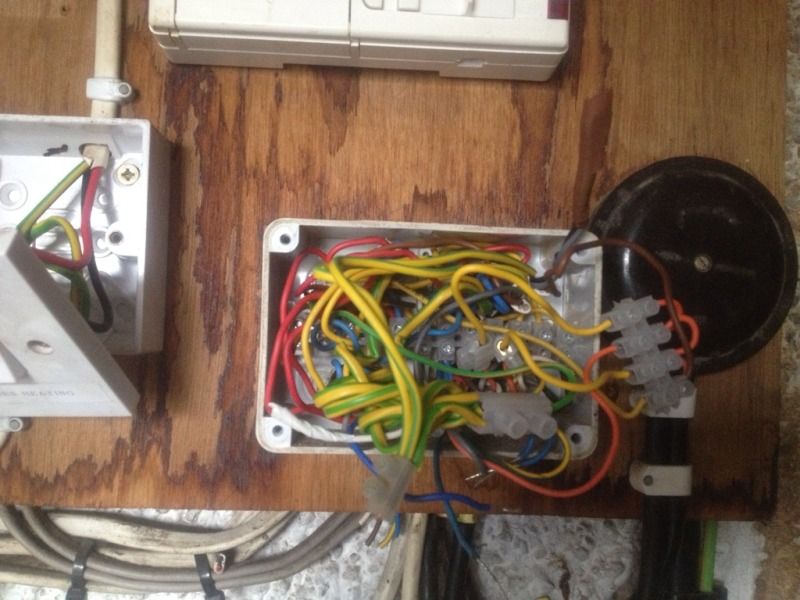

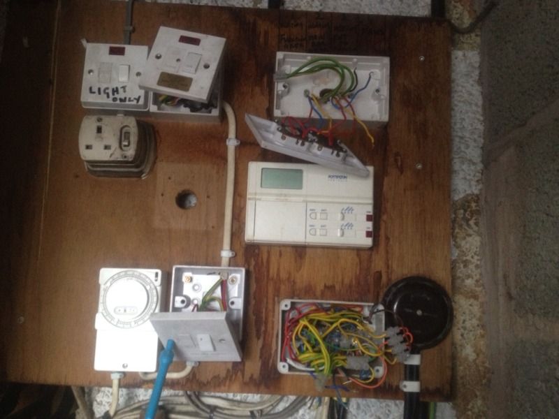

Just had to go check a pub boiler system was tripping the rcbo.
This is what I was faced with
How you suppose to do anything with that mess!? :roll:

It may look a bit daunting for a DIY job, but it should be easy once you've worked out what each cable does.
I take it you've taken plenty of photos before doing anything else.
Trace each cable back to each motorised valve etc, label them, test them. Do the same with the others until you've found the fault.
It may be worth installing a bigger box for the heating controls as that's an awful lot of cables to try and squeeze into one box.

Trouble was there was hardly any slack on most cables to have been able to pull them out and see where they were going/connected to what. But, luckily, the joint box to the right of the messy adaptable box had the connections to one of the valves. So I thought I'd start there - and luckily enough that was the one down to 0.02M! The pub landlord is apparently an 'electrician' but he was away, hence why I was doing it. The actual mess, we have left, he doesn't want it tidied up... :roll:
