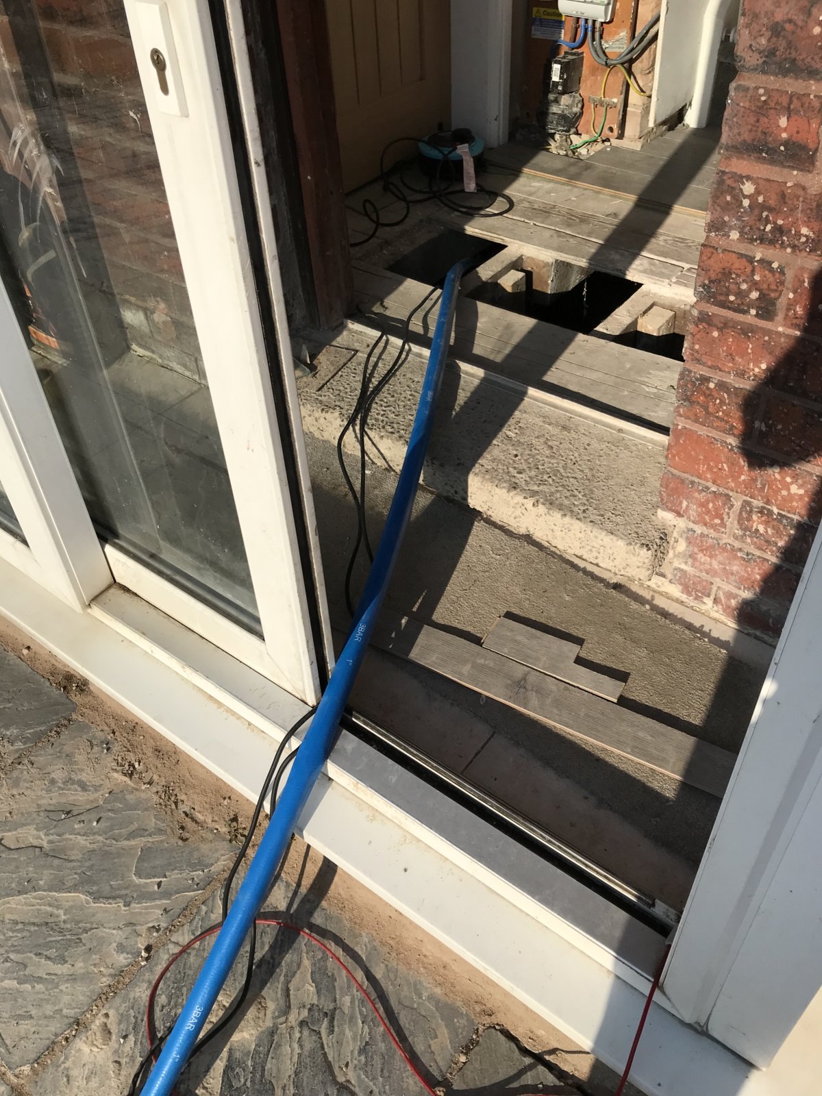

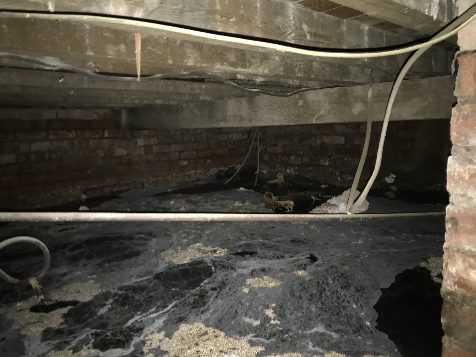

Hi all, sorry if this is in the wrong bit.
I’m pumping out some water from under the floor. It’s always down there but a recent blocked drain made it stink .

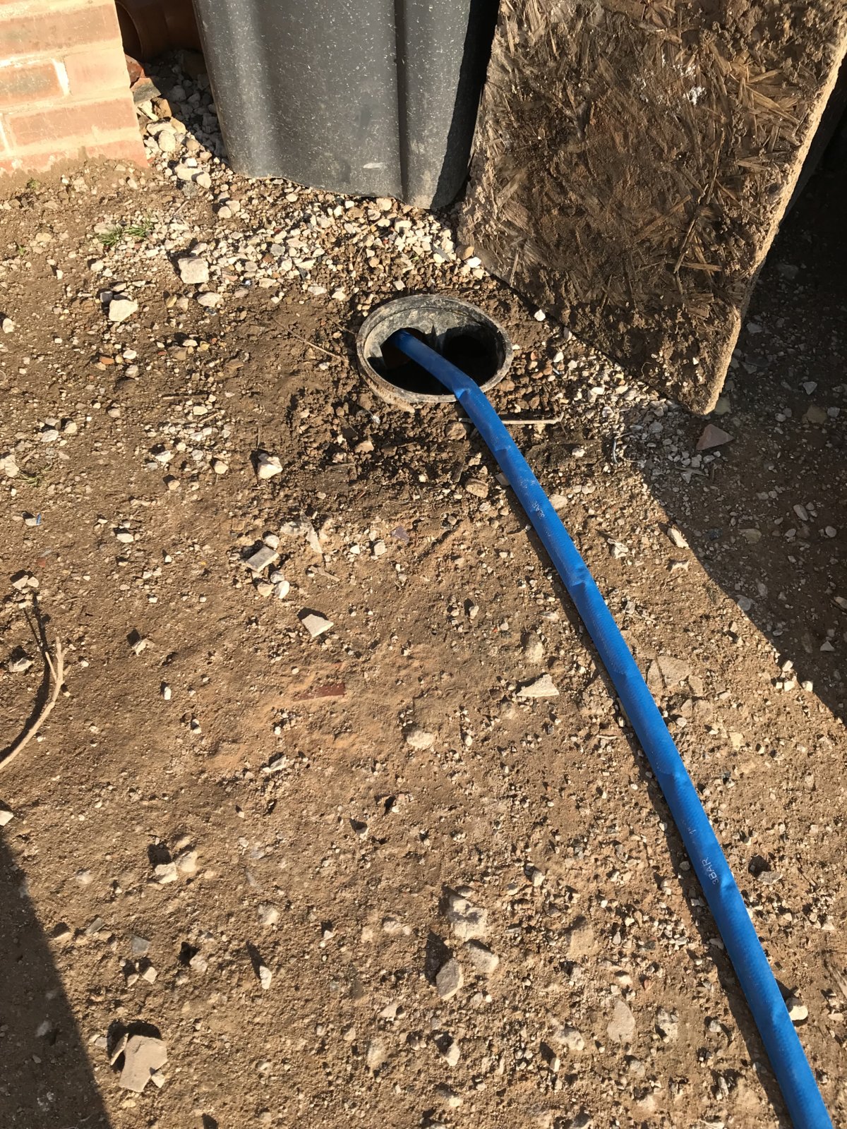

Currently the hose from the pump is coming out through the hallway then out the front door and into a drain.
The pump has an auto switch, I could leave it down there but where would the hose go and where would I pump too?

JohnHamer1977, good evening.
OK as I understand it??
A/. Your sub floor area has for some time been flooded / flooding?
B/. Recently there has been an influx of sewage?
Have you had the "original" water tested? how long has the water been "flooding" the sub floor area?
Ditto for the "newer" smelly water?

You should not have water under your floors , need investigating , unlikely to be ground water , more likely your drains are damaged allowing rainwater under .

Testing the water under the floor is a specialised process, there are a few companies that undertake this type of work, but? it aint cheap.
The test will determine if there is any Fecal material present and it also indicates if the water has been "processed" that is does it contain chlorine? indicating a leaky water main, a more costly test can tell if there is any soap in the water.
OK you do not want to go down the home Insurance route, do you have insurance from a firm like "Homeserve" Who offer Insurance cover for all white goods, Electrics, and underground drains and water feed pipework?
If it were me and I was acting as an Insurance Surveyor.
A/. Get the water tested, you then know what type of lead you are tracing ? water or Sewer?
B/. instruct a full CCTV survey all drains.
C/. Repair whatever was fractured.
D/. Pump out and sanitise the underfloor area, removing any contaminated material.
E/. install a polythene DPM over-layed with a layer of concrete.
As you can see all of the above is going to be costly? hence my original suggestion involve your Home Insurer?
