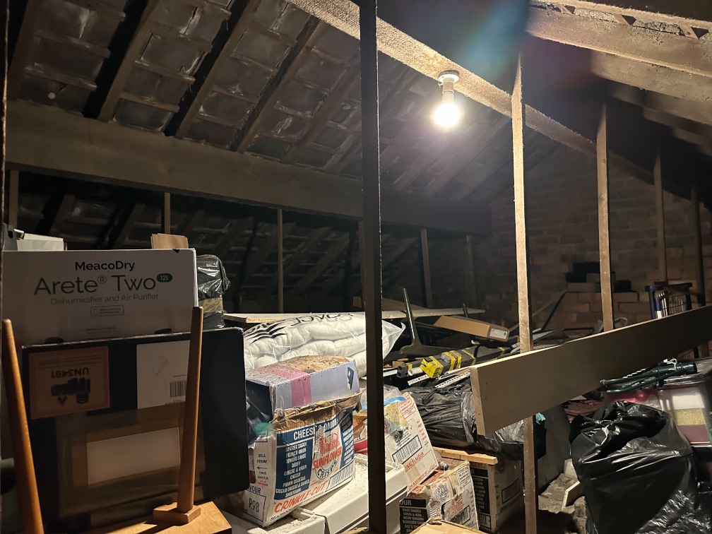

Hi all,
I have a Victorian three bed end terrace. The loft is currently being used to store junk on a few loosely placed old loft boards that will shortly be removed along with said junk. I'll then get it boarded out properly.

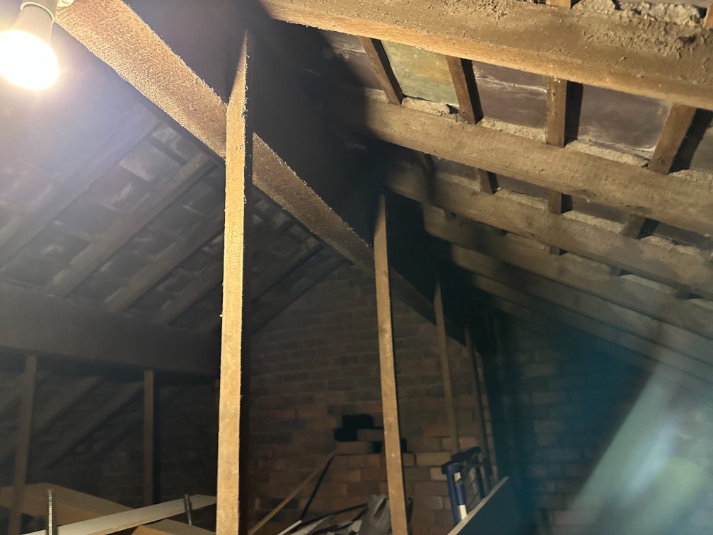

My question is, what are the vertical 2x1's running from the purlins to the joists for and what are they called? They're pretty flexible, so don't appear to be doing much and fixed in with a nail on either end. I can only assume that collectively they're for additional joist support to prevent bowing or something?
Only feedback I've had so far is that they might be something from the build stage and "could possibly be removed". However, the ceilings underneath are lovely and flat with no cracks so there is concern they wont stay that way if these are removed. There is a supporting wall running the width of the house through the middle.
Can these be removed?
They're 'hangers', they support the ceiling joists from the purlin, to help avoid sagging ceilings.

The joists are 2x3" spaced approx 21" apart. Ceilings are all plasterboard as the whole upstairs layout has been modified from the original at some point in the relatively recent past.

And the span from side wall to centre wall?
2x3's are a little bit slim for decent storage, over that span.
But at least it's plasterboard, rather than lath and plaster that could crack, or over boarding - where the joists are already supporting extra weight.
but purely out of interest, what kind of strengthening would generally be applied? Fixing secondary joists to the originals?
It depends on what you want to achieve. If you are planning on a loft conversion at any point, you could go the whole hog and get a floor suitable for that, installing separate larger joists, maybe even steels etc.
If it's only going to be a bit of light storage, you could consider sistering some larger joists to the existing, using cross joists, or as I've done, add some reinforcement to the existing, along these lines...

I won't be touching the hangers then, they are clearly integral to the structure. Regarding the storage aspect, at the moment everything is placed in the middle over the supporting wall. I wanted to expand the storage further out past the longer hangers towards the eaves. It sounds to me that I will need to have the joists reinforced to ensure no problems arise if I want to increase the floor space and access it regularly.

Tony's method is as good a monolithic 7 x 2 joist as you are going to get with out actually using a new joist, you will recall from your youtube video that the neutral axis is in the centre of the beam meaning no stresses and whilst your joint is not in the exact centre it is not far out and friction/compression stresses in that area will be small compared with the outer faces.
Running the calcs (hopefully with no mistakes) in theory with a 7 x 2 beam you can actually load the beams so the floor is imposing a load of 150kg/m2 (as opposed to just the ceiling load of 10kg/m2) and the deflection would be in line with what it is now i.e.<1mm but I would suggest improving the single nail fixing of the hangers
