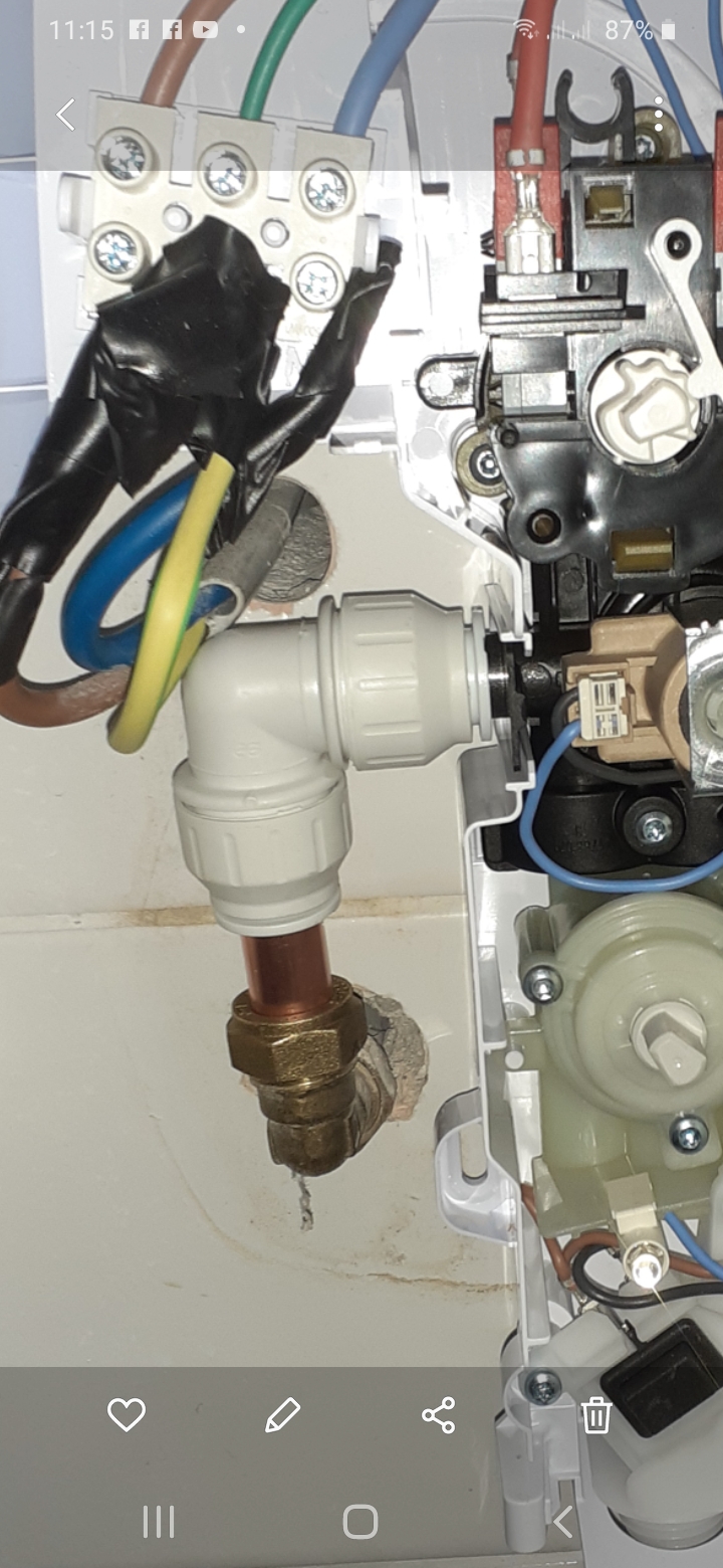

Do you slacken off push fit connector then push in copper or plastic pipe then tighten collar up and when undoing MUST you UNDO collars before pulling out?
Do people debure the copper pipe being inserted?

On that style of connector, it must be loose when inserting the pipe, then tightened afterwards.
To remove, loosen the collar, push the end plastic piece in towards the fitting, hold it in and pull the pipe out.
For copper, cut the pipe with one of these: https://www.toolstation.com/rothenberger-pipeslice-tube-cutter/p50182 so there is no burr.
Scratched or hacked copper will damage the seal in the fitting and it leak forever.

You don't need to slacken off the nut to insert but is easier to fit, you must loosen to demount, it won't otherwise and definitely yes to deburr.
As suggested though a compression fitting would probably be more suited to that kind of install IMO and use copper olives.

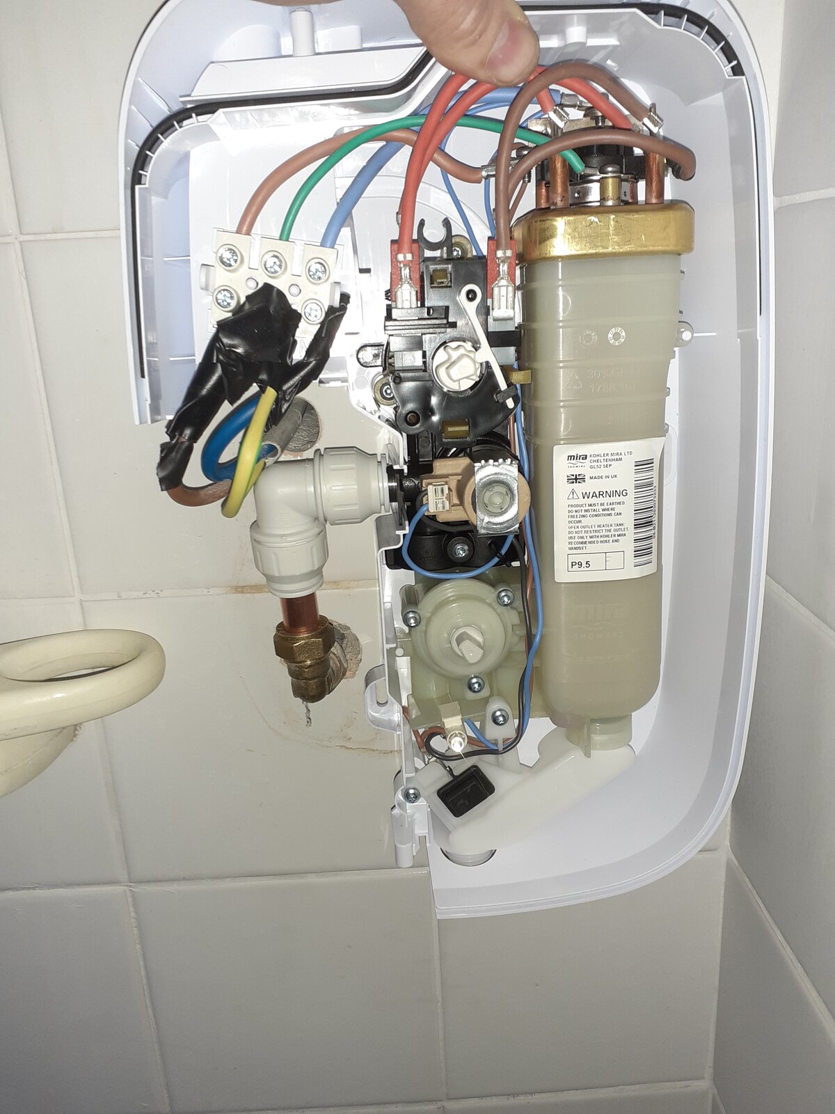

What's with the tape around the cables? Never a confidence booster, especially with the amount of power running through that.

Might buy one and keep an eye on push fit connector for ieakages (take top off and have a look) then change over if leaking.
It was confidence thing regarding doing the olive up to the right tightness that I was worried about so went for easy option. I guess do up olive check for leaks if a leak then do tighter until no leaks. That's what my neighbour did when it leaked (he'snot a plumber though). That's the way.
Copper olives if compression, and, check that the factory made electrical connections are tight as well as your own.
